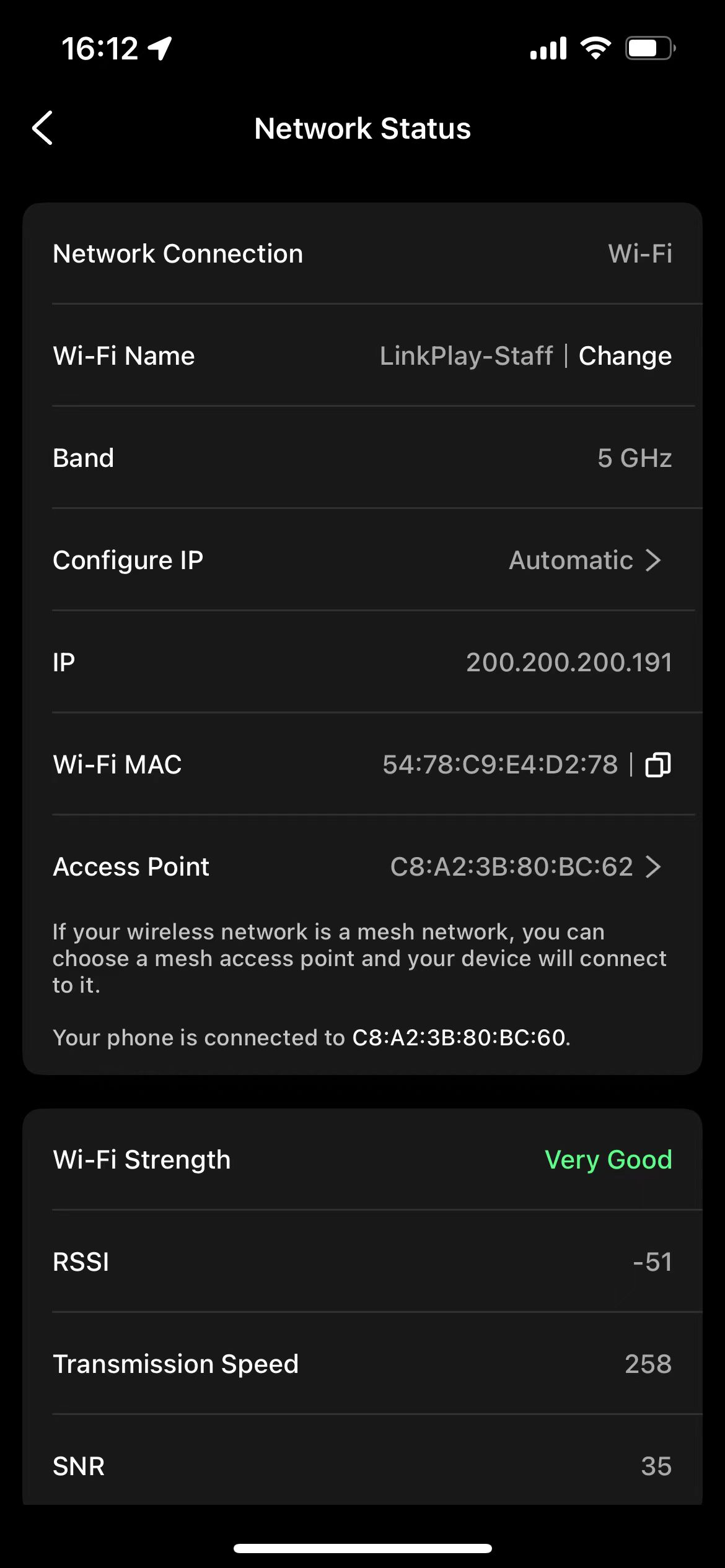

- Ensure your WiiM device has good Wi-Fi strength. To improve Wi-Fi strength, refer to How to Solve Weak Wi-Fi Signal Issues with Your WiiM Device.

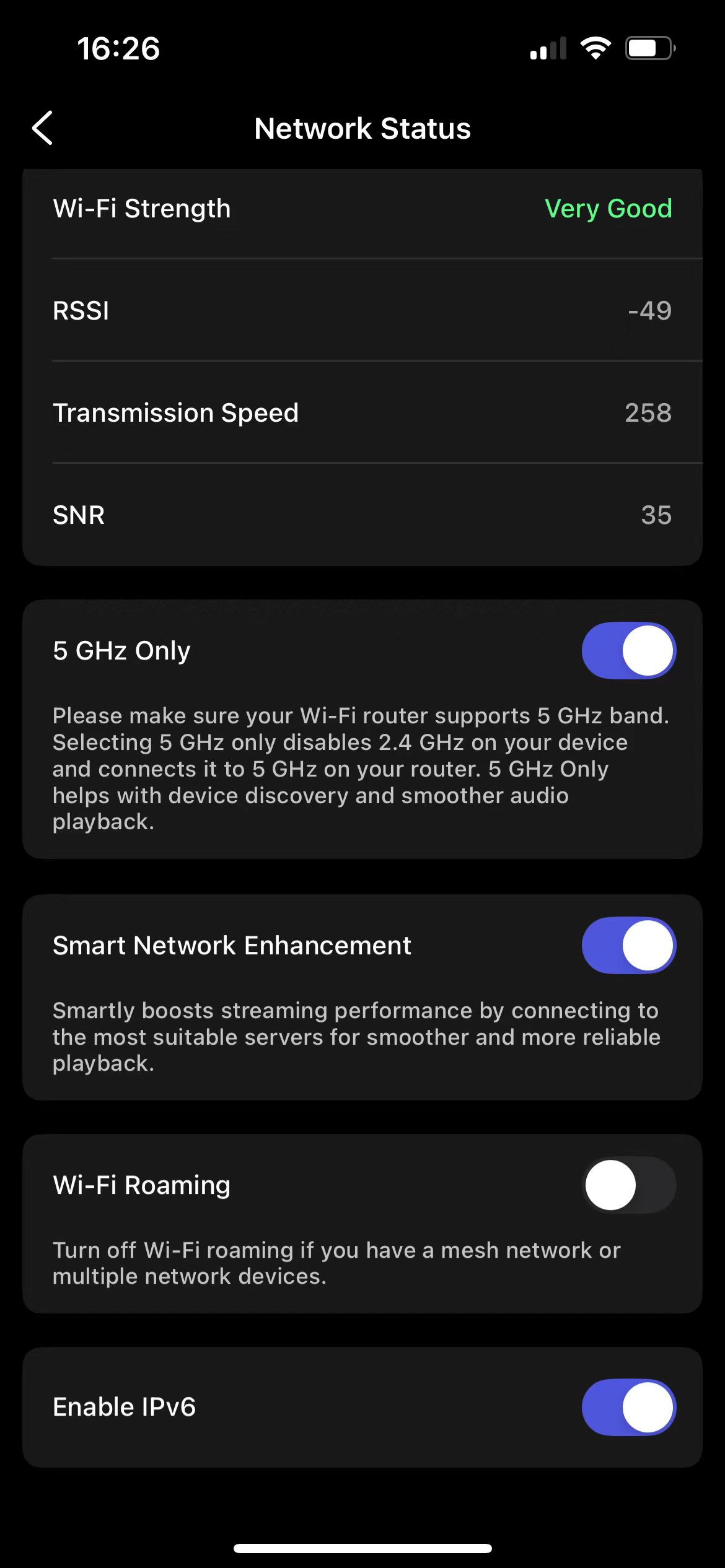

Try enabling Smart Network Enhancement and disabling Wi-Fi Roaming in the WiiM Home app.

Try disabling Wi-Fi Roaming on your WiiM device using the WiiM Home app.

- Try disabling Wi-Fi Roaming on your WiiM device using the WiiM Home app.

- Try disabling Wi-Fi Roaming for WiiM devices using the WiiM Home app.
