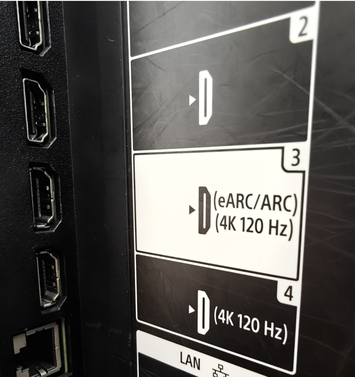

Make sure the cable is connected to the HDMI ARC/eARC port on your TV — it's usually labeled "ARC" or "eARC" next to the port.
For example, in the image below, Port 3 is labeled "eARC/ARC" — this is the correct port to use.
