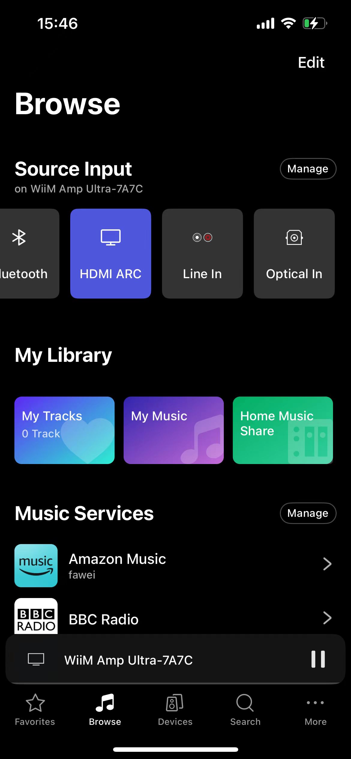

Step 4. Check Your WiiM Device's Input Source
  1. Open the WiiM Home app.
  2. Go to the Browse tab.
  3. Make sure that HDMI ARC is selected as the source input for your WiiM device.
