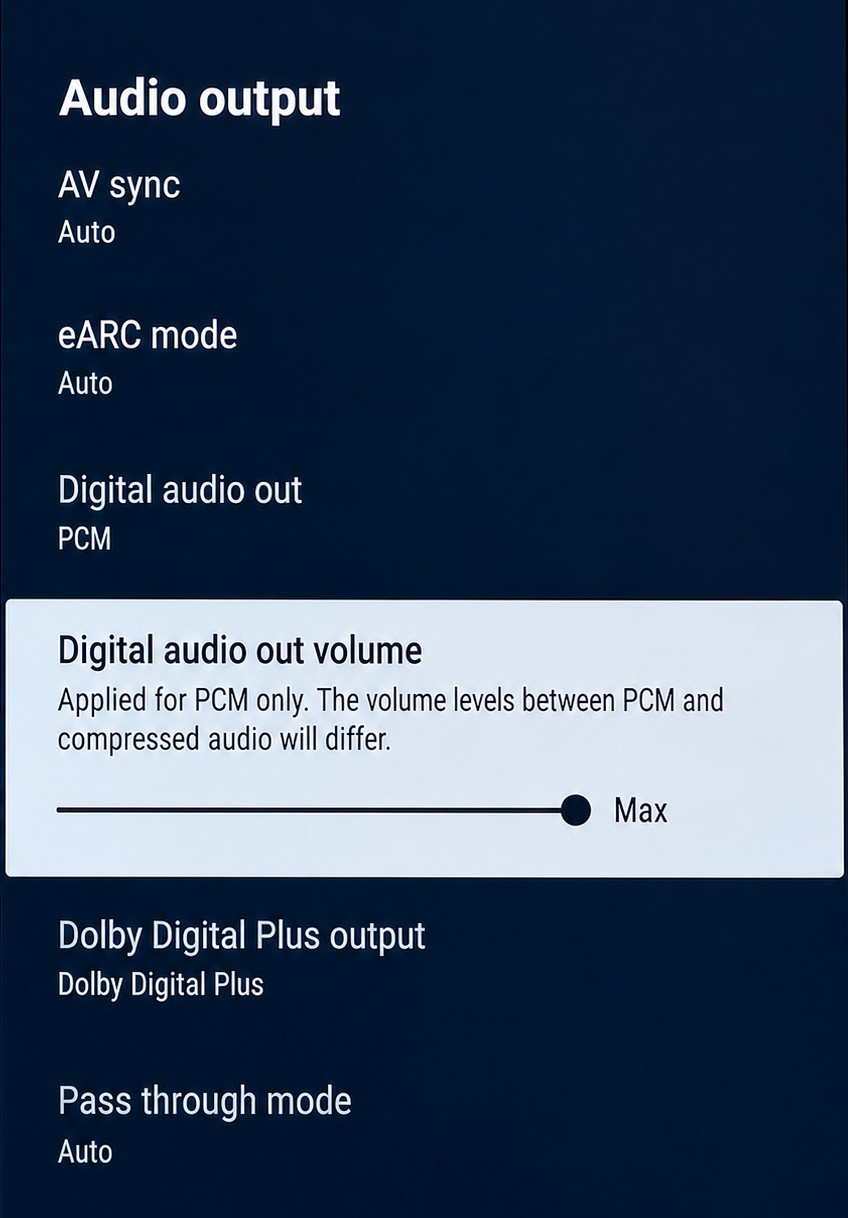

Sony
  1. Open the Settings menu using your remote control.
  2. Navigate to Display & Sound > Audio output > Digital audio out.
  3. Select PCM as the output format.
Note: Make sure Digital Audio Out Volume is set to Max. Otherwise, the connected WiiM device may output very low or no sound.
