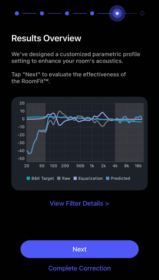

| 7. Start tuning | Tap Start Tuning to begin the acoustic measurement, then evaluate the results. You can also review the RoomFit™ result using the curves below:

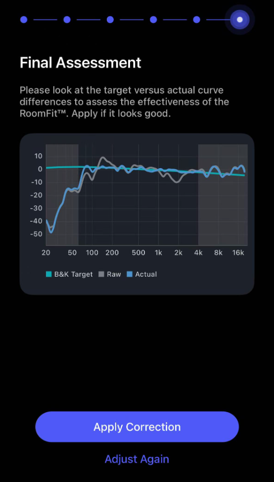

| 8. Evaluate results. | Review the actual RoomFit™ result using the curves below:
If the Actual curve closely matches the Target curve within the adjustable range, the RoomFit™ result is effective. Tap Apply Correction to proceed.If there are large differences, tap Adjust Again to re-run RoomFit™. |
