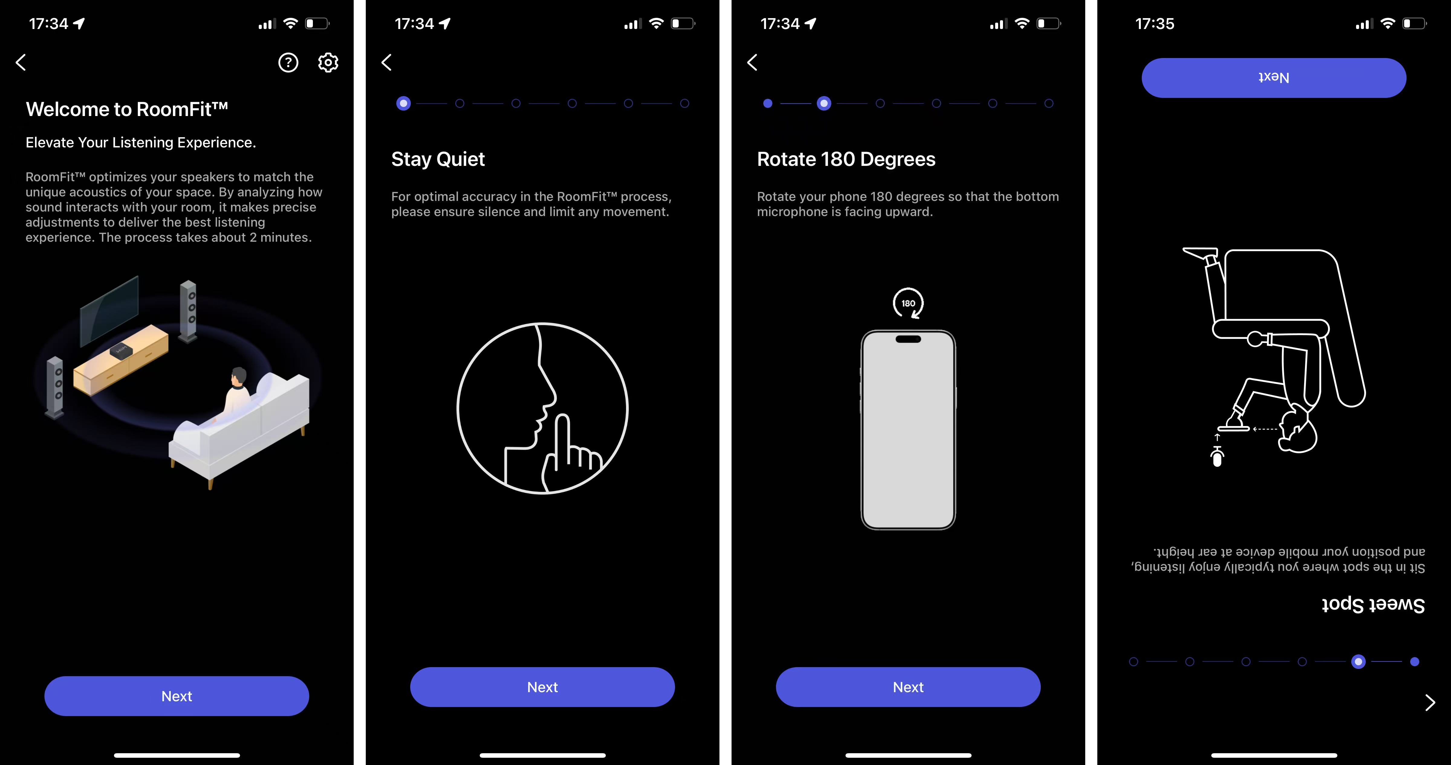

Guidelines During RoomFit™ Calibration
- ALWAYS remove the protective case from your phone.
- ALWAYS hold the phone as far away from your body as possible.
- ALWAYS point the microphone towards the speaker you are currently measuring.
- ALWAYS place the microphone at ear level (if you sit while listening, use the height of your ears when seated).
- Microphone Placement: Ensure the microphone, the listener's ears, and the speaker's acoustic center are approximately at the same height.

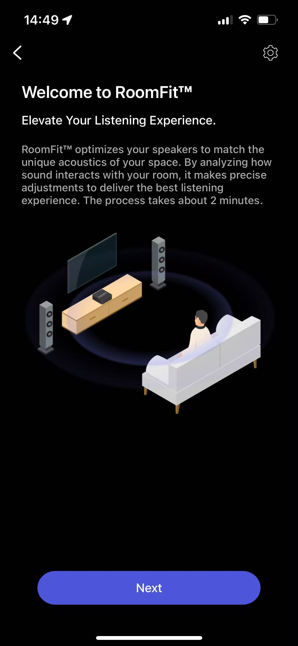

- Open the WiiM Home app.
- Navigate to the Devices tab and tap the Device Settingsiconfor your WiiM Sound or WiiM Sound Lite.
- Select RoomFit™.
- Tap Next to start the RoomFit™ process.
- Tap Play Sound to perform an audio check.
- Tap Start Tuning to begin the acoustic measurement, then evaluate the results.

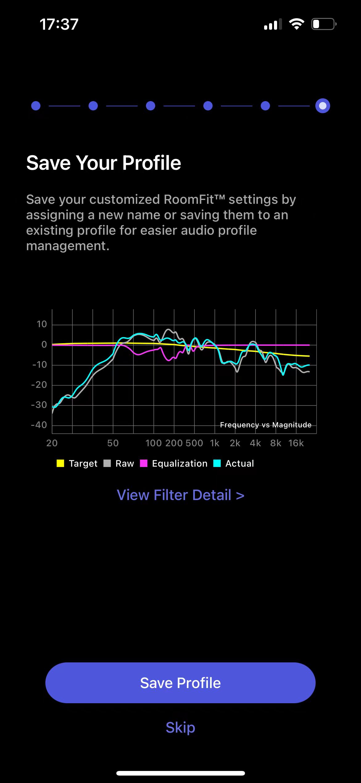

You can also review the RoomFit™ result from the four curves below:
- Yellow curve (Target): The desired frequency response that RoomFit™ aims to achieve.
- Gray curve (Raw): The measured frequency response of your speakers and room before RoomFit™.
- Pink curve (Equalization): The EQ adjustments that RoomFit™ makes to correct the variations.
- Cyan curve (Actual): The actual frequency response after RoomFit™ correction is applied.

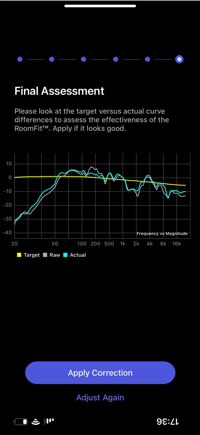

- When the Final Assessment page appears, review the actual RoomFit™ result from the curves below:
If the cyan curve closely matches the yellow curve within the adjustable range, the RoomFit™ result is effective and tap Apply Correction to proceed. If there are large differences, tap Adjust Again to re-run RoomFit™.
- Tap Save Profile to save the RoomFit™ results as a custom profile. Alternatively, tap Skip to save into the Auto profile.

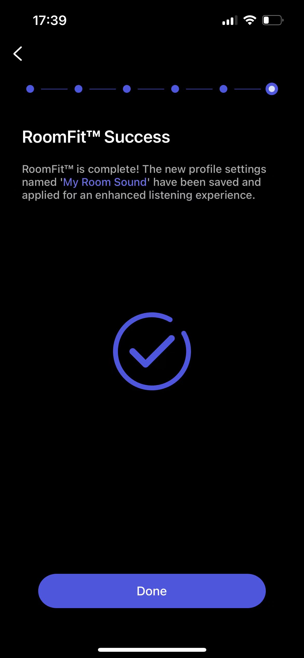

- Tap Done to finish the RoomFit™ process.
Once the RoomFit™ process is completed, the saved profile will be automatically applied to all input sources, so you do not need to perform it separately for each one.
