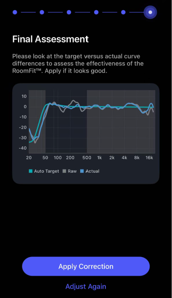

Tap Start Tuning to begin the acoustic measurement, then review the RoomFit™ result from the curves below:
| 7. Evaluate results. |
Evaluate the actual RoomFit™ result from the curves below:
If the Actual curve closely matches the Target curve within the correction range, the RoomFit™ result is effective. Tap Apply Correction to proceed. If there are large differences, tap Adjust Again to re-run RoomFit™. |
