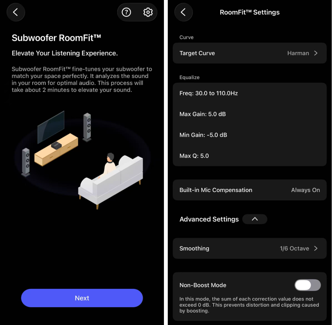

3. Configure parameters.
Tap the icon to open RoomFit™ Settings.
Adjust the following settings to match your preferences:
  • Target Curve: Defines the target frequency response that your WiiM Sub Pro aims to match after Subwoofer RoomFit™. Choose from B&K, Harman, Flat, and Subwoofer before running Subwoofer RoomFit™.
  • Smoothing: Reduces minor fluctuations in the frequency response to help focus on overall trends and prevent overcompensation. Choose a value from the following ones:
    • 1/3 Octave: Strong smoothing. Shows overall trends, hides fine details.
    • 1/6 Octave: Balanced smoothing. Good mix of clarity and detail.
    • 1/12 Octave: Light smoothing. Reveals more detail but may look uneven.
    • Variable: Automatically adjusts smoothing depending on frequency. Light smoothing on bass for detail, heavier on treble for readability.
    • Psychoacoustic: Smoothing according to how humans hear. Hides the tiny acoustic bumps that microphones measure but your ears can't actually hear.
    • ERB: Smoothing based on advanced "human hearing" mode. It provides more detail than Psychoacoustic while still considering human perception.
  • Non-Boost Mode: This setting ensures that the sum of all correction values does not exceed 0 dB, preventing distortion and clipping caused by excessive boosting.
Note: Other settings are fixed and cannot be modified. For details about what these settings mean, see Introducing RoomFit™ Settings.

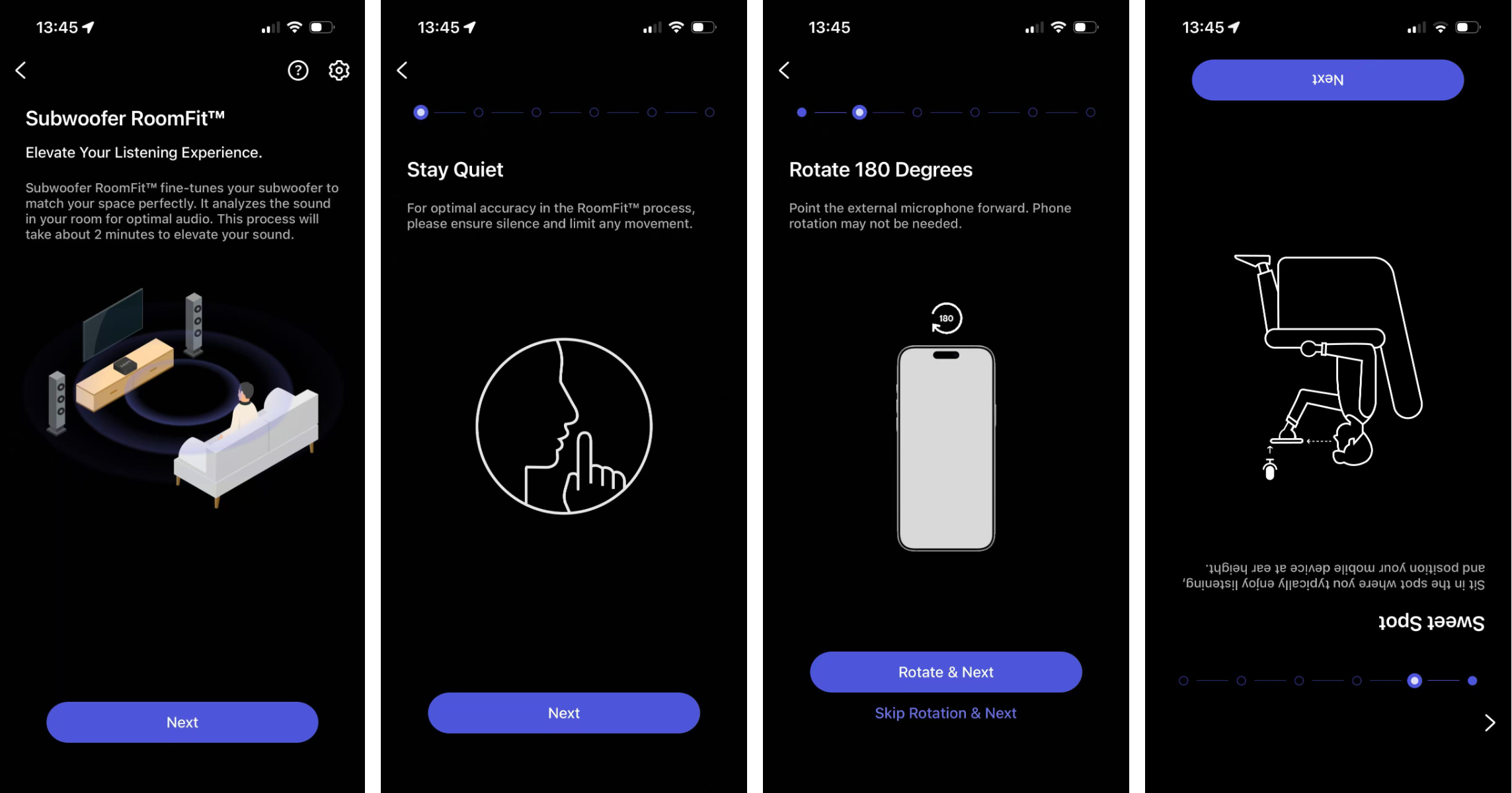

4. Start RoomFit™ process.
Tap Next to start the RoomFit™ process.
Tip: Follow the prompt to rotate your phone 180°, so the bottom microphone faces the speakers for accurate measurement.

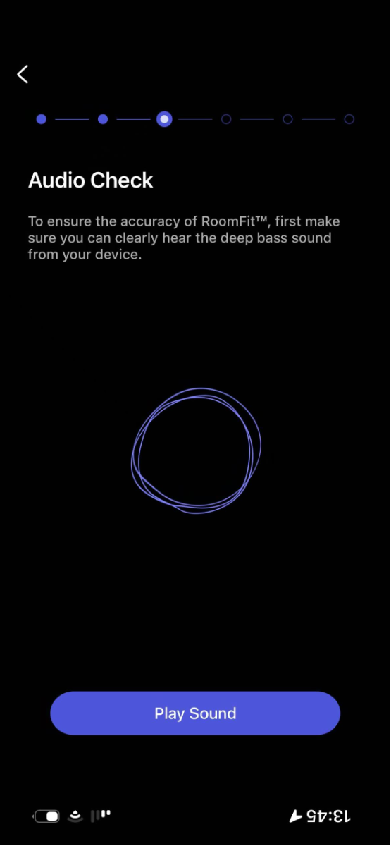

5. Audio check.
Tap Play Sound to perform an audio check.

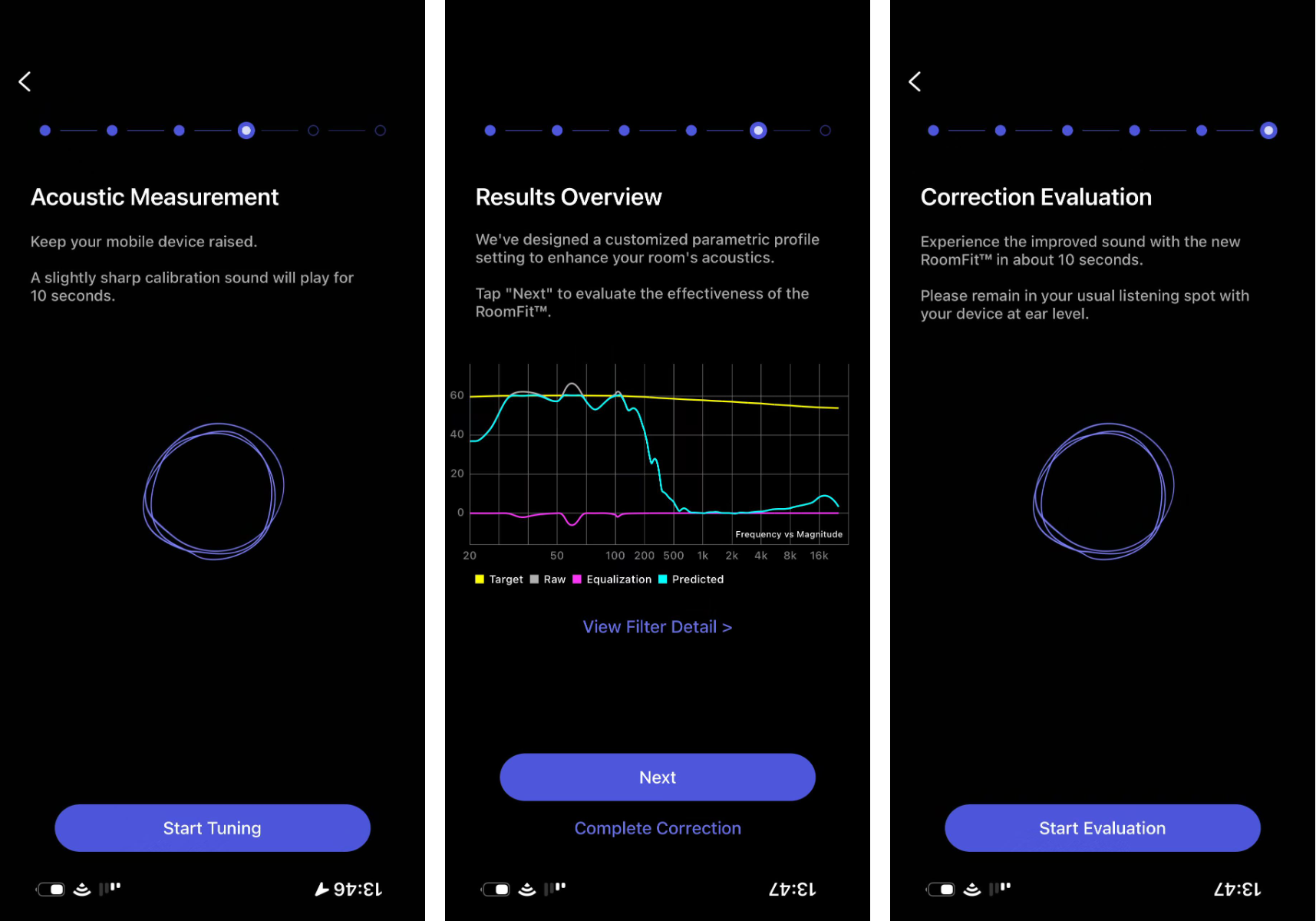

6. Start tuning.

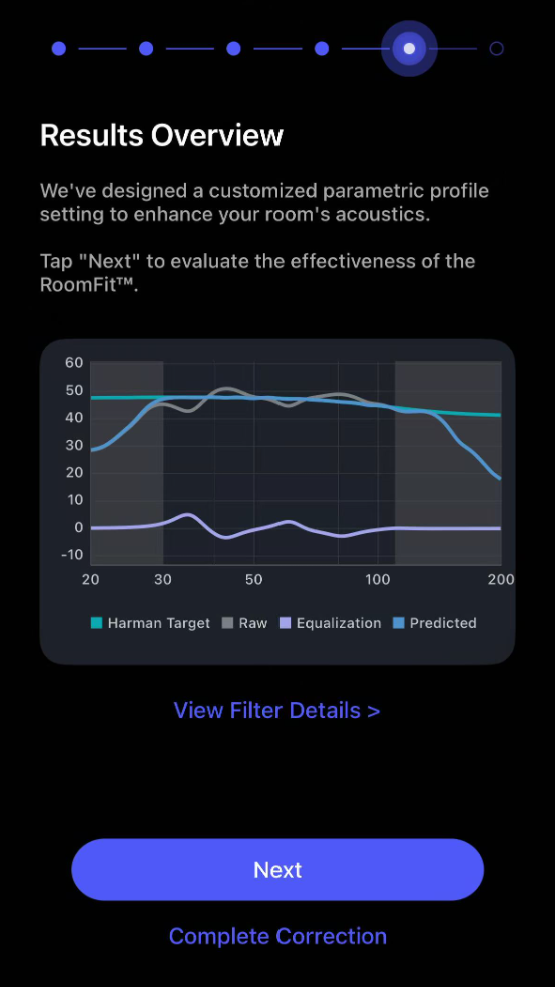

Tap Start Tuning to begin the acoustic measurement, then evaluate the results from the curves below:
  • Target: The desired frequency response that RoomFit™ aims to achieve.
  • Raw: The measured frequency response of your speakers and room before RoomFit™.
  • Equalization: The frequency-response correction applied by RoomFit™.
  • Predicted: The predicted frequency response after RoomFit™ correction is applied.

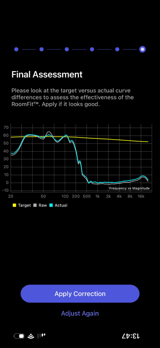

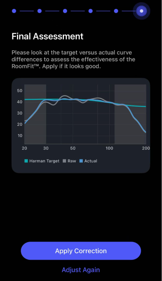

7. Evaluate results.
Review the actual RoomFit™ result from the curves below:
  • Actual: The actual frequency response after RoomFit™ correction is applied.
If the Actual curve closely matches the Target curve within the adjustable range, the RoomFit™ result is effective. Tap Apply Correction to proceed.
If there are large differences, tap Adjust Again to re-run RoomFit™.

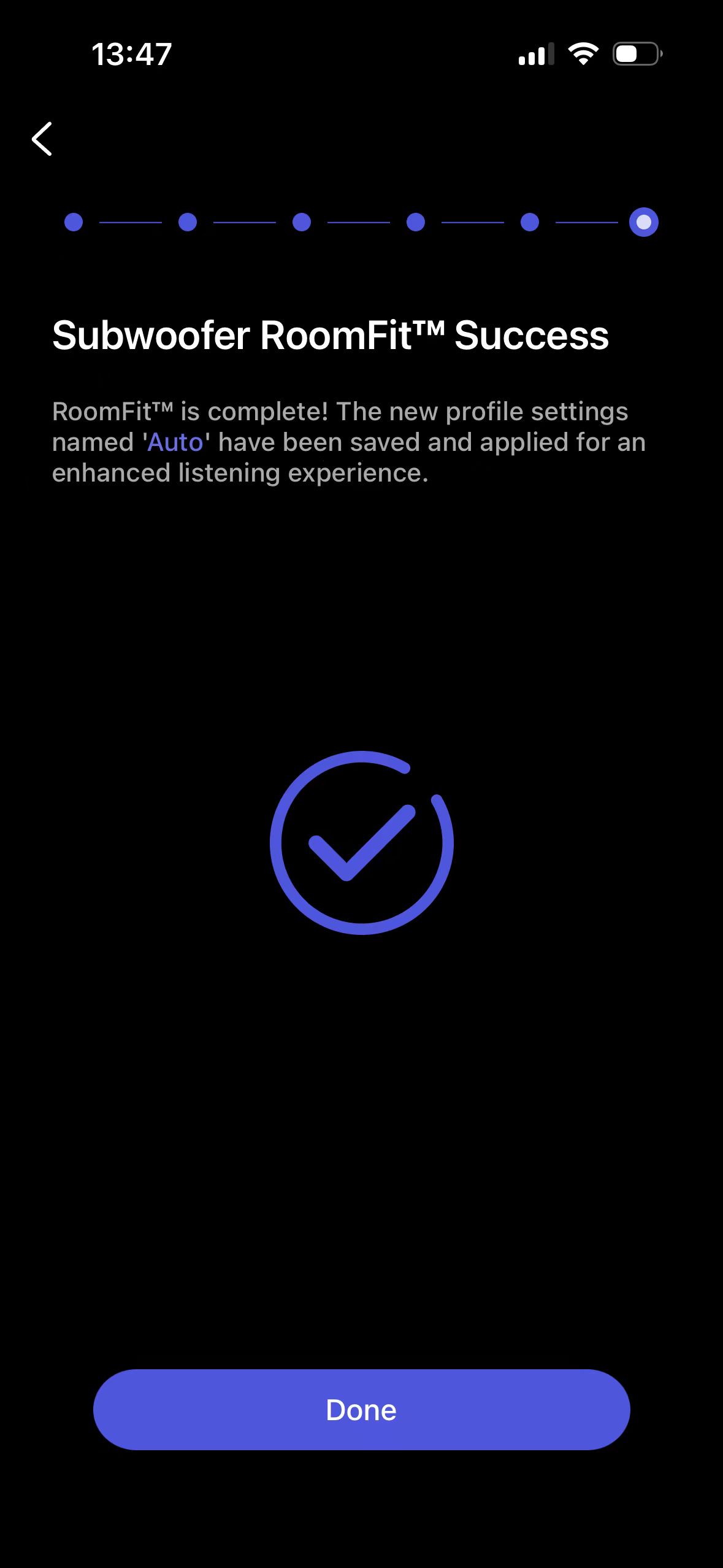

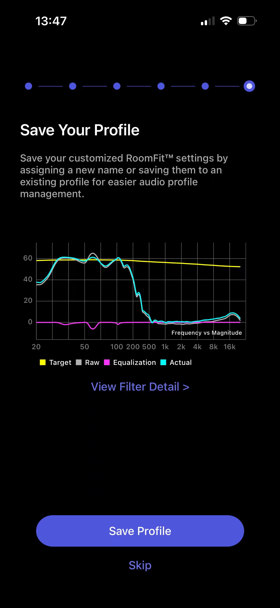

8. Save results.
Tap Save Profile to save the RoomFit™ results as a custom profile. Alternatively, tap Skip to save into the Auto profile.
9. Finish.
Tap Done to finish the RoomFit™ process.
