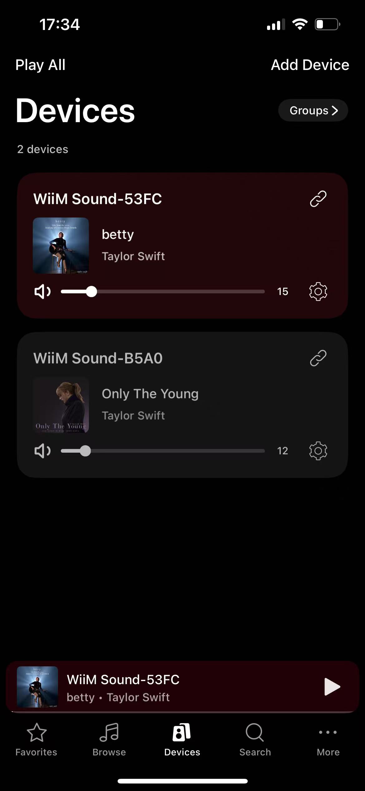

  2. Go to the Devices tab, and tap the Chain Link iconin the top-right corner of one speaker.

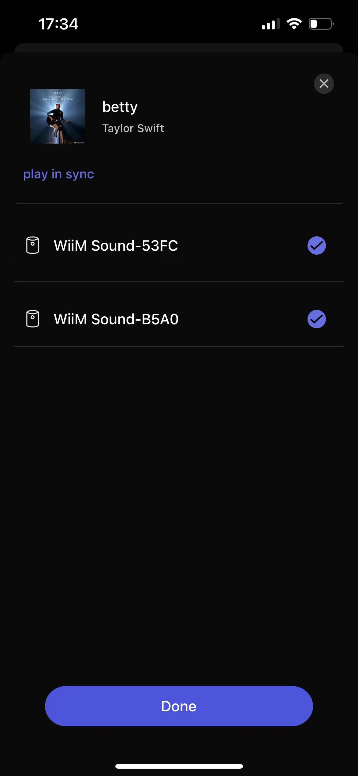

  3. Choose the other speaker from the list and tap Done.

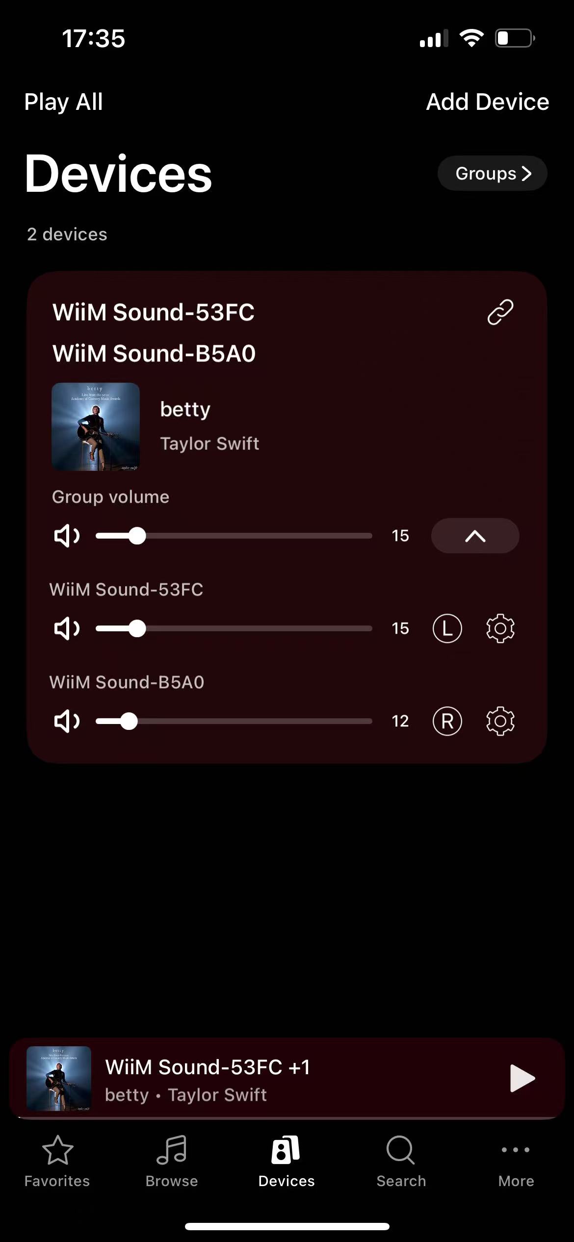

  4. Set one speaker as the left channeland the other speaker as the right channel
  5. Use the Group volume bar to adjust the volume of both speakers simultaneously.
