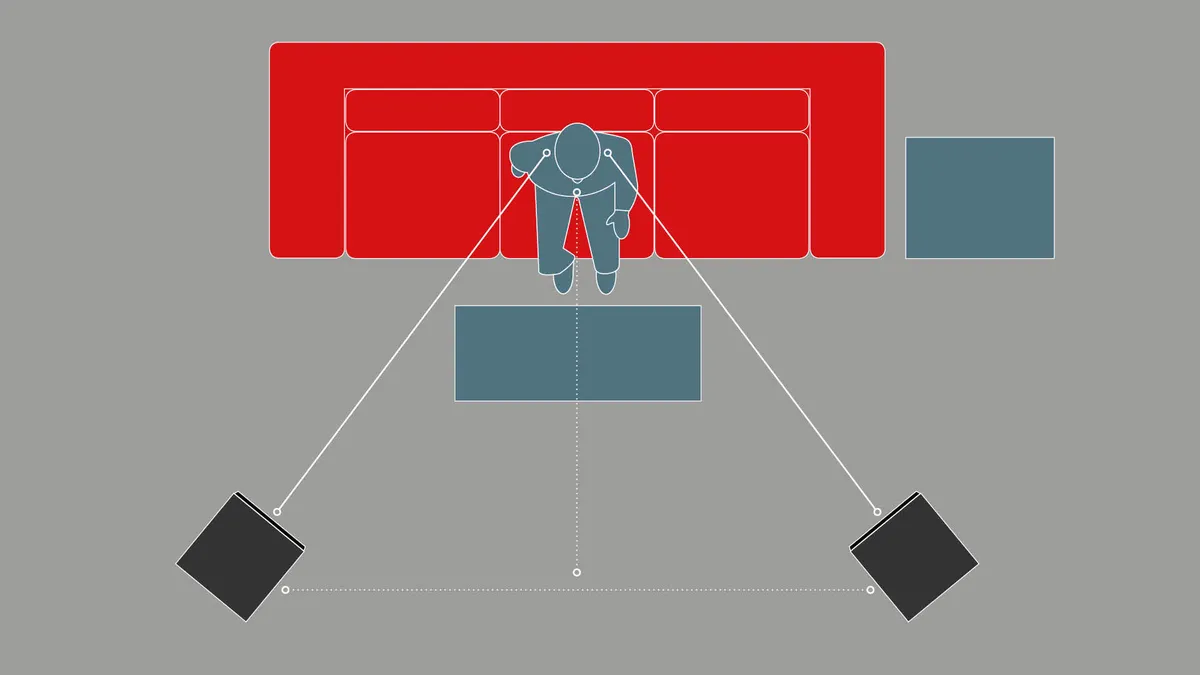

The above diagram illustrates an example of ideal speaker placement in a typical listening environment, based on the speaker placement guidelines provided below.
Speaker Placement Guidelines
1. Create an Equilateral Triangle
Arrange the two speakers and your listening position so that they form an equilateral triangle. The distance between the speakers should be equal to the distance from each speaker to your listening spot, usually 6 to 10 feet (1.8 to 3 meters).
2. Speaker Height
Place speakers at ear level when you're sitting in your listening spot. This ensures that the high frequencies reach you at the right angle.
3. Speaker Angle
Angle the speakers slightly inward, so they face toward your listening position. This can help improve stereo imaging and sound focus.
4. Distance from Walls
Keep the speakers at least a few inches away from the walls and avoid placing them directly in corners to reduce distortion and enhance sound clarity.
5. Symmetrical Speaker Placement
Ensure both speakers are positioned symmetrically in the room for balanced sound.
