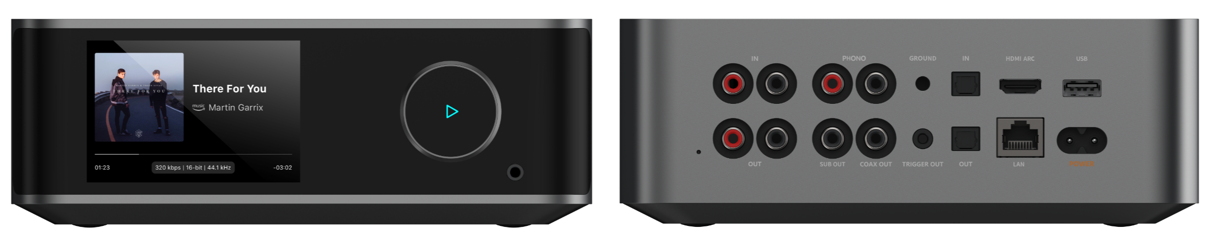

2. Connect the WiiM Ultra's Audio Output
The WiiM Ultra features six dedicated audio output ports, allowing you to output audio to various external devices. You can use any of these ports depending on your setup and preference.

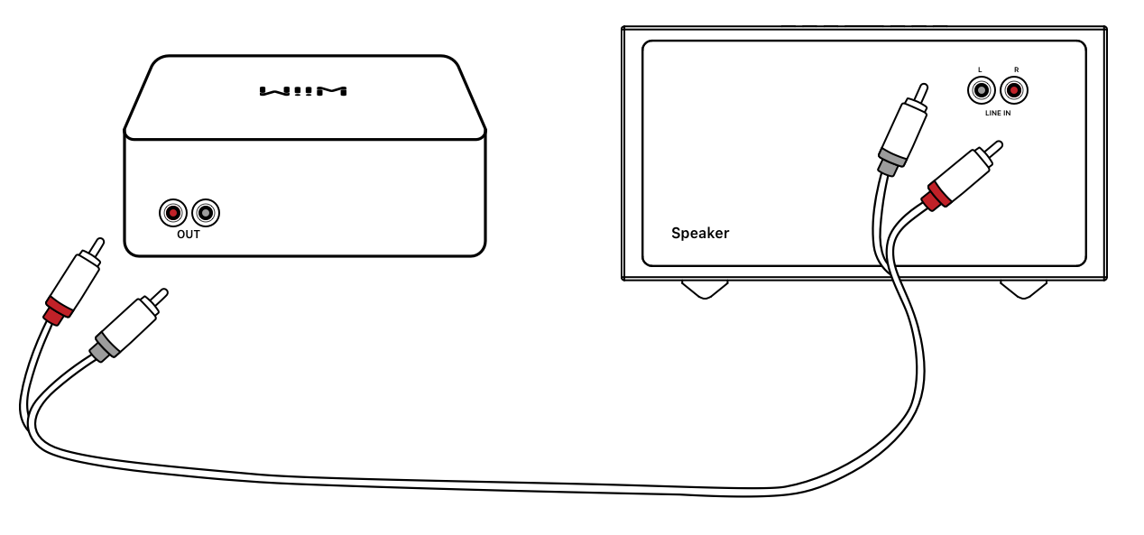

Line Out
The Line Out port is typically used to connect to the external audio equipment, e.g., powered speakers, amplifiers, or AV receivers to output high-quality analog audio playback.

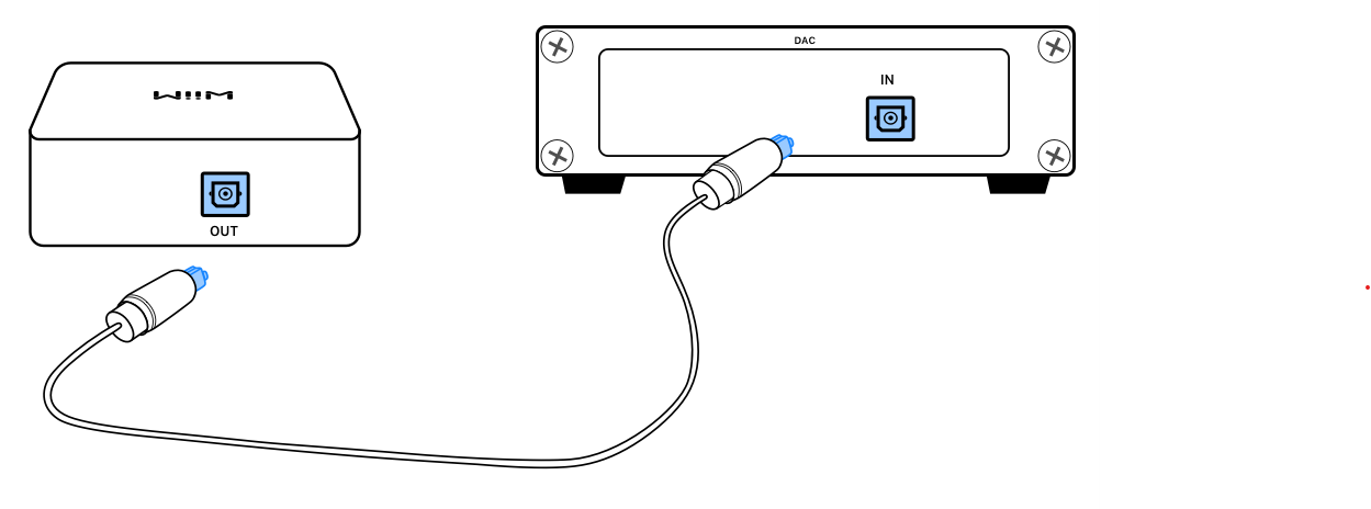

Optical Out
The Optical Out port is typically used to connect to the external device, e.g., soundbars, DACs, or AV receivers, to output digital audio playback.

3. Connect the WiiM Ultra's Audio Input (Optional)
The WiiM Ultra features four distinct audio input ports: Line In, Optical In, HDMI ARC, and Phono In. These allow you to connect external audio sources (e.g., CD players, TVs, PCs, or turntables) for high-quality playback. For detailed instructions, see How To Use Audio Input Ports of the WiiM Ultra.
