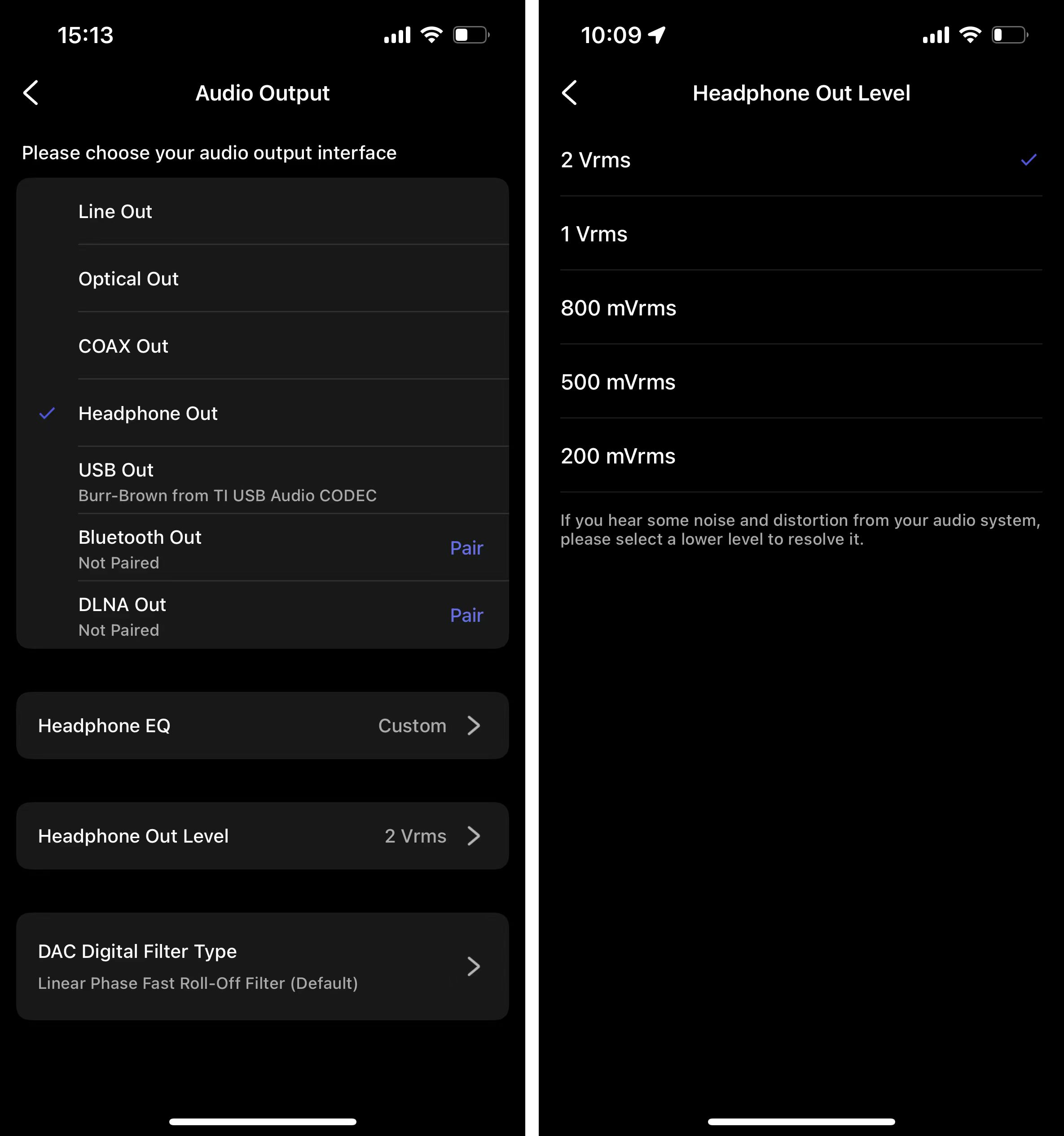

Set Your WiiM Ultra's Output to Headphone
Option 1: From Now Playing in WiiM Home App
- Go to Now Playing in the WiiM Home app.
- Tap the
icon at the bottom, then select Headphone Out from the list.

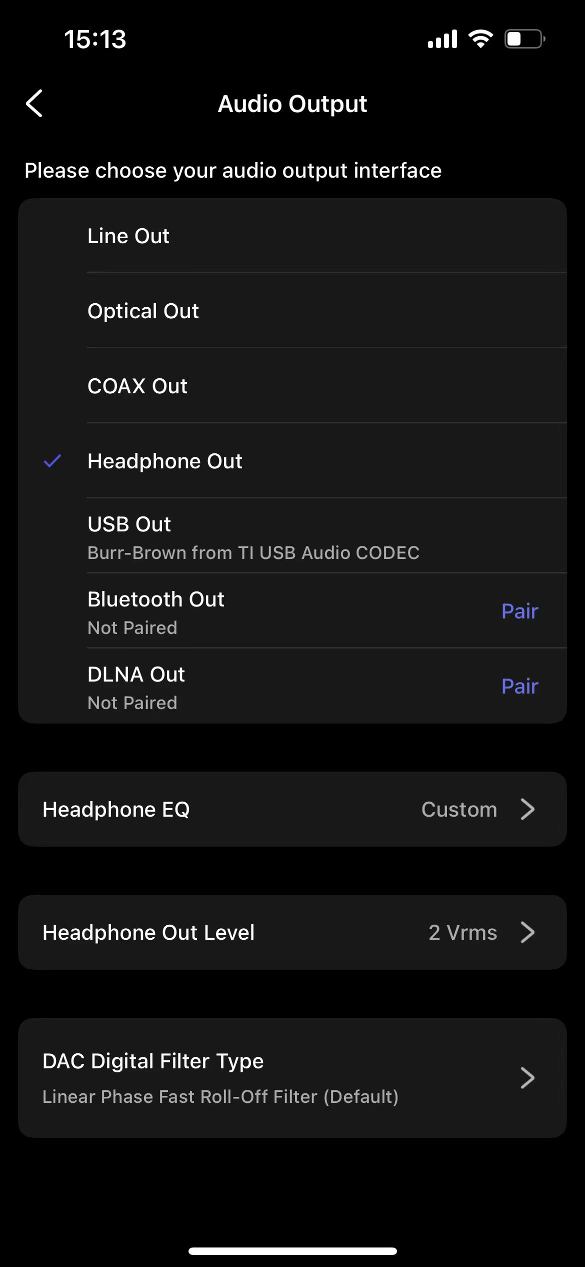

Option 2: From Device Settings in WiiM Home App
- Open the WiiM Home app on your mobile device.
Go to the Devices tab and tap the Device Settings
icon.Select Audio Output and choose Headphone Out from the list.
Option 3: From WiiM Ultra's Screen
Tap Output on your WiiM Ultra's screen, then choose Headphone.

Adjust Headphone Out Level
Additionally, you can adjust the headphone output level in the WiiM Home app under Audio Output settings to optimize sound quality
- Increase the level if the headphone volume is too low.
- Decrease the level if you hear noise or distortion.

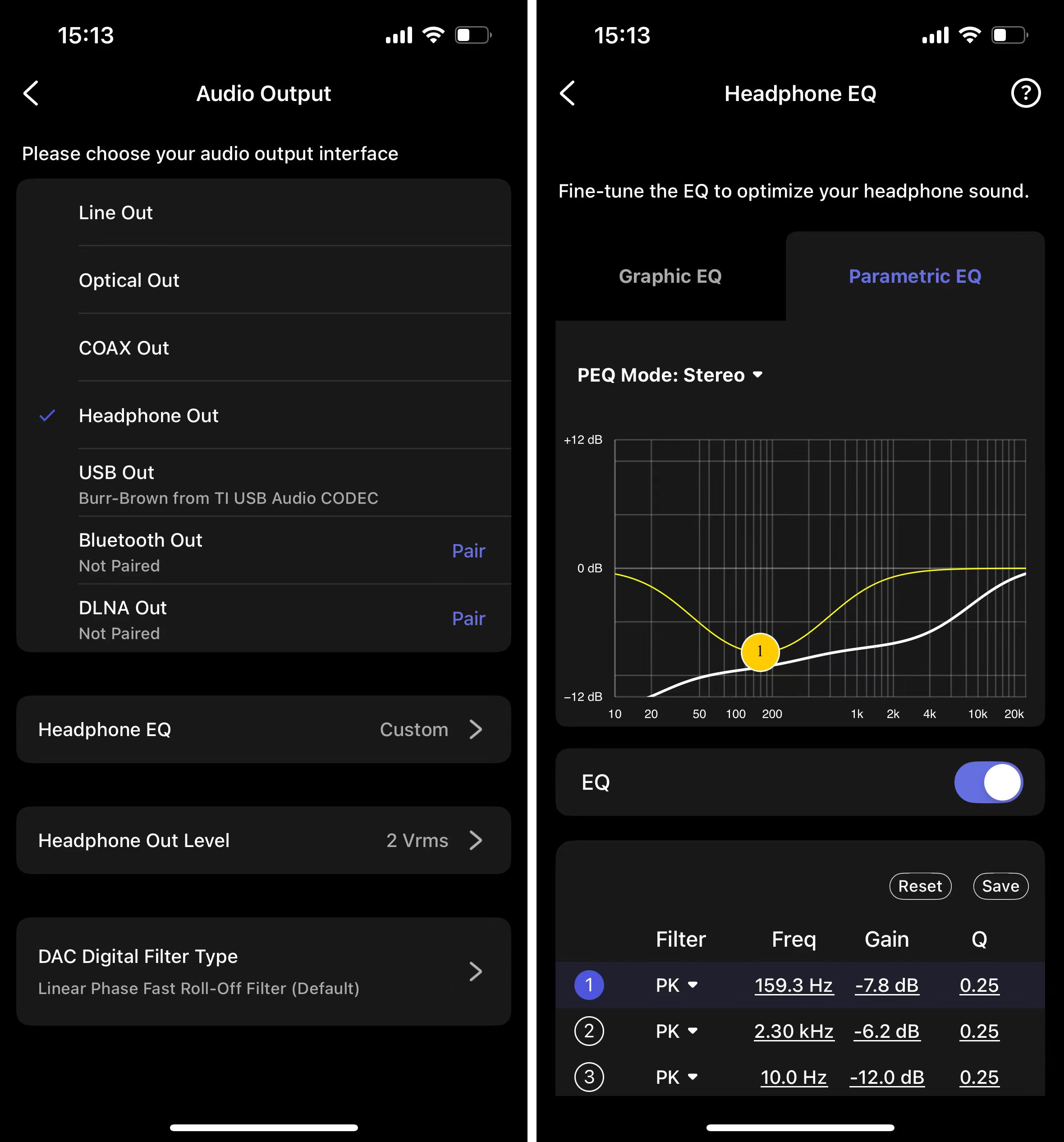

Adjust Headphone EQ
You can use the Headphone EQ setting to fine-tune sound specifically for headphone listening. It supports both Graphic EQ (GEQ) and Parametric EQ (PEQ).
The Headphone EQ interface and controls are similar to Input EQ. For instructions on using GEQ and PEQ, please refer to How to Use Per-Source EQ: A Comprehensive Guide.
