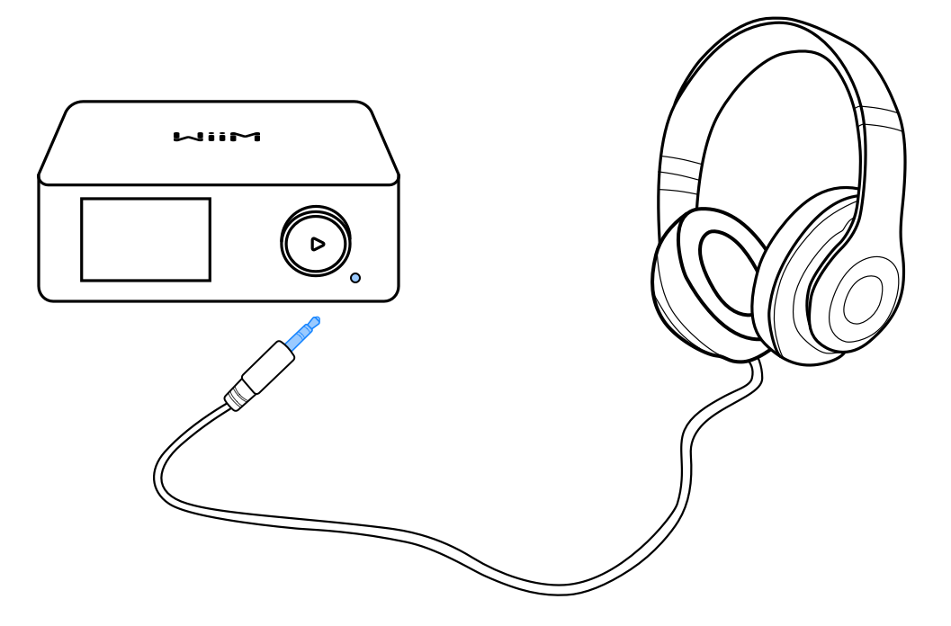

Connect Your Headphones
Plug the wired headphones into the Headphone Out port on your WiiM Ultra.

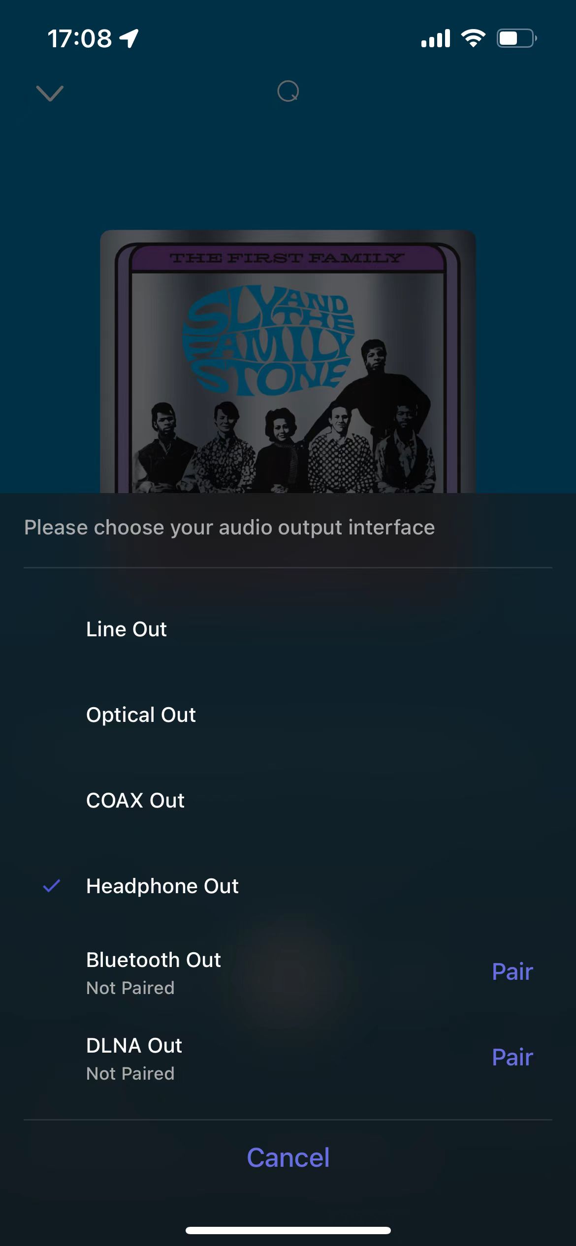

Option 1: From Now Playing in WiiM Home App
  1. Go to Now Playing in the WiiM Home app.
  2. Tap the icon at the bottom, then select Headphone Out from the list.

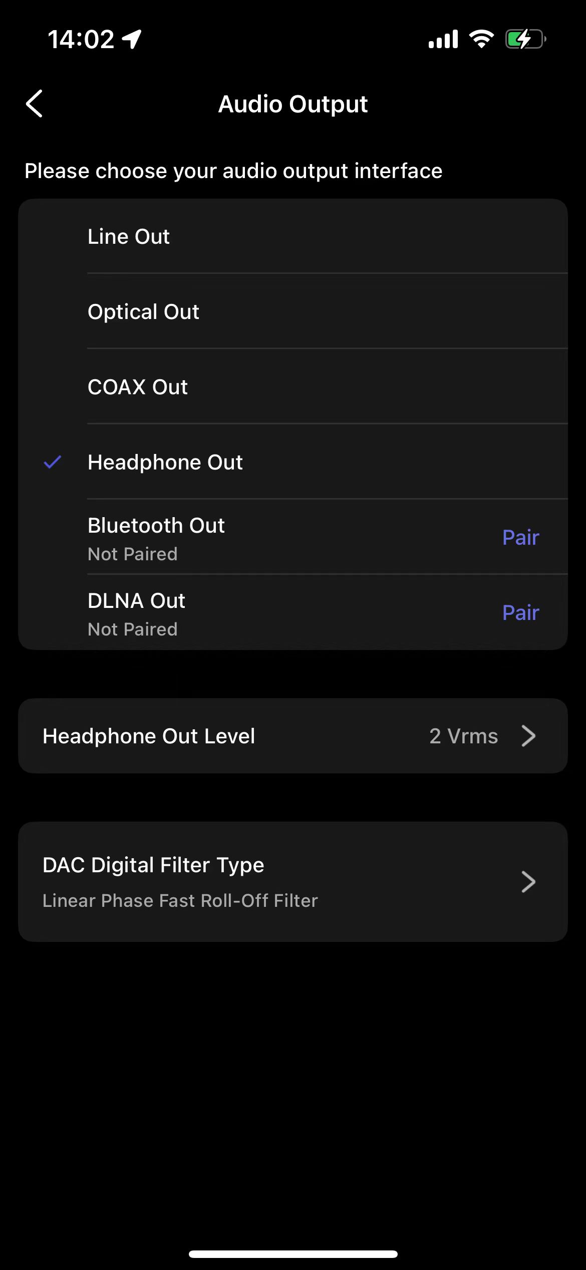

Option 2: From Device Settings in WiiM Home App
  1. Open the WiiM Home app on your mobile device.
  2. Go to the Devices tab and tap the Device Settings  icon.
  3. Select Audio Output and choose Headphone Out from the list.

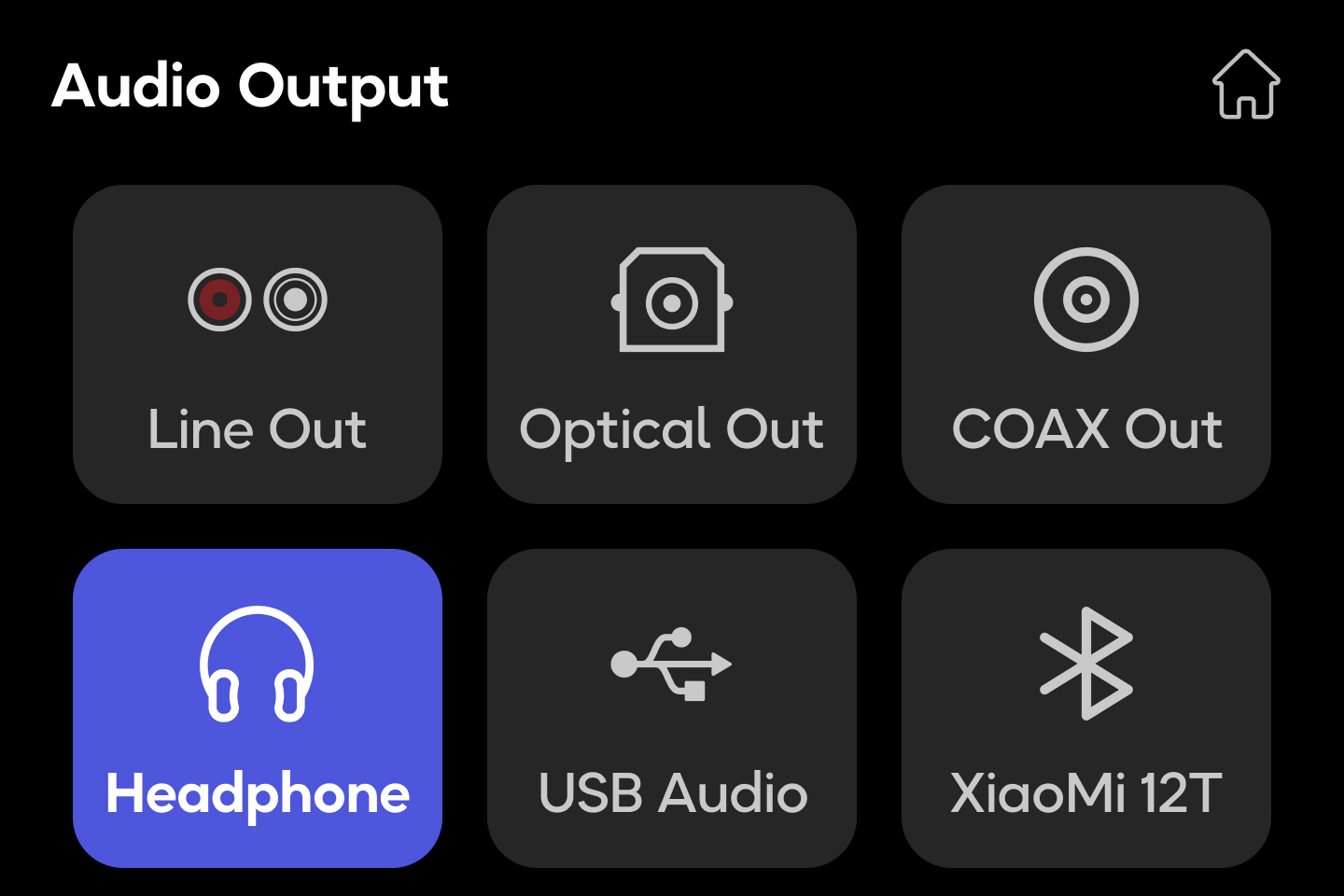

Option 3: From WiiM Ultra's Screen
Tap Output on your WiiM Ultra's screen, then choose Headphone.

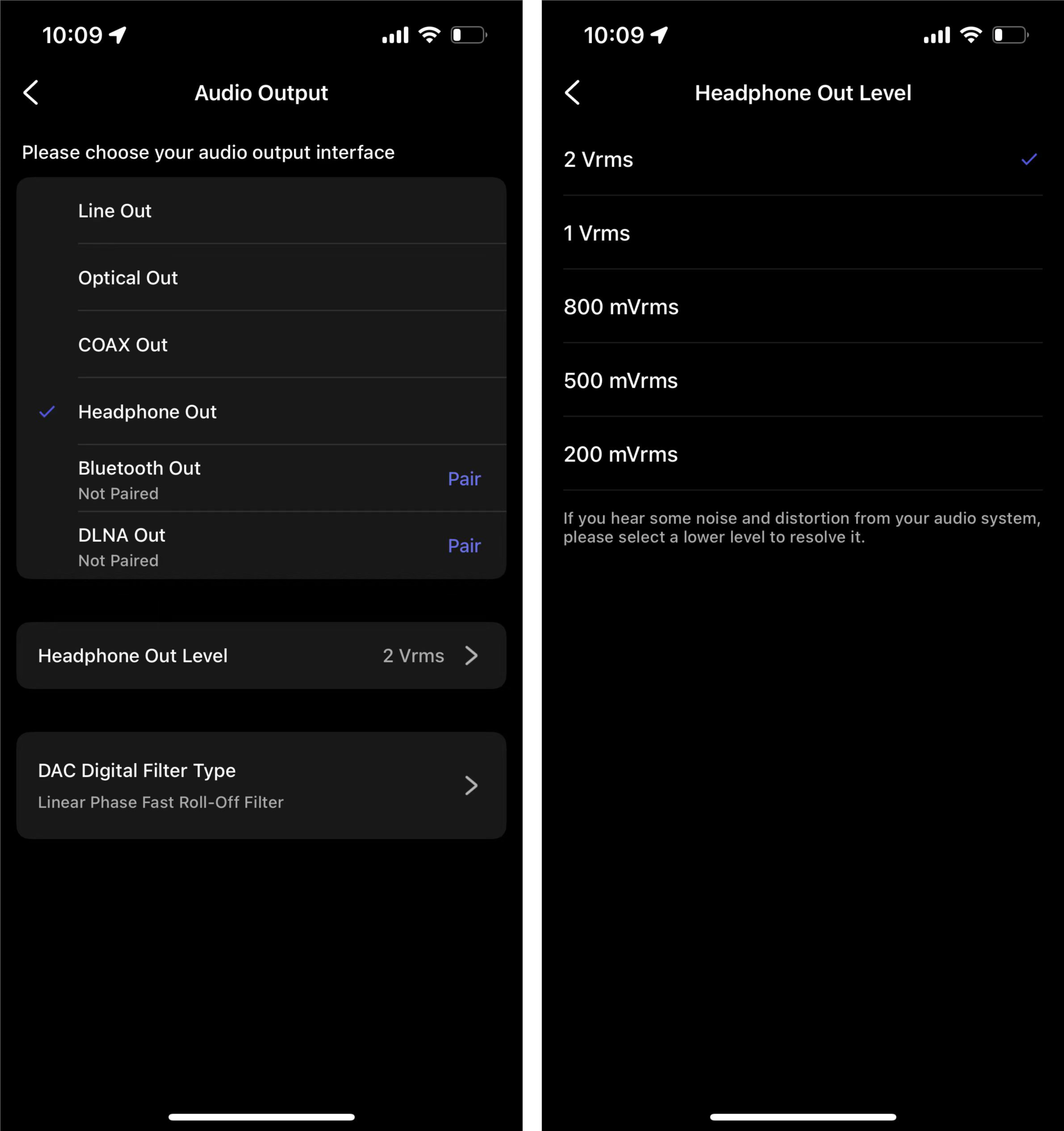

Adjust Headphone Out Level
Additionally, you can adjust the headphone output level in the WiiM Home app under Audio Output settings to optimize sound quality.
  • Increase the level if the headphone volume is too low.
  • Decrease the level if you hear noise or distortion.
