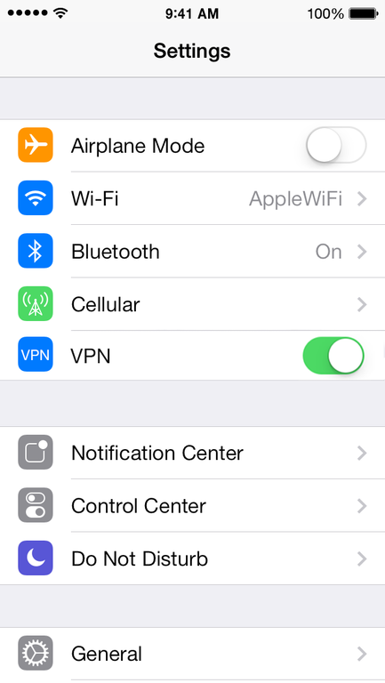

2. Check and Disable VPN
Open Settings on your smartphone and verify if the VPN setting is disabled.
If the VPN setting is enabled as shown in the example below, toggle it off to disable the VPN.
