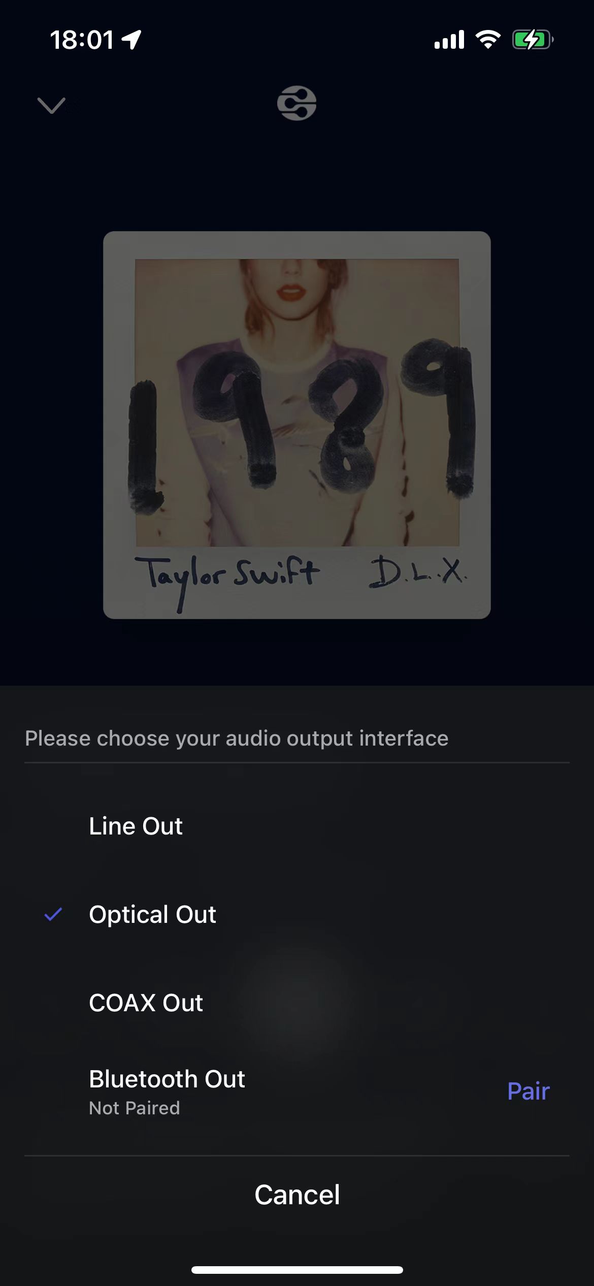

8. Check Active Output in the WiiM Home App
- Open the WiiM Home app.
- Go to the Now Playing screen.
- Tap the
icon at the bottom to check the active audio output port. Ensure that it is the correct output port.

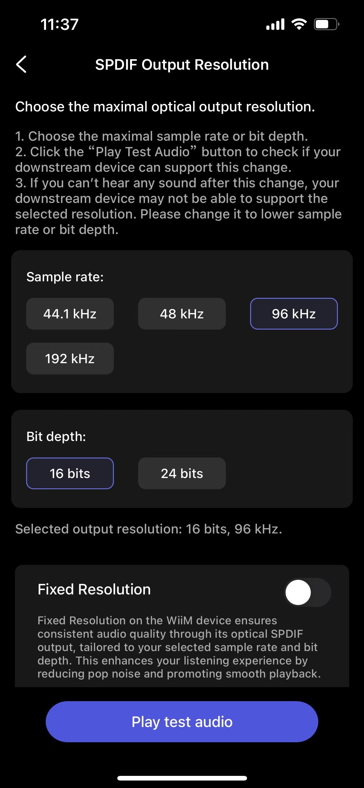

10. Downgrade Audio Resolution for Optical Out or Coax Out
If you are using the Optical Out or Coax Out port, try to change the maximum audio resolution. This can resolve sample rate compatibility issues.
- Go to the Devices tab and tap the Device Settings icon
of your WiiM device. - Select Audio Settings, and then select SPDIF Output Resolution or Coax Output Resolution, depending on the output you are using.
- Downgrade the maximum output resolution from, for example, 192 kHZ/24-bit to 96 kHZ/16-bit and then tap Play test audio to check the sound.
To ensure compatibility, check the maximum input sample rate supported by the external device (e.g., DAC or amplifier) connected to your WiiM device.
