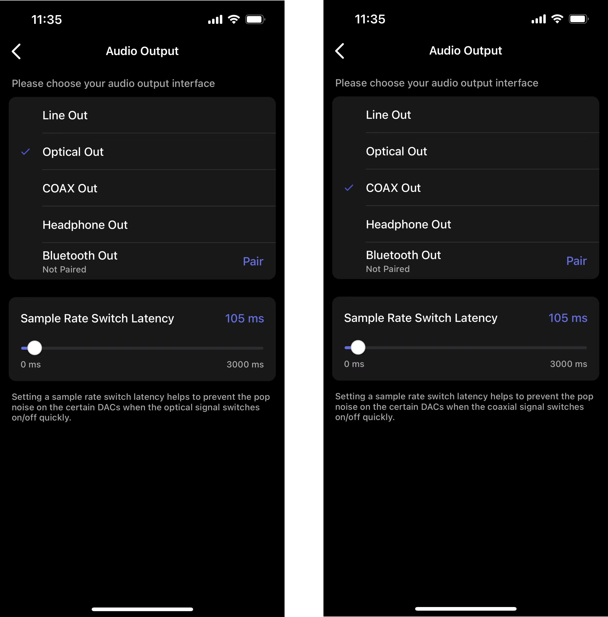

Solution 1: Adjust Sample Rate Switch Latency:
  1. Open the WiiM Home app.
  2. Go to the Devices tab > Device Settings > Audio Output.
  3. Select Optical Out or COAX Out, and increase Sample Rate Switch Latency to give the DAC more time to adapt.

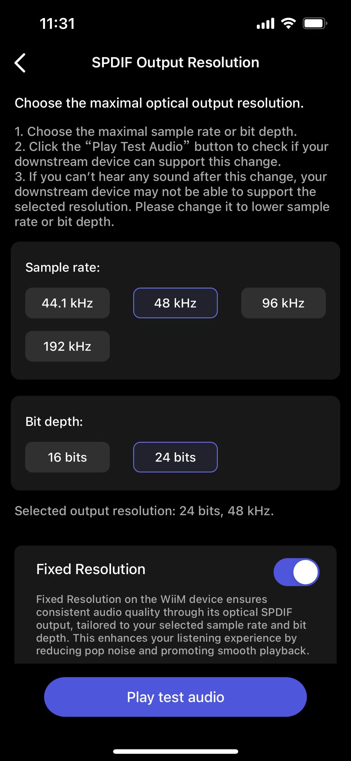

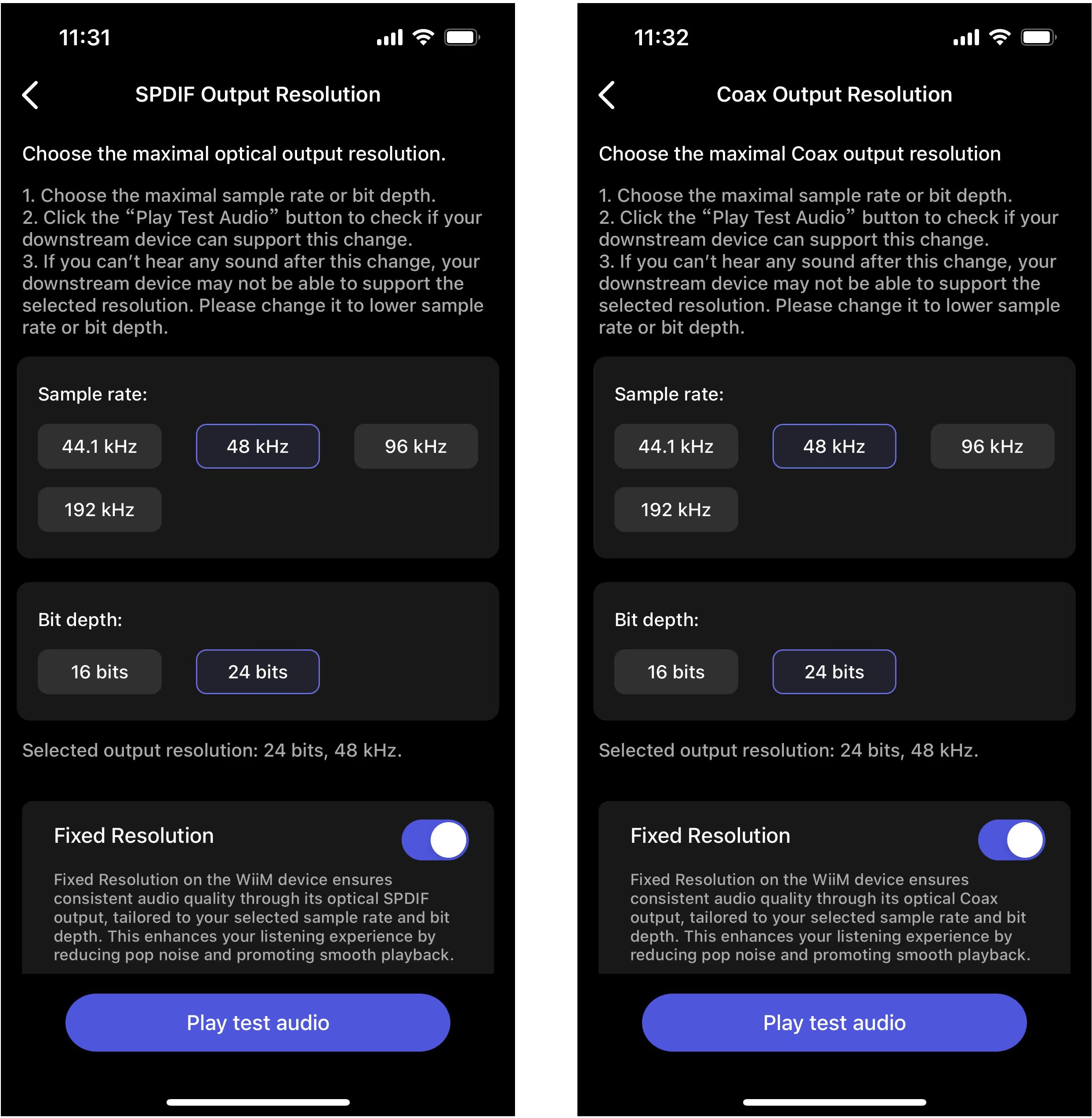

Solution 2: Use a Fixed Sample Rate:
  2. Go to the Devices tab > Device Settings > Audio Settings.
  3. Enable Fixed Resolution for Optical Out or COAX Out.
