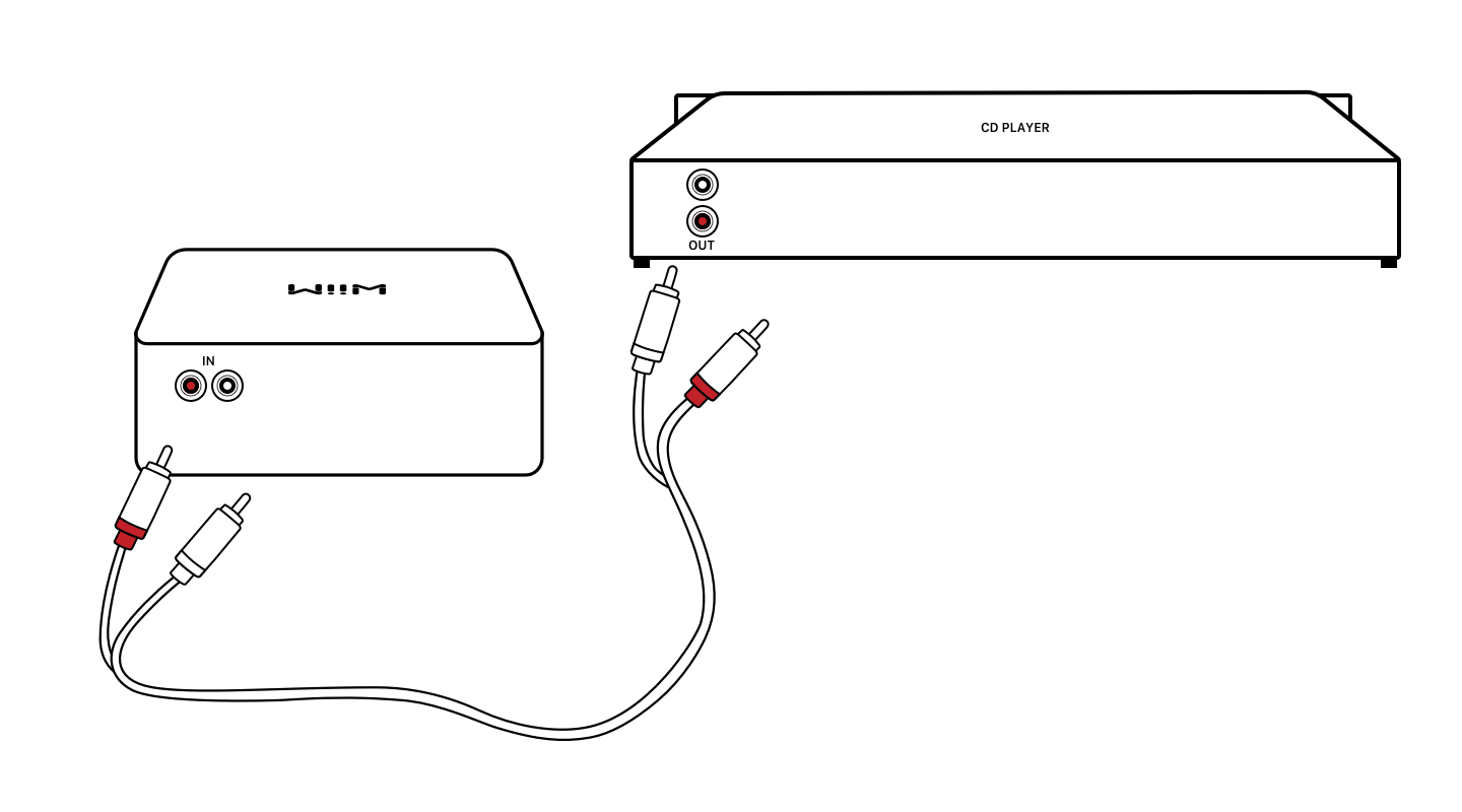

This example shows how to use the Line In port to connect a CD player:
- Use a RCA cable to connect the Line In port on your WiiM Ultra to the Line Out port on a CD player.
- Set the WiiM Ultra's source input to Line In. For details, see How to Select Audio Input.
- Play music on the CD player. The music will stream to your WiiM Ultra.
Similarly, you can connect other audio device to your WiiM Ultra via the Line In port in the same process.

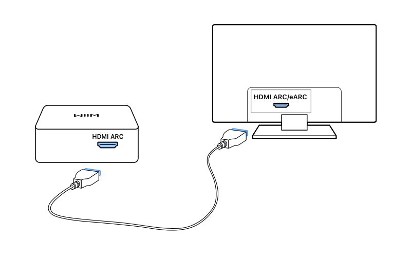

This example shows how to use the HDMI ARC port to connect a TV:
- Use an HDMI cable to connect the HDMI ARC port on your WiiM Ultra to the HDMI ARC port on your TV.
Note: ensure you use the HDMI ARC port on your TV. Other HDMI ports won’t transmit sound to the WiiM devices.
- Go to the TV settings, enable the HDMI ARC function and set your TV's audio output to select your WiiM Ultra.
- Set the WiiM Ultra's source input to HDMI ARC. For details, see How to Select Audio Input.
- The audio on the TV will play on your WiiM Ultra.
Similarly, you can connect other audio device to your WiiM Ultra via the HDMI ARC port in the same process.
If you encounter no sound issues with your TV, refer to HDMI ARC Troubleshooting.

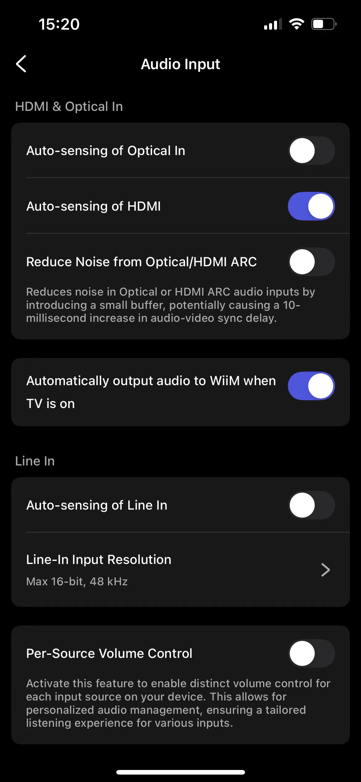

Automatically Select Audio Input using Auto-Sensing
The auto-sensing feature allows the WiiM Ultra automatically play audio from the connected input when a signal is detected.
To enable auto-sensing, follow these steps:
- Open the WiiM Home App.
- Navigate to the Devices tab.
- Tap the Device Settings icon
of your WiiM device.
- Select Audio Input and enable Auto-Sensing of Optical In, HDMI, and Line In.
By enabling auto-sensing, your WiiM device will automatically switch to the active audio input, offering a seamless and convenient listening experience.
Auto-sensing works only when your WiiM device isn't playing audio from the current input source. For example, if your WiiM device is playing music over Wi-Fi and you start audio on Line In, Optical In, or HDMI ARC, it won't automatically switch to that input.

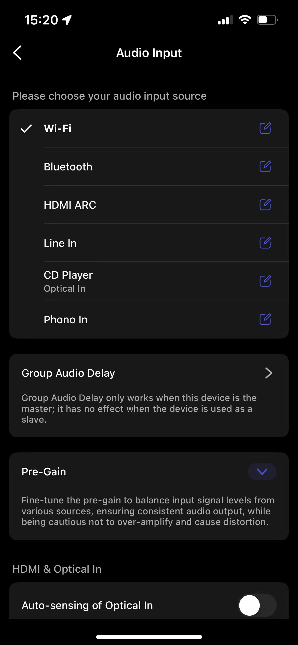

Manually Select Audio Input
You can also manually select the desired audio input on your WiiM Ultra in the following ways.
- Method 1: From Audio Input in Devices Settings of the WiiM Home App

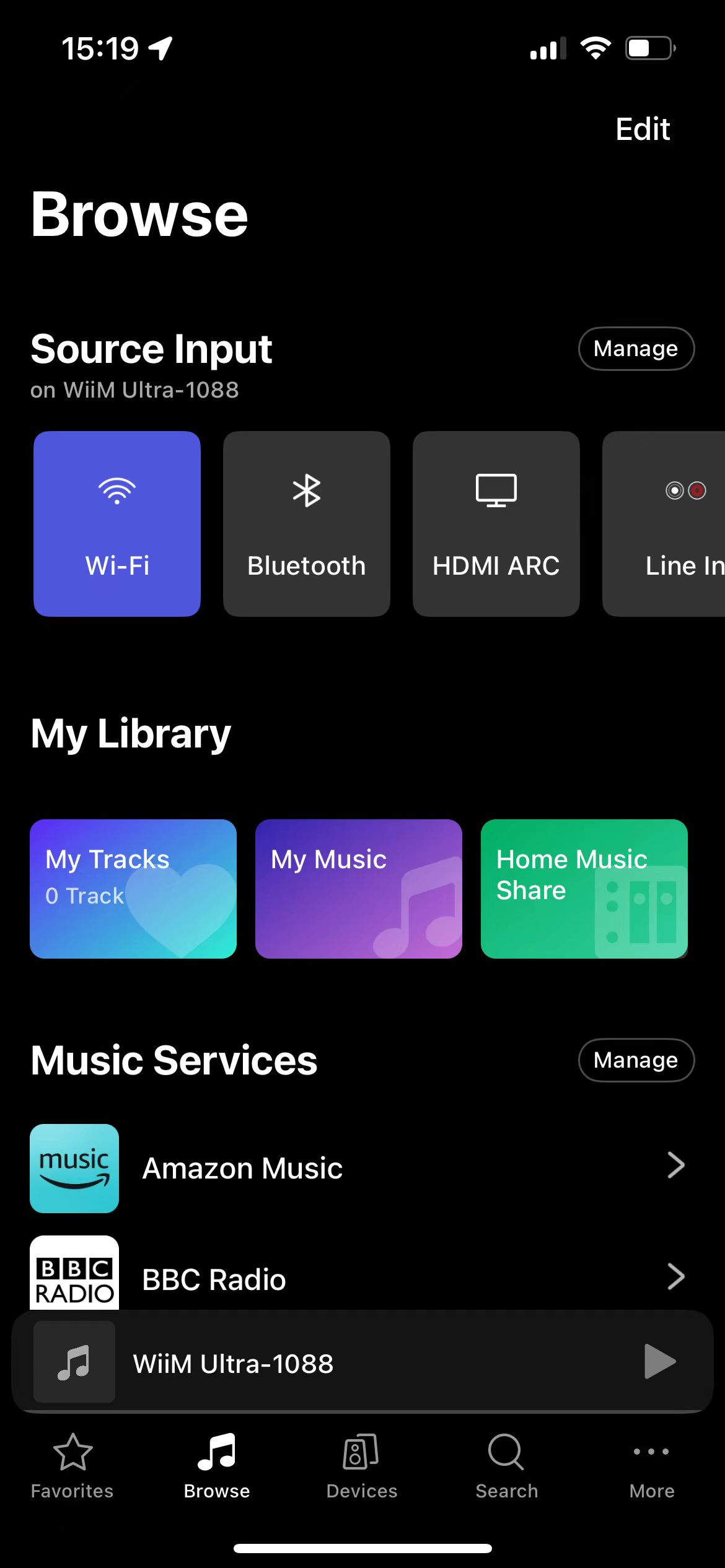

- Method 2: From the Source Input section in the Browse tab of the WiiM Home App

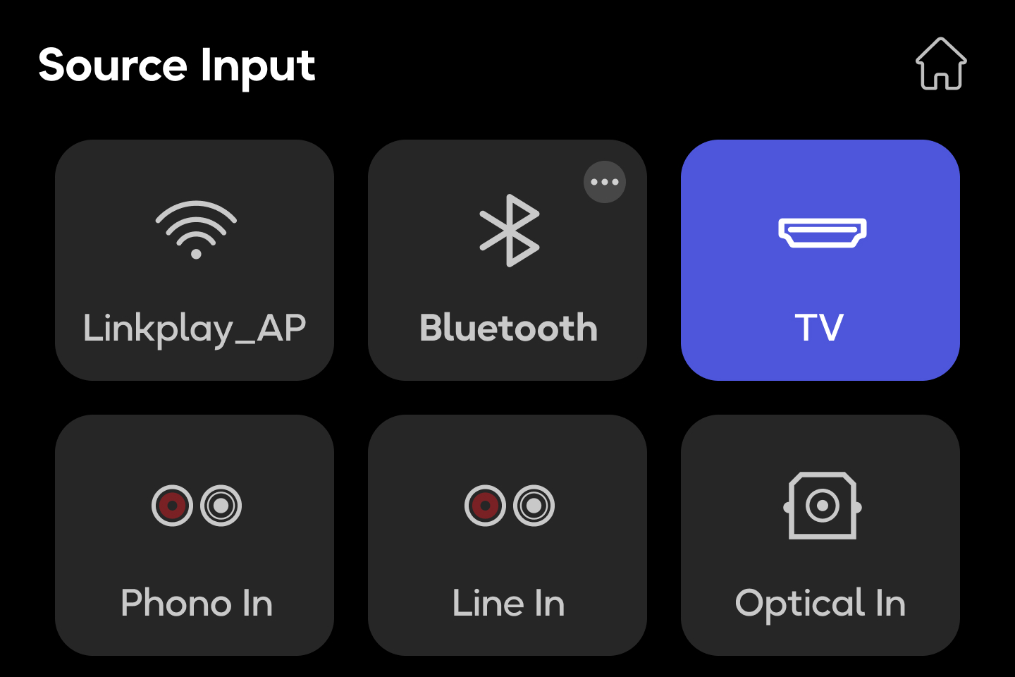

- Method 3: Using WiiM Ultra's Screen

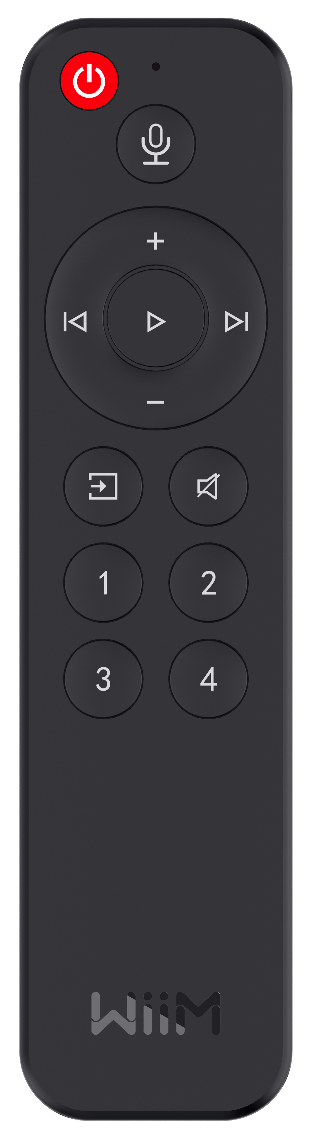

- Method 4: Pressing the
Button on the WiiM Voice Remote.
