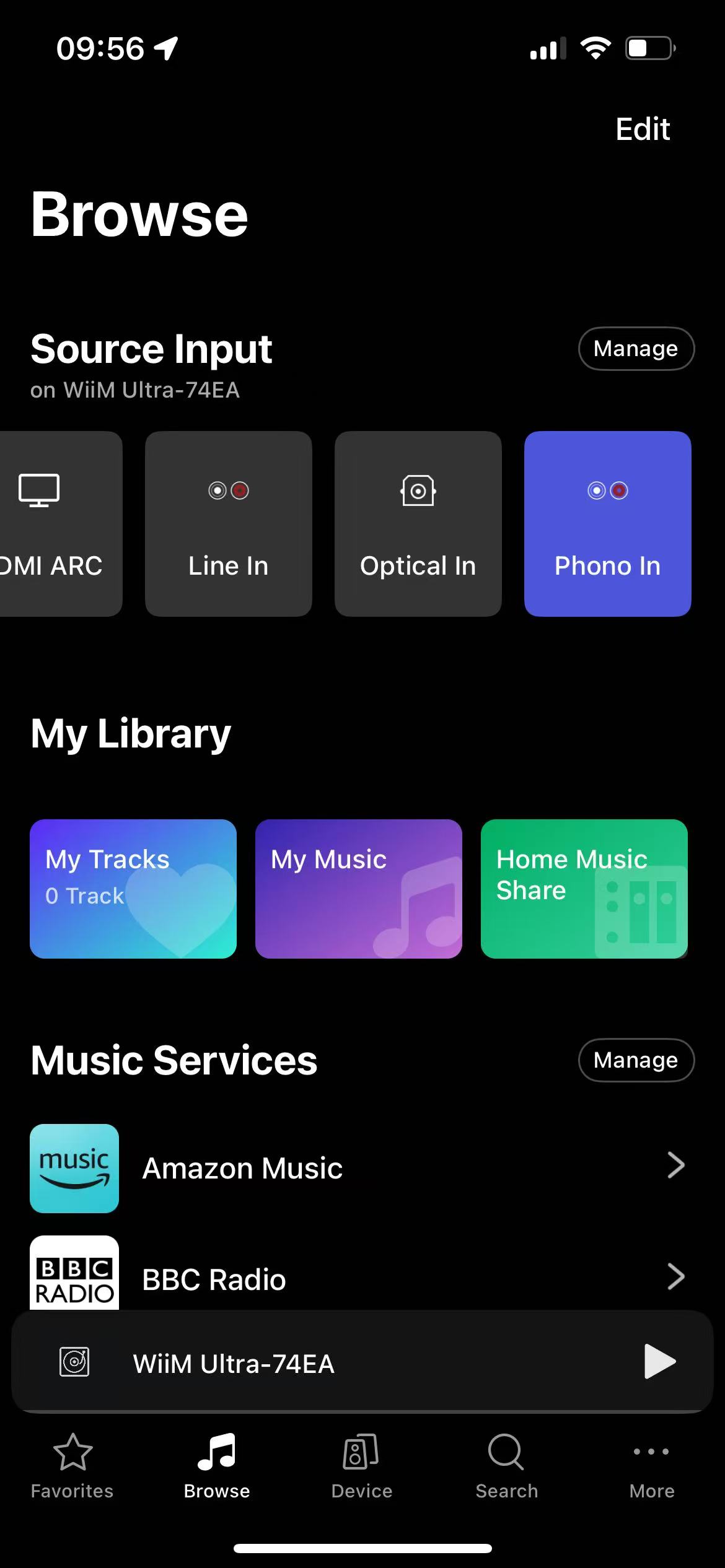

  4. Open the WiiM Home app and select Phono In as source input in the Browse tap.

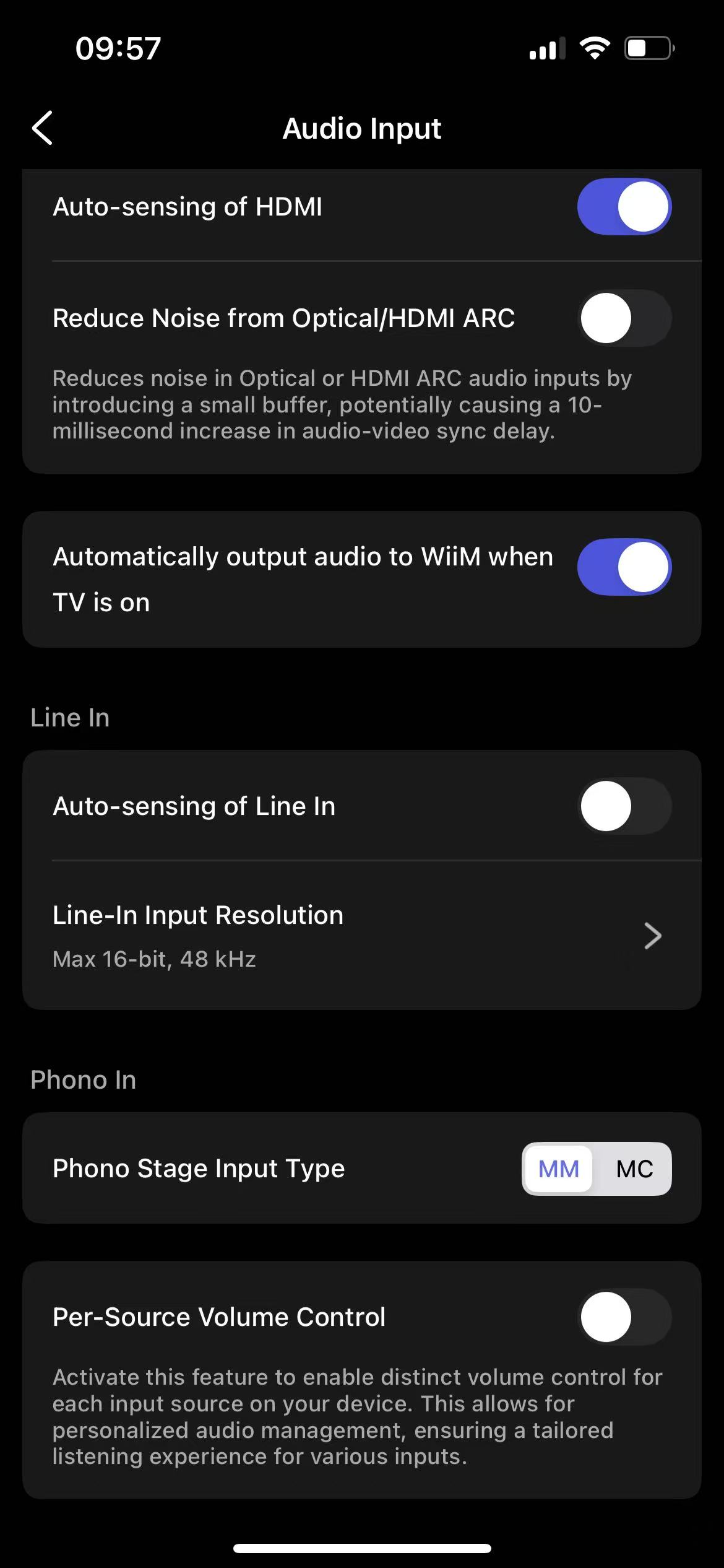

  5. Navigate to Devices tab > Device Settings > Audio Input, select Phono Stage Input Type based on the cartridge type of your turntable. The default setting is MM.

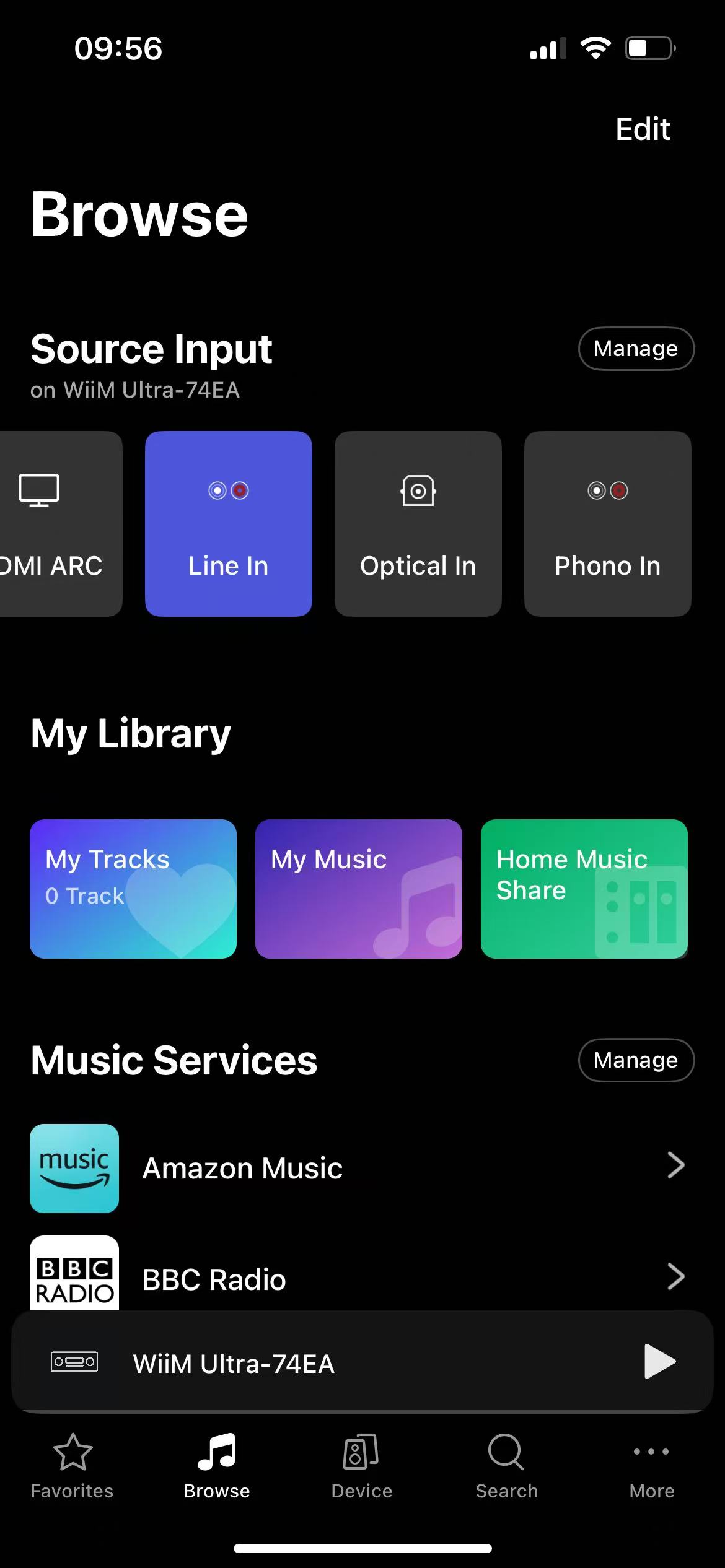

  4. Open the WiiM Home app and select Line In as source input in the Browse tap.
