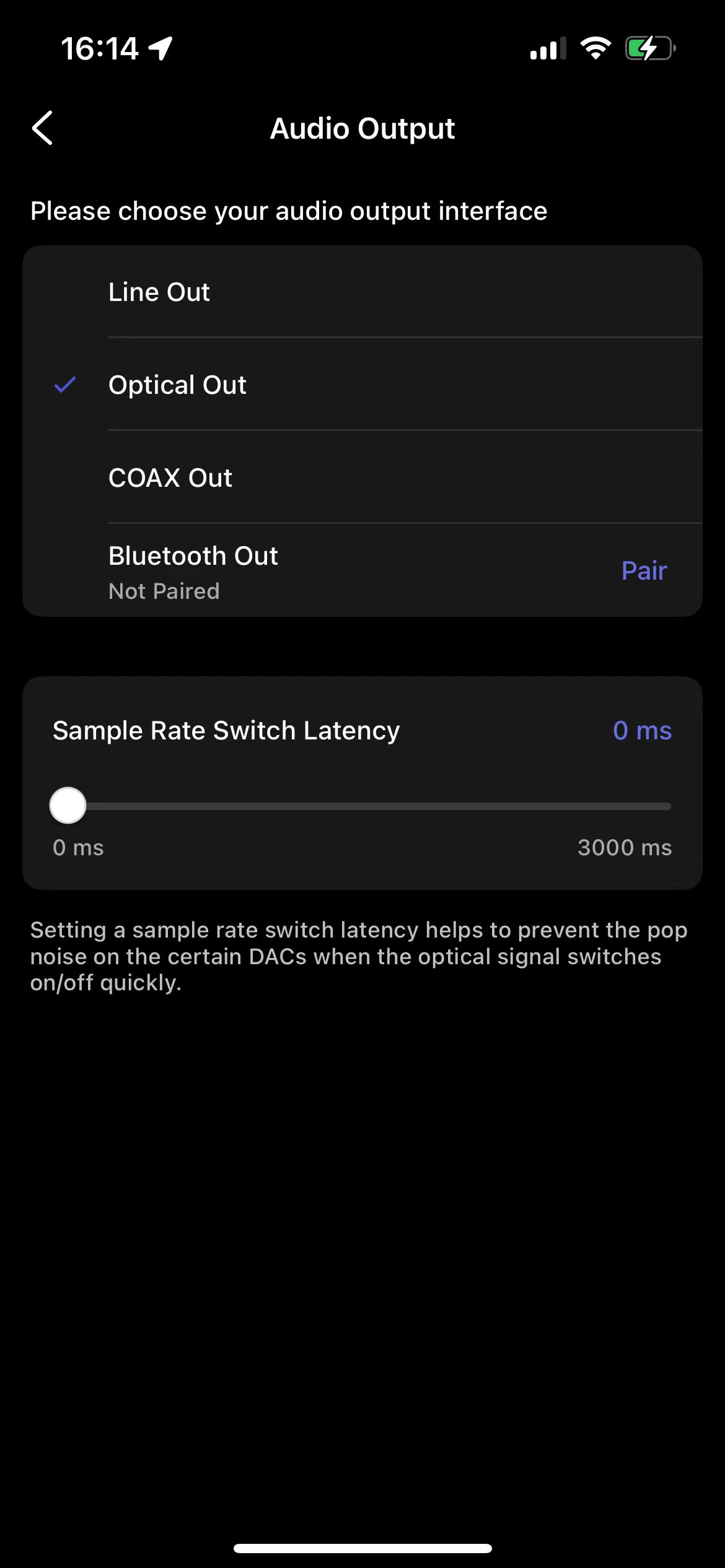

Step 1: Check the Active Audio Output
  1. Open the WiiM Home app.
  2. Go to Device tab > Device Settings > Audio Output.
  3. Make sure Optical Out is selected.

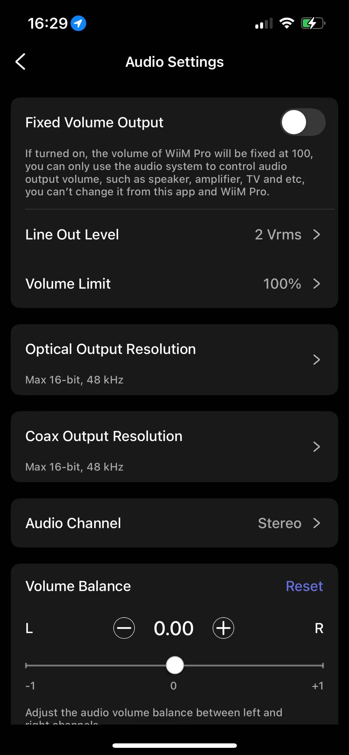

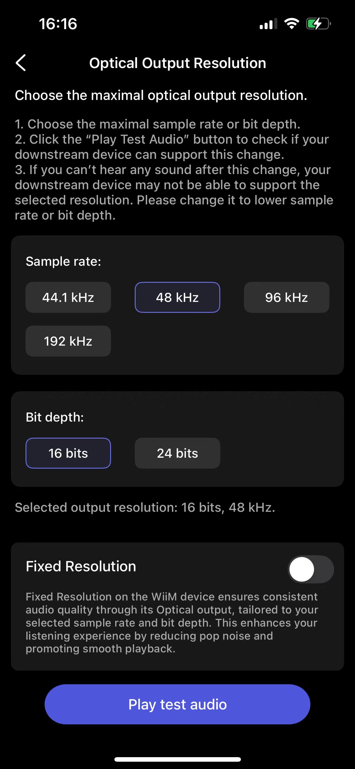

Step 3: Test Audio Resolution Settings
  1. In the WiiM Home app, navigate to Device tab > Device Settings > Audio Settings.
  2. Select Optical Output Resolution.
  3. Lower the resolution to a setting your audio system supports (e.g., 48 kHz /16 bits) and then play test audio.
