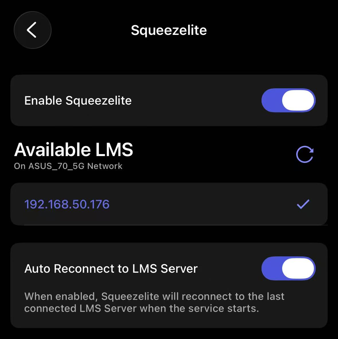

  1. Open the WiiM Home app.
  2. Go to the Devices tab > Device Settings Device Settings icon > Squeezelite.
  3. Enable Squeezelite. The device will automatically search for available LMS servers on the network.
  4. Select your LMS server from the list.
    Tip: If your LMS server does not appear in the list, tap Connect by IP Address to manually add the LMS server.

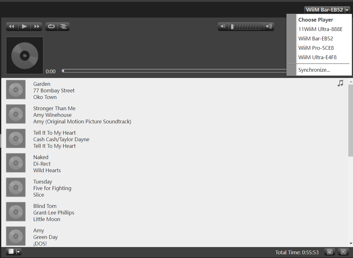

  1. Open an LMS-compatible controller app, such as the LMS web interface, iPeng, or Squeezer.

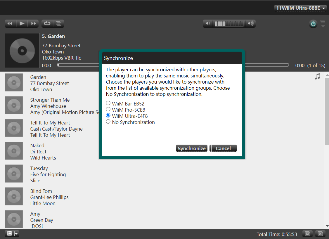

  2. Choose one WiiM device as the primary player and start playback. LMS playback screen
  3. In the LMS player menu, select Synchronize, and choose the WiiM device you want to add. Synchronize menu showing available WiiM devices
The selected WiiM devices will now play the same music in sync.

You can modify the LMS playback group at any time from the Synchronize option:
  • Select another WiiM device to update the group.
  • Select No synchronization to remove devices from the group.

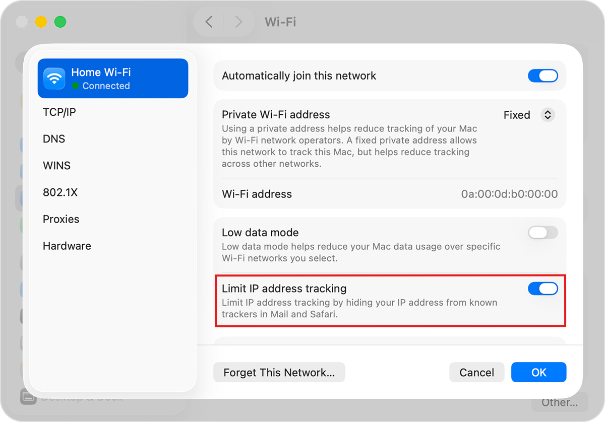

  4. If you are running LMS on a Mac, open the Mac's Network Settings and check whether Limit IP address tracking is enabled. If it is, turn it off and restart LMS.
