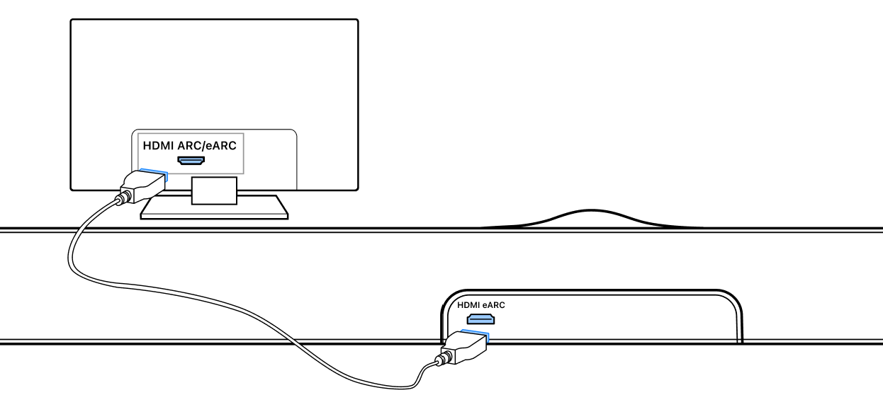

Step 2: Connect the WiiM Bar to the TV
Connect the WiiM Bar to the TV via the HDMI ARC/eARC port. Make sure to use the HDMI port labeled "ARC/eARC". Using another HDMI port will not produce sound.
If the TV has no HDMI ARC/eARC, connect via the Optical port.
Note: When using the Optical connection, you cannot adjust the WiiM Bar's volume using the TV remote.

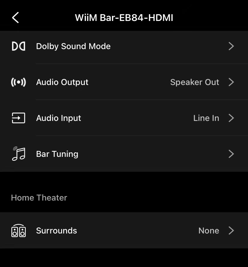

  2. Go to the Devices tab > WiiM Bar's Device Settings > the Home Theater section.

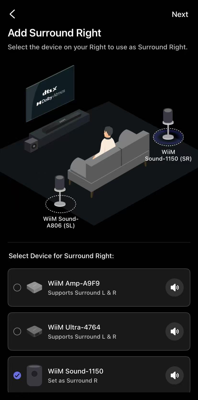

  3. Tap the Surrounds setting.
  4. Select the Surround Left (SL) and Surround Right (SR) speakers, then tap Next.
    Tip:
    • Choose two WiiM Sound/Sound Lite speakers or one WiiM streamer/streaming amplifier.
    • Tap the volume icon  next to each surround speaker to confirm you've selected the correct speaker.

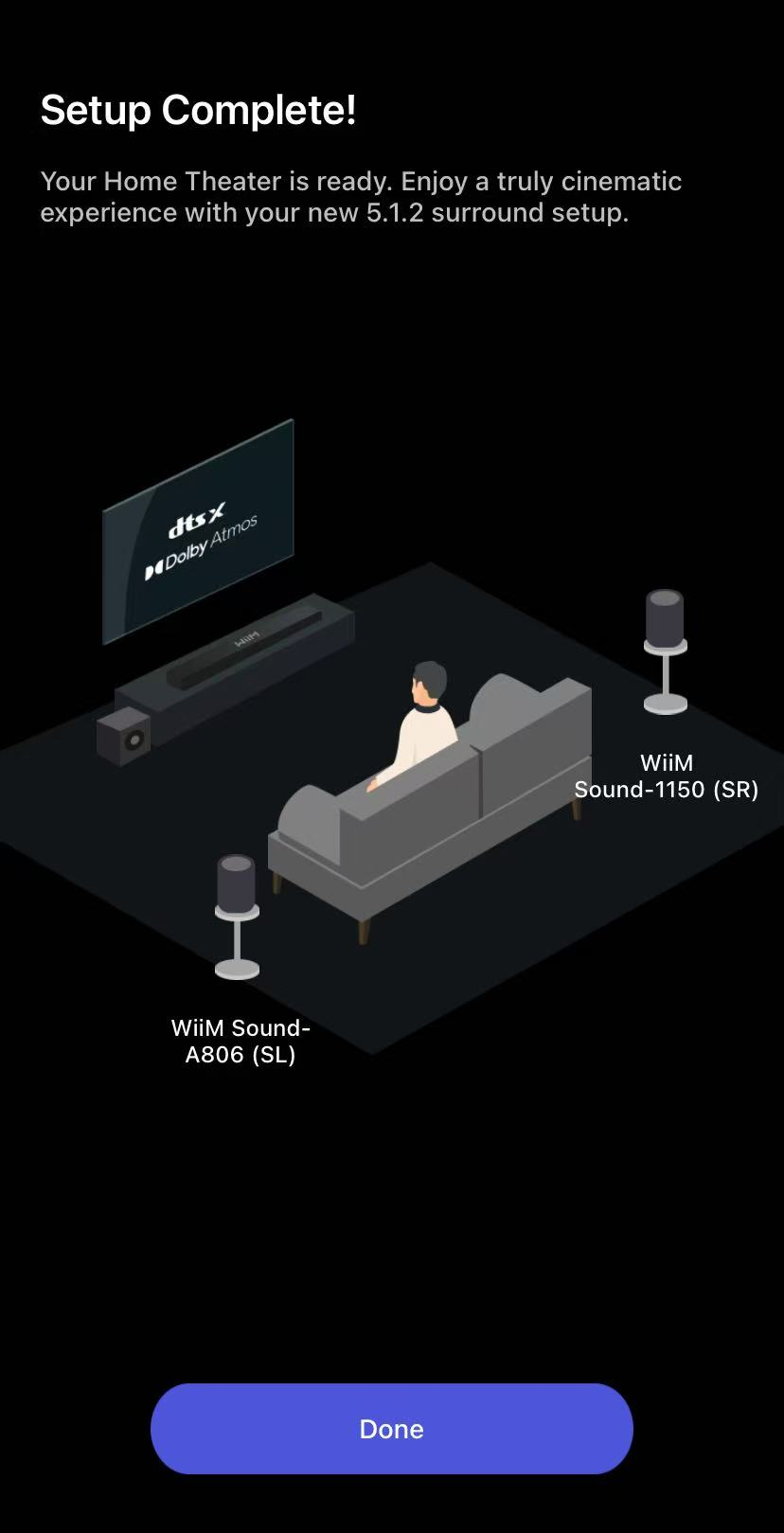

  5. When the Setup Complete page appears, tap Next to check the surround speaker connections.
  6. Tap Start to check the surround speaker connections. You can also skip this step and check them later.
Once the 5.1.2 surround sound system is created, it is enabled automatically. Play audio on the TV and enjoy a truly cinematic experience.

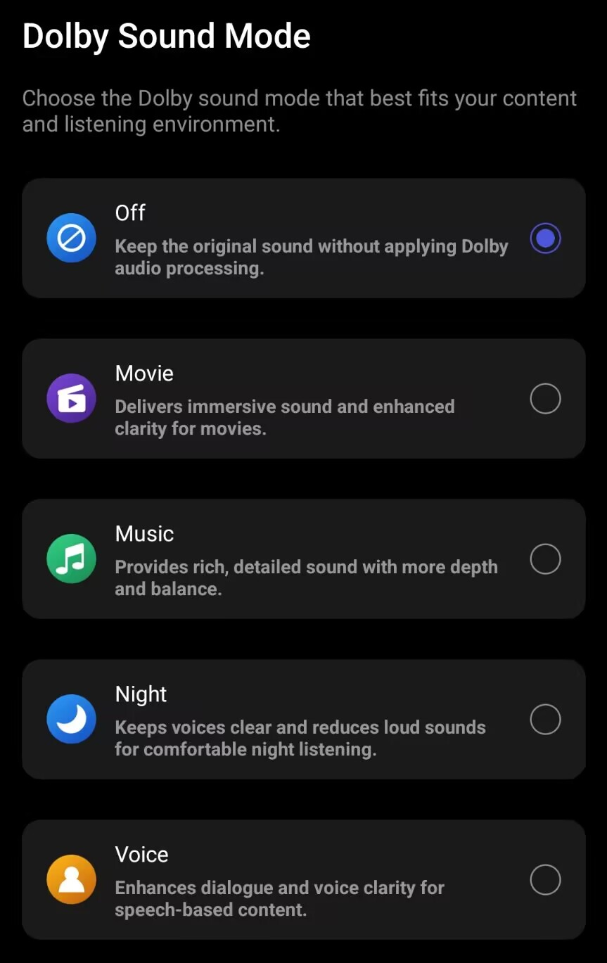

Select a Sound Mode to Enhance Audio
The WiiM Bar offers four Sound Modes specifically for Dolby and DTS—Music, Movie, Voice, and Night—so you can quickly optimize audio for different content and listening environments. For details, see Understanding Dolby and DTS Sound Modes on Your WiiM Bar.
Simply select your preferred sound mode using the WiiM Bar Remote.
