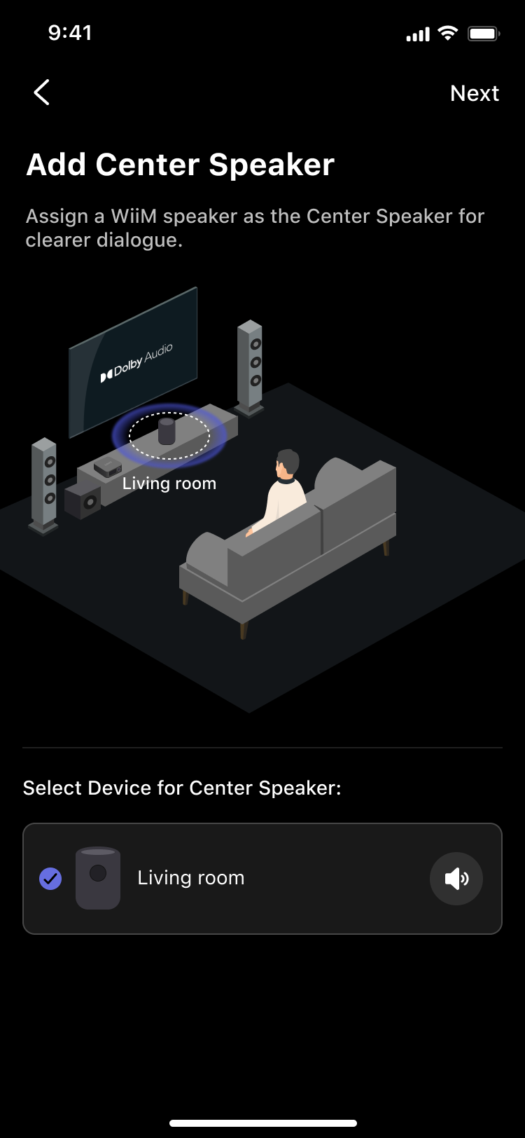

Center Speaker Setup
  1. Open the WiiM Home app.

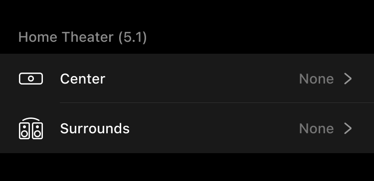

  2. Go to Devices > your hub device’s Device Settings.
  3. Tap Center in the Home Theater section.
  4.  Select your WiiM device as the Center speaker.
    Tap the volume icon next to the Center speaker to confirm you've selected the correct speaker.
  5. Follow on-screen instructions to complete the setup.
Once the Center speaker is added, the Home Theater system is enabled automatically. Play Dolby Digital content on the TV and enjoy an immersive audio experience.
