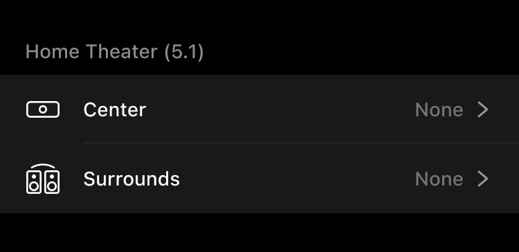

  2. Go to Devices > your hub device’s Device Settings.
  3. Tap Surrounds in the Home Theater section.

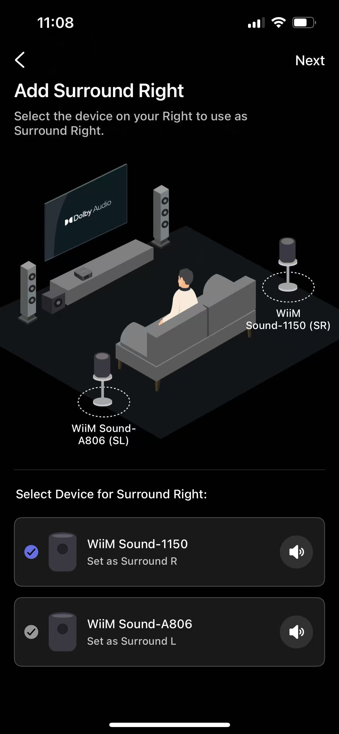

  4. Select your WiiM device(s) as the SL and SR speakers.
    Tips:
    • Choose either two WiiM Sound/Sound Lite speakers or one WiiM streamer/streaming amplifier.
    • Tap the volume icon next to each surround speaker to confirm you've selected the correct speaker.
  5. Follow on-screen instructions to complete the setup
