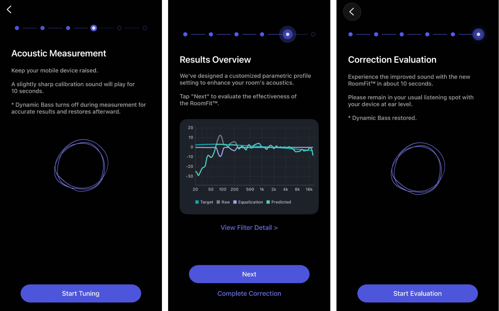

Step-by-Step Guide
| Steps | Details |
| 1. Open WiiM Home. | Open the WiiM Home app on your mobile device. |
| 2. Open RoomFit™. | Go to the Devices tab > Device Settings |
| 3. Configure RoomFit™ parameters. | Tap the ![]() For details, see Introducing RoomFit™ Settings and A Practical Guide to RoomFit™ Room Correction for Enhanced Sound Quality. |
| 4. Start RoomFit™ process. | Tap Next to start the RoomFit™ process. Tip: Follow the prompt to rotate your phone 180°, so the bottom microphone faces the speakers for accurate measurement. ![]() |
| 5. Audio check. | Tap Play Sound to perform an audio check. ![]() |
| 6. Start tuning. | Tap Start Tuning to begin the acoustic measurement, then review the RoomFit™ result from the curves below:

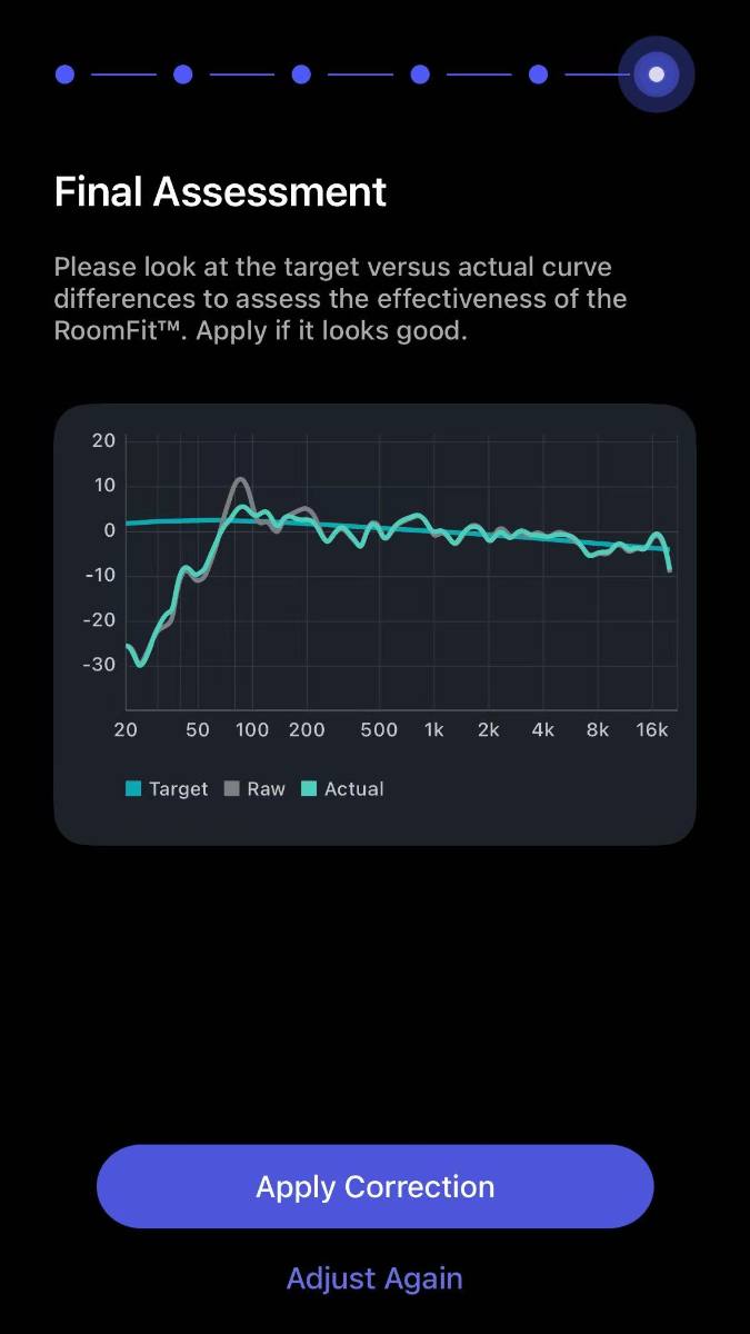

| 7. Evaluate results. | Evaluate the actual RoomFit™ result from the curves below:
![]() If the Actual curve closely matches the Target curve within the adjustable range, the RoomFit™ result is effective. Tap Apply Correction to proceed. If there are large differences, tap Adjust Again to re-run RoomFit™. |

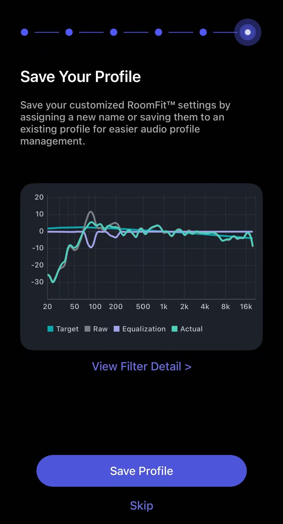

| 8. Save results. | Tap Save Profile to save the RoomFit™ results as a custom profile. Alternatively, tap Skip to save into the Auto profile. ![]() |
| 9. Finish. | Tap Done to finish the RoomFit™ process. ![]() Note: Once the RoomFit™ process is completed, the saved profile will be automatically applied to all input sources, so you do not need to perform it separately for each one. |
