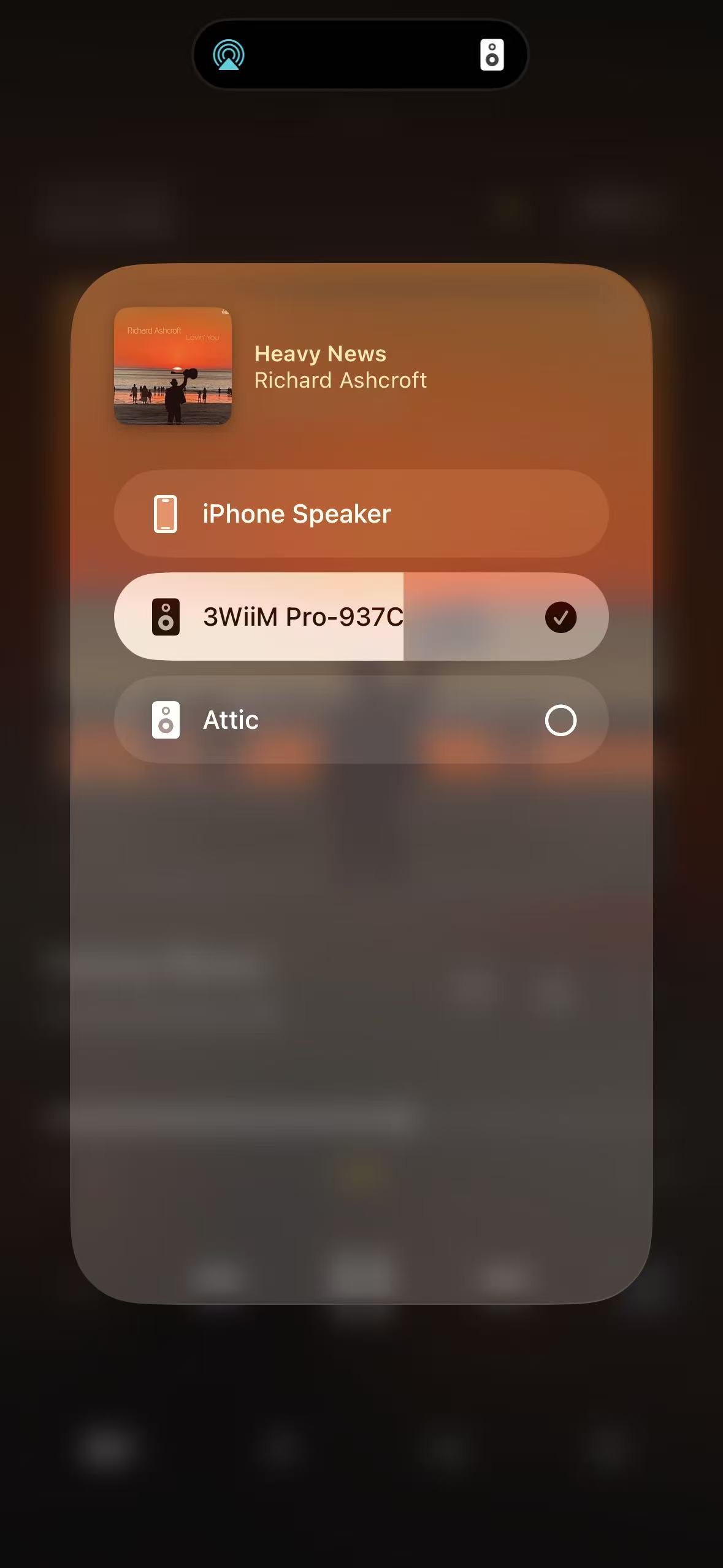

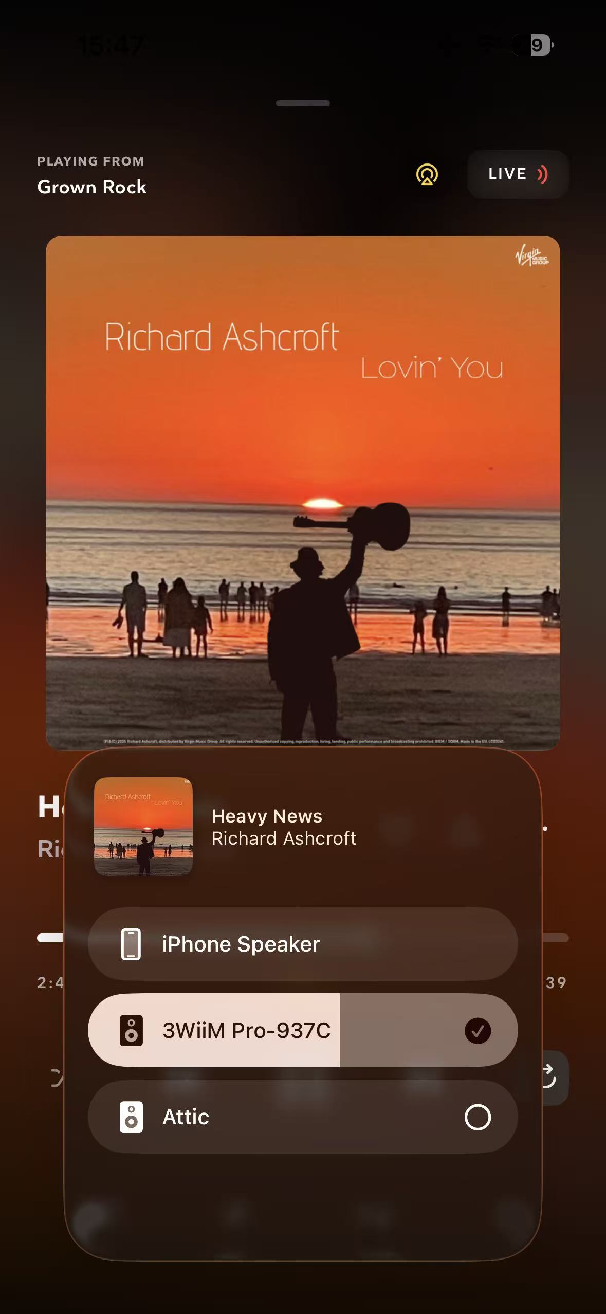

- Disconnect AirPlay in one of the following ways:
- Option 1: Tap the AirPlay icon
at the top of the TIDAL app and select iPhone Speaker.
- Option 2: Open the Control Center on your iPhone, tap the AirPlay icon
, and switch to iPhone Speaker.

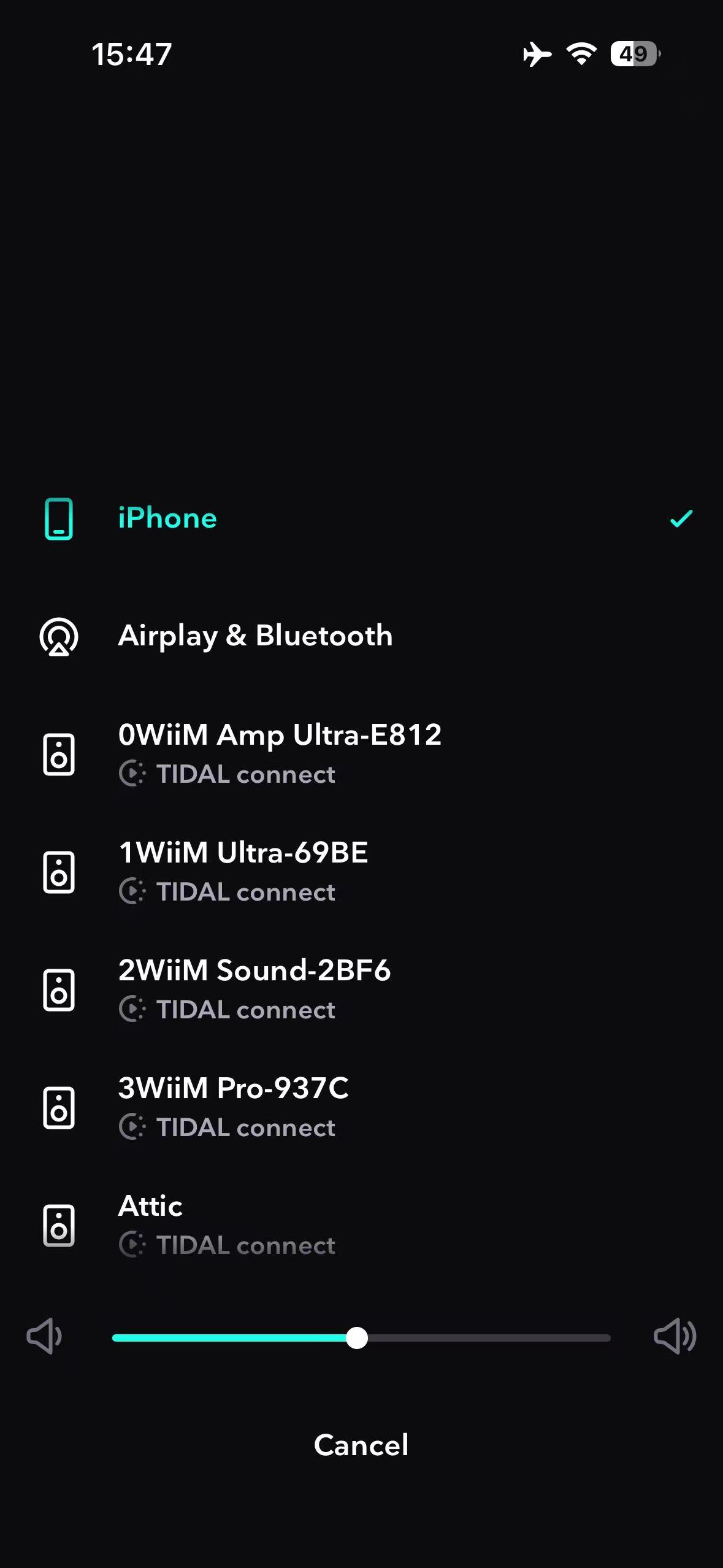

- The TIDAL Connect option should appear. Select your WiiM device to start streaming with TIDAL Connect.
