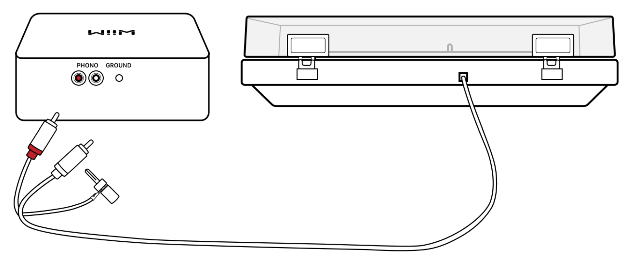

1. Connect the Ground Wire
Make sure to connect your turntable's ground wire to the GROUND port on the back of the WiiM Ultra using the provided phono ground adapter.

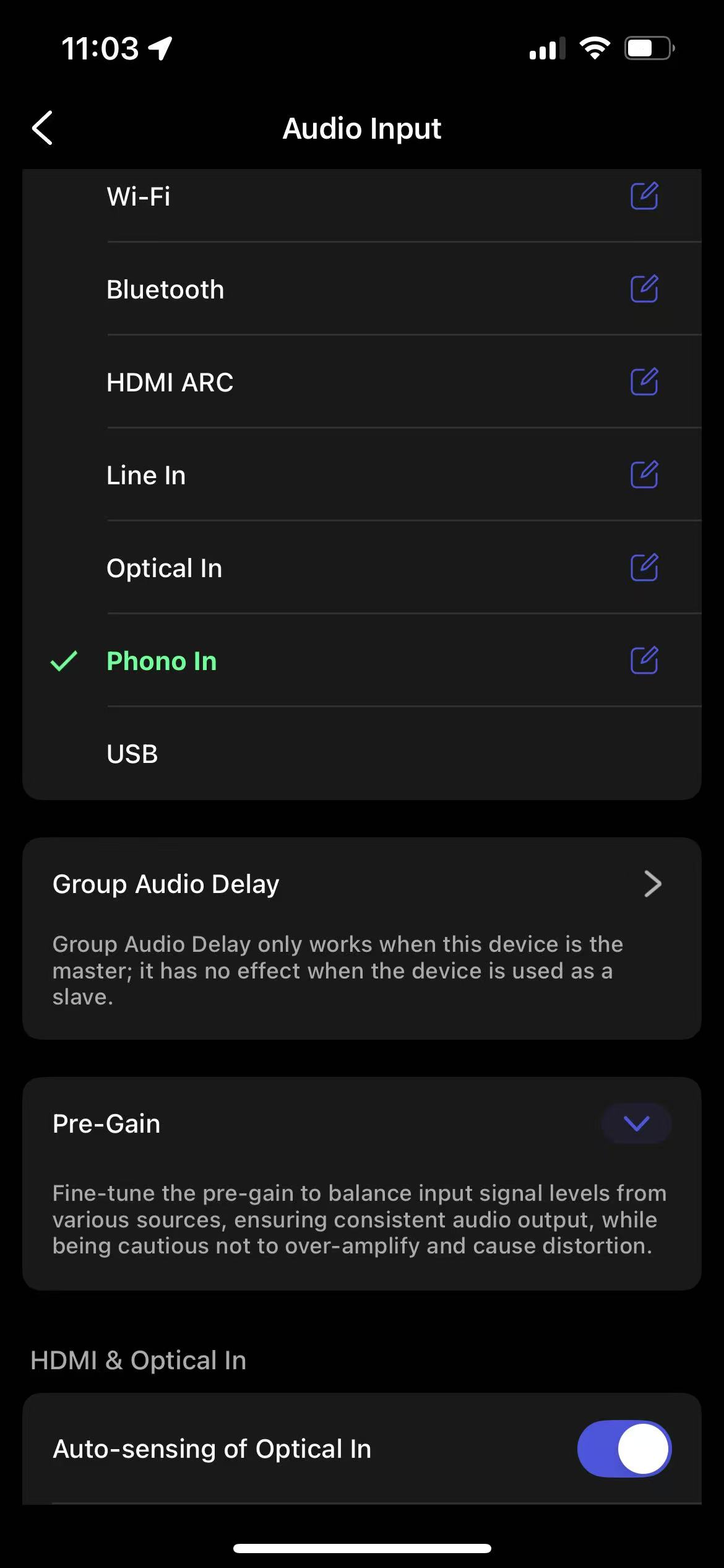

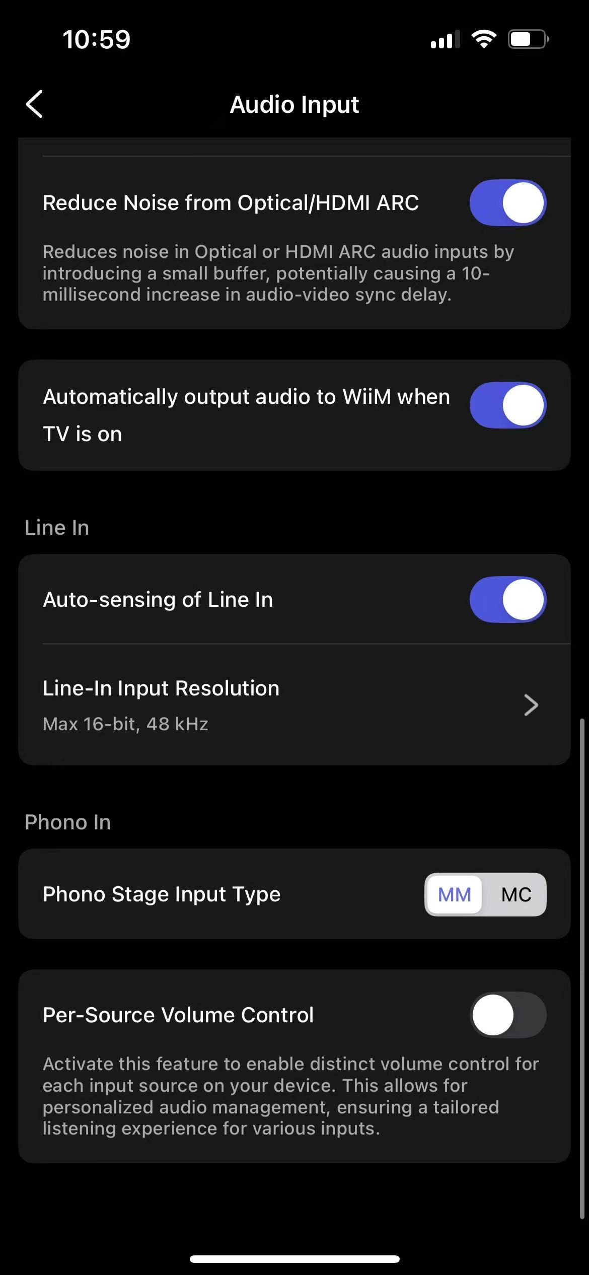

4. Check Input Settings
  1. Open the WiiM Home app.
  2. Navigate to the Devices tab > Device Settings > Audio Input.
  3. Make sure to select the Phono In audio input source.
  4. Make sure to select the correct Phono Stage Input Type (MM or MC) based on the cartridge type of your turntable.
