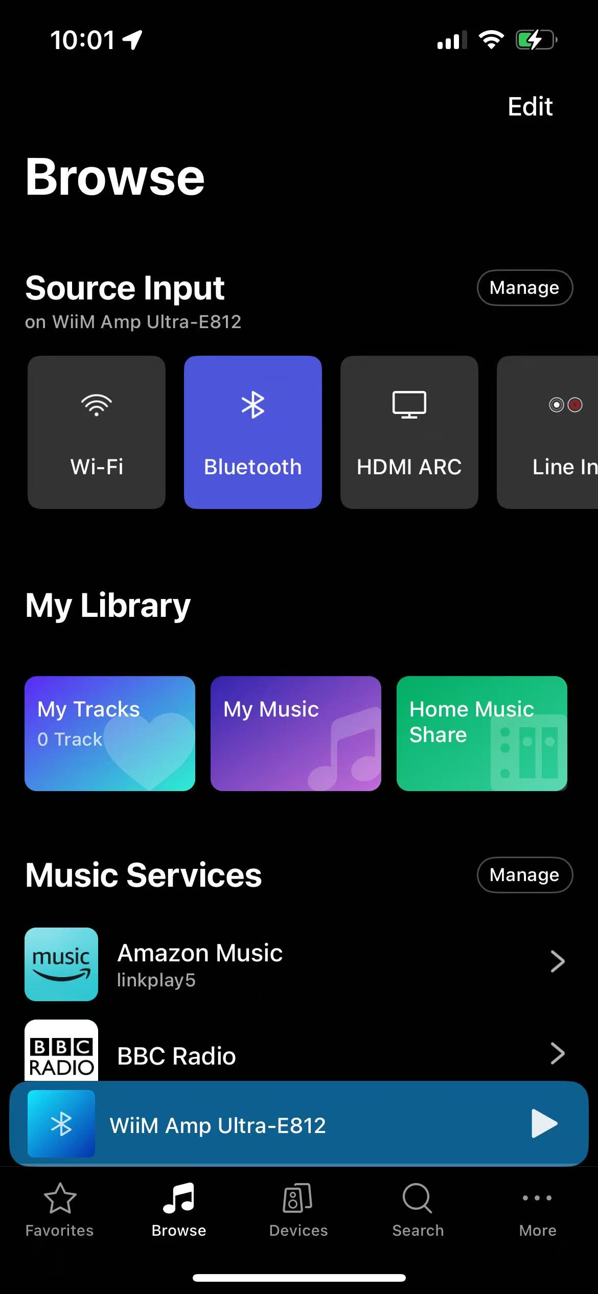

  • Method 1Open the WiiM Home app and select Bluetooth input in Browse tap.

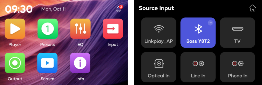

  • Method 2Tap Input in your WiiM Amp Ultra's screen and select Bluetooth input.

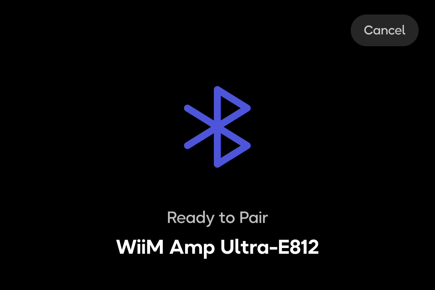

When using this option to initiate the Bluetooth pairing mode, the WiiM Amp Ultra's LED indicator will start flashing slowly in green, and a prompt, similar to the one below, will appear on the WiiM Amp Ultra's screen.

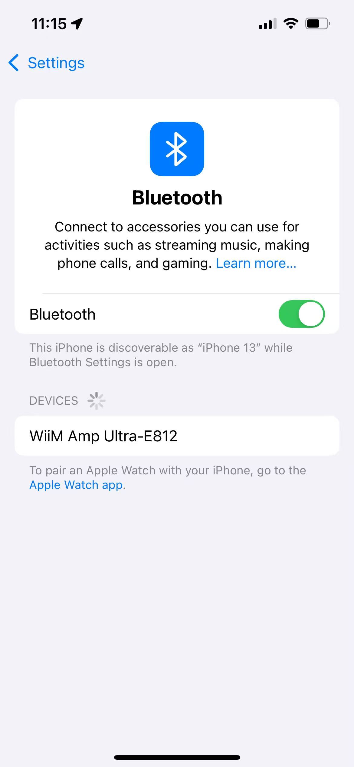

  1. Go to Settings on your mobile device and turn on Bluetooth. Your mobile device starts to search for available Bluetooth devices
  2. When your WiiM Amp Ultra appears in the device list, select it to complete the pairing process.

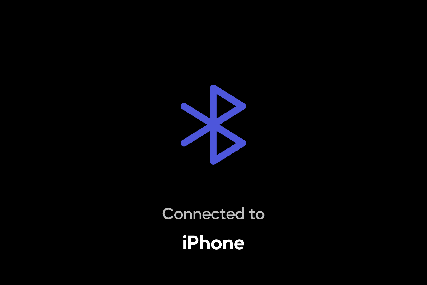

    Once paired successfully, the WiiM Amp Ultra's LED indicator will turn solid green, and a prompt, similar to the one below, will appear on its screen, depending on the way to initiate Bluetooth pairing mode on the WiiM Amp Ultra.
The LED indicator turns solid green only if Bluetooth pairing mode is initiated using Option 1.
The prompt on the WiiM Amp Ultra's screen will appear only if Bluetooth pairing mode is initiated using Option 1.

  • Method 1Open the WiiM Home app and select an input in Browse tap.
  • Method 2Tap Input in your WiiM Amp Ultra's screen and select an input.

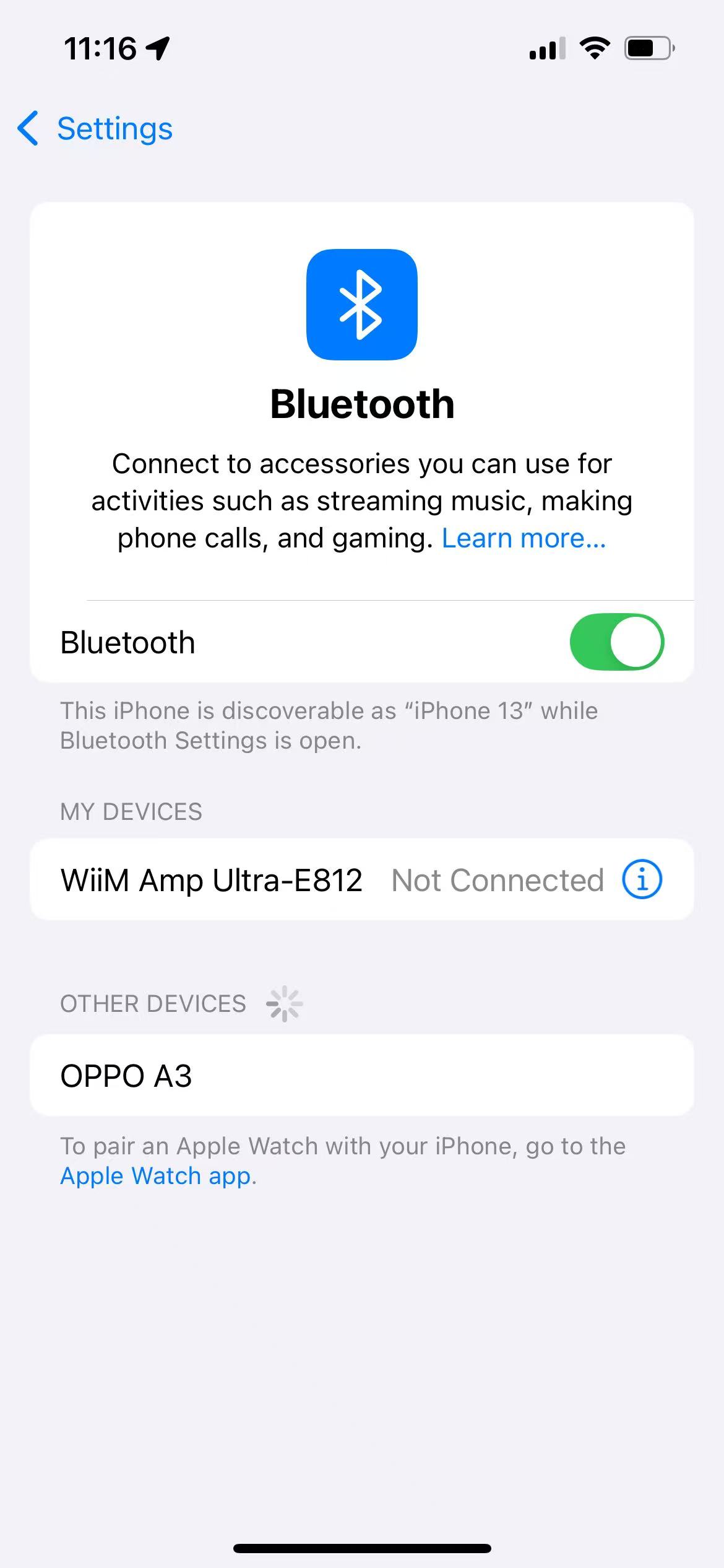

Option 2: Disconnect from Mobile Device

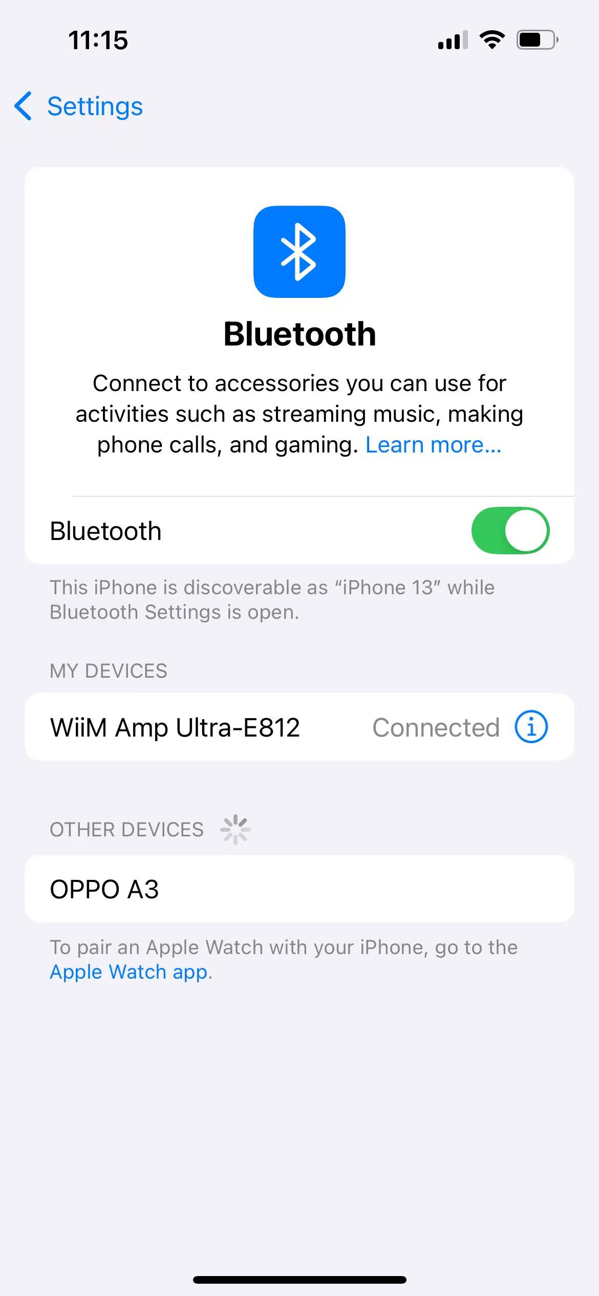

  1. Go to the Bluetooth setting on your mobile device.

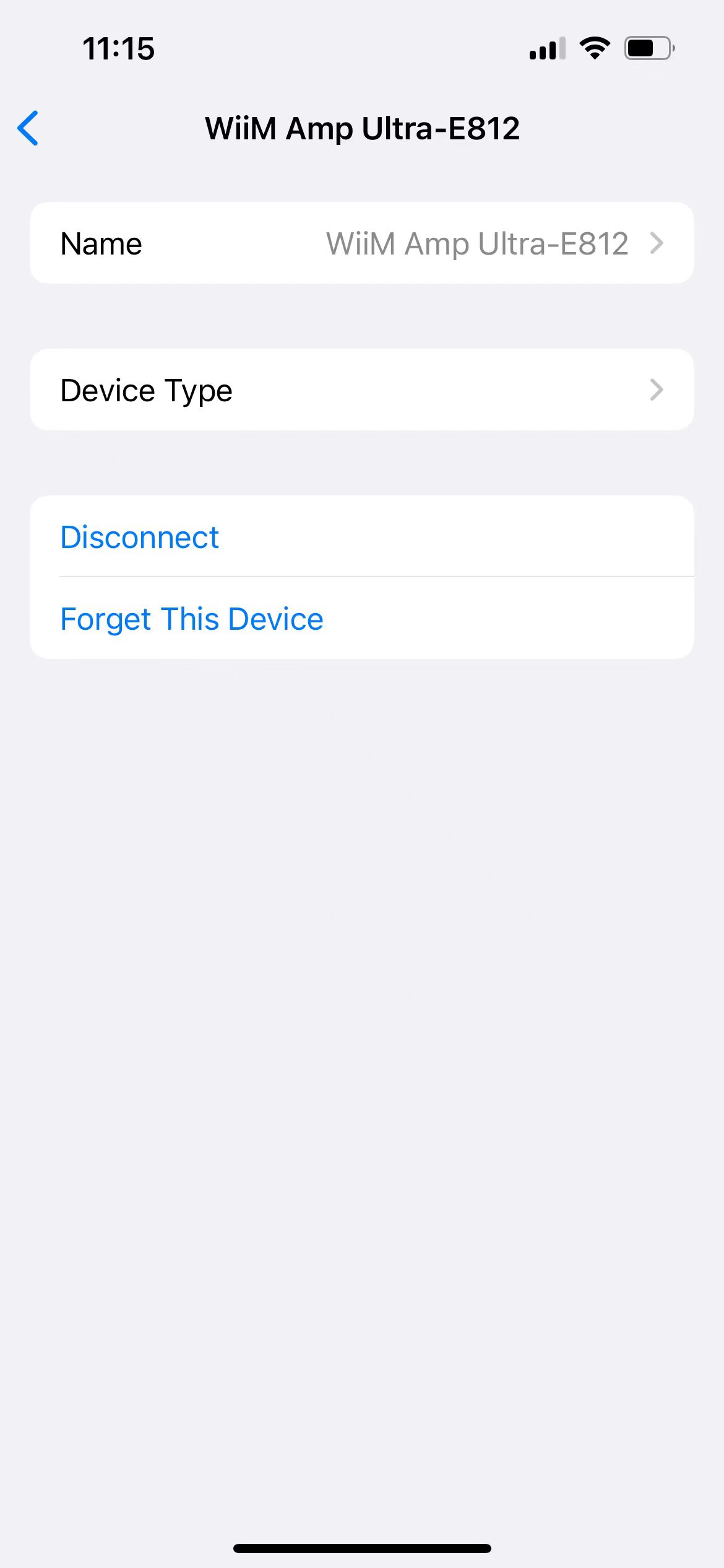

  2. Tap theicon next to the connected WiiM Amp Ultra.
  3. Tap Disconnect to close the Bluetooth connection with your WiiM Amp Ultra. Your WiiM Amp Ultra will appear as Not Connected on the mobile device.
