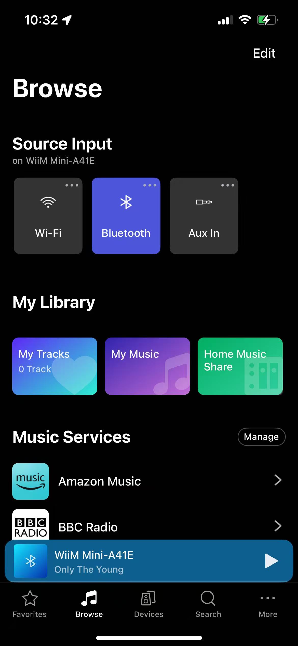

Choose one of the methods to switch to Bluetooth input:
  • Method 1: Open the WiiM Home app and select Bluetooth input in Browse tab.

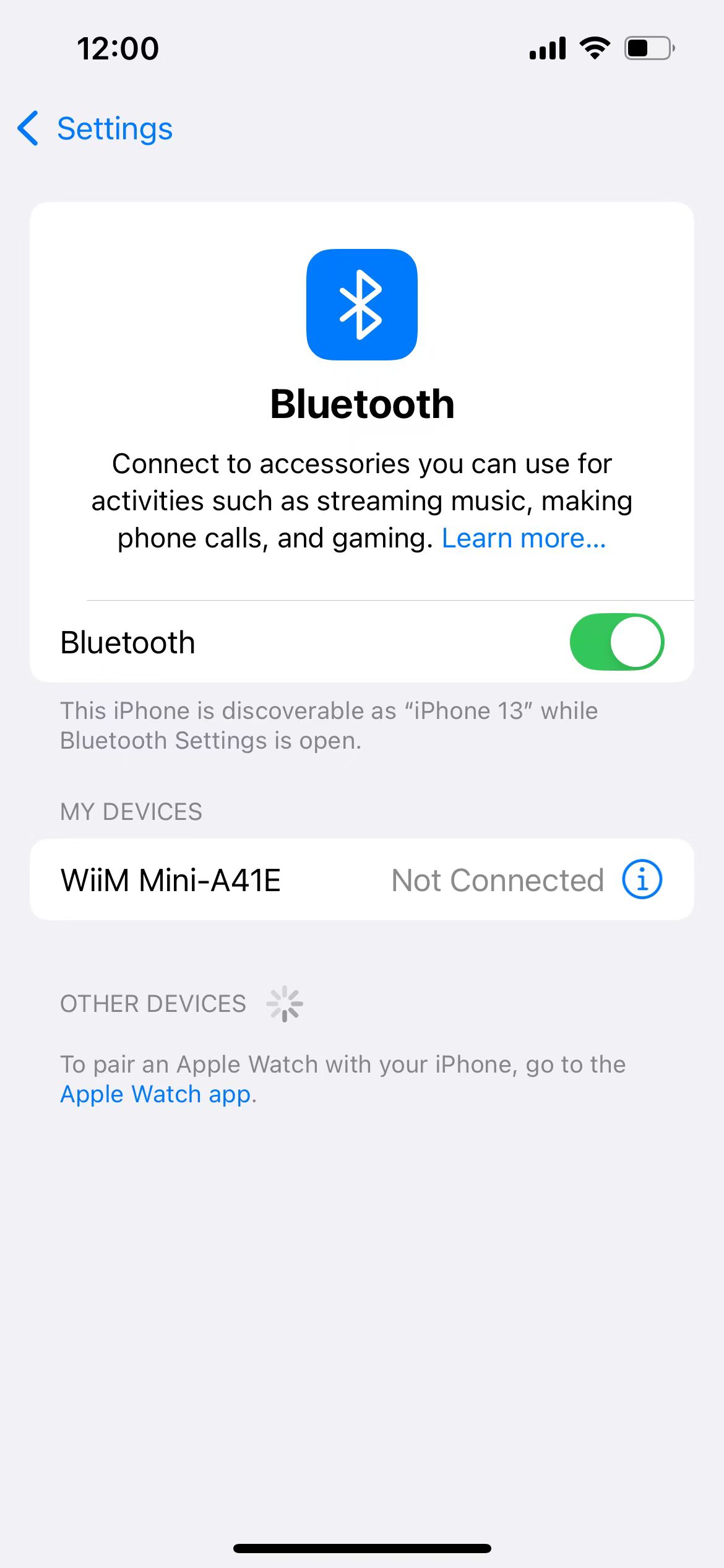

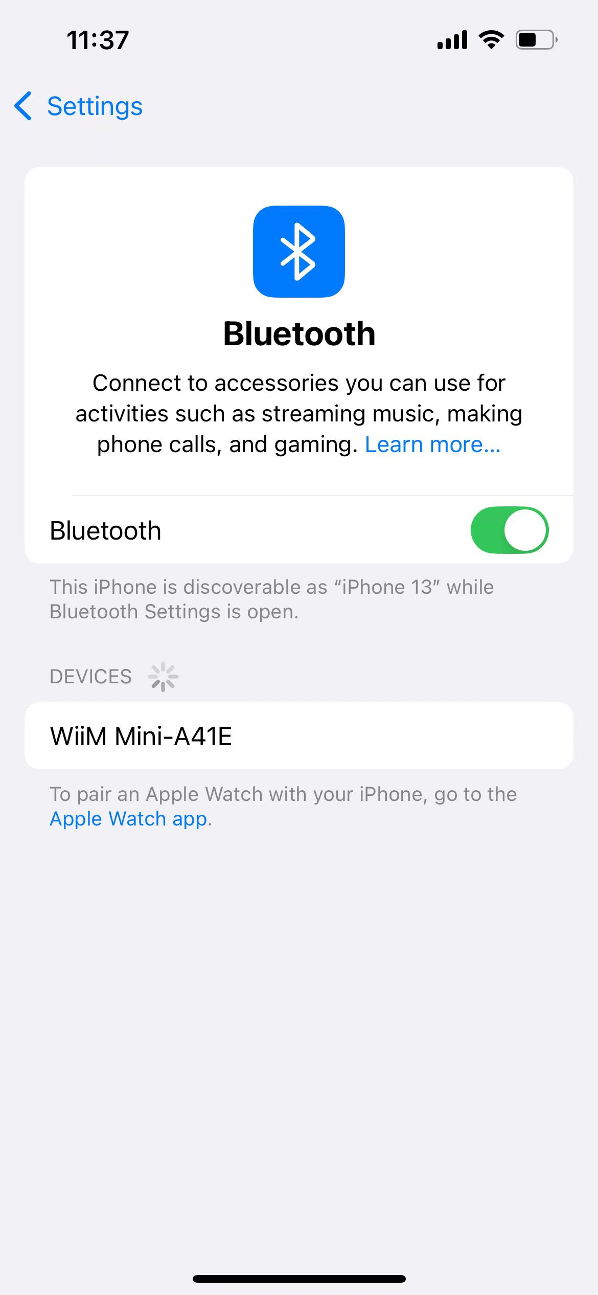

  1. Go to Settings on your mobile device and turn on Bluetooth. Your mobile device starts to search for available Bluetooth devices.
  2. When the WiiM Mini appears in the device list, select it to complete the pairing process.
     Once paired successfully, the LED indicator on the WiiM Mini will turn solid green.

  • Method 1: Open the WiiM Home app and select an input in Browse tab.

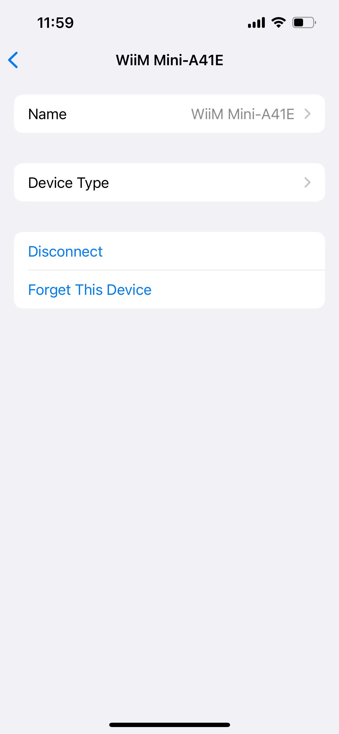

Option 2: Disconnect from Mobile Device
  1. Go to the Bluetooth setting on your mobile device.
  2. Tap theicon next to the connected WiiM Mini.
  3. Tap Disconnect to close the Bluetooth connection with your WiiM Mini. Your WiiM device will appear as Not Connected on the mobile device.
