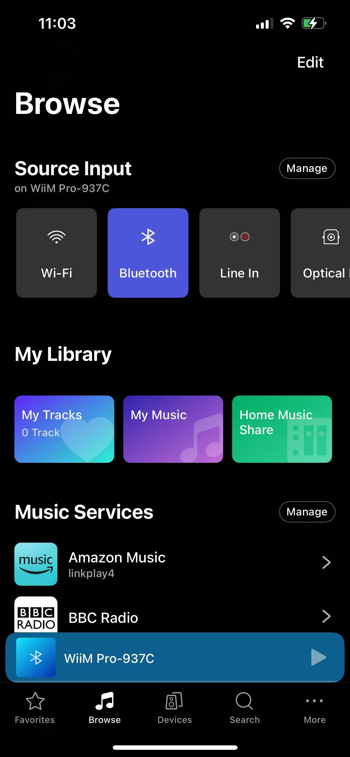

Option 1: Switch to Bluetooth Input
When using this option, the WiiM Pro/WiiM Pro Plus will first search for any paired mobile devices. If no device is paired or if the paired device is not found, it will enter Bluetooth pairing mode.
For Bluetooth re-pairing with a new mobile device, please turn off Bluetooth on the old mobile device before switching to the Bluetooth input.
Choose one of the method to switch to Bluetooth input:
- Method 1: Open the WiiM Home app and select Bluetooth input in Browse tab.
- Method 2: Press the Input Selection button

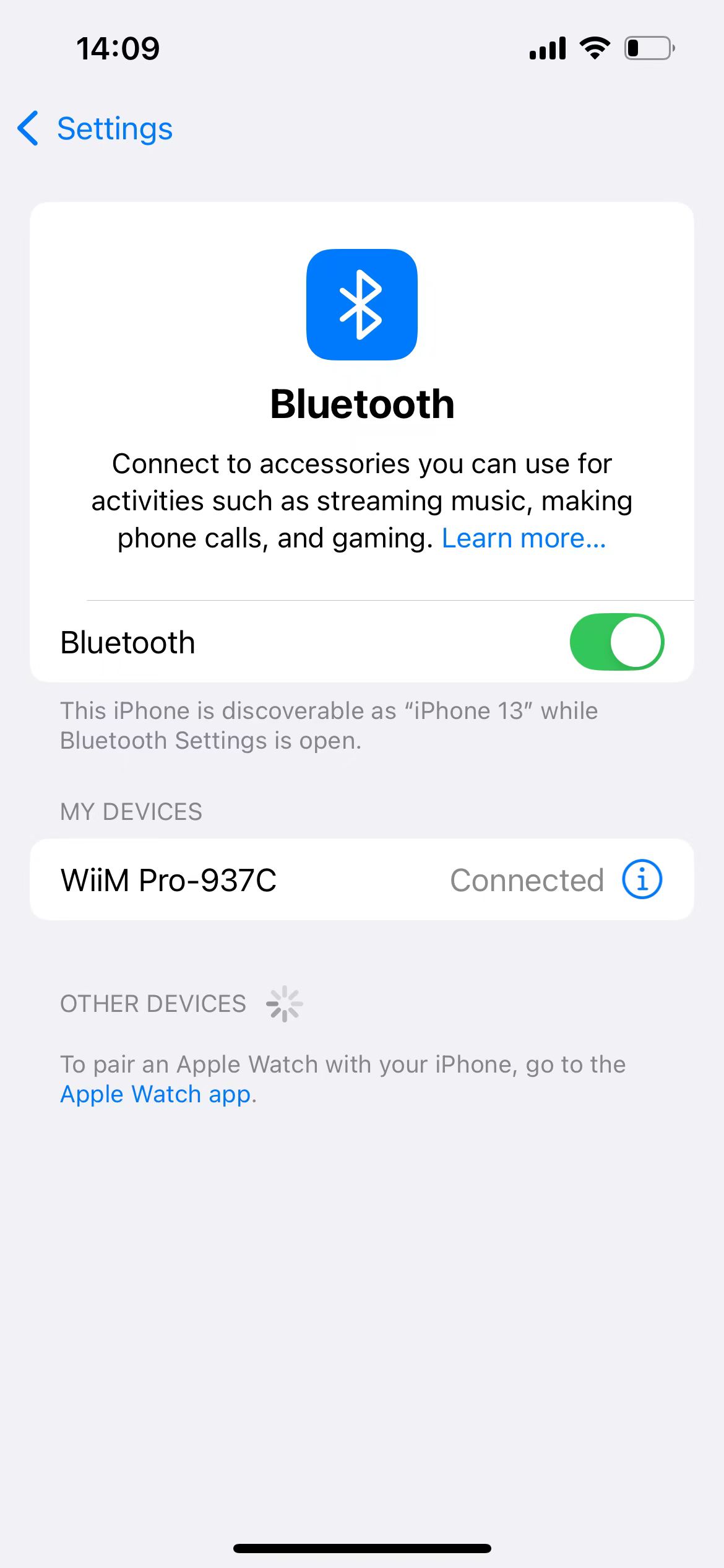

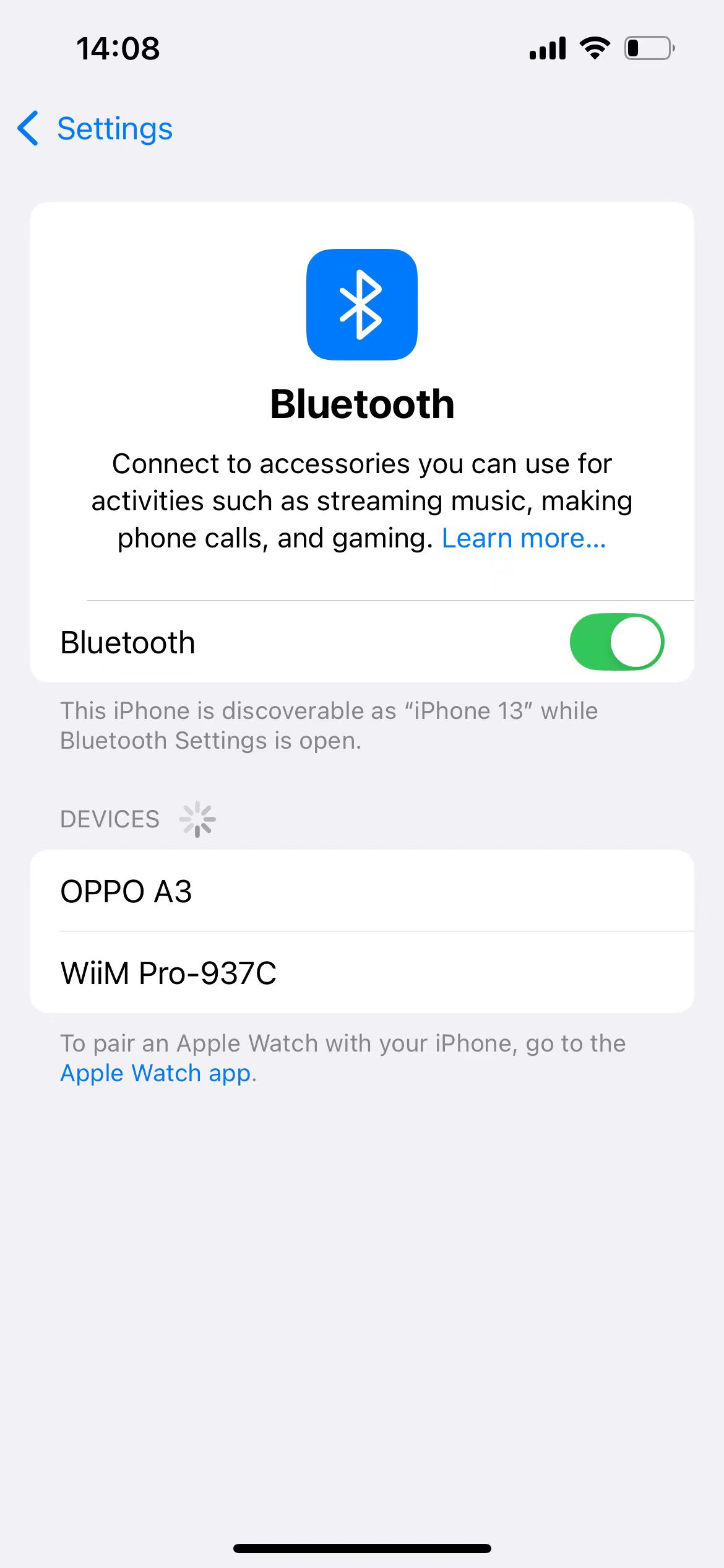

Step 2: Complete Pairing on Your Mobile Device
- Go to Settings on your mobile device and turn on Bluetooth. Your mobile device starts to search for available Bluetooth devices.
- When the WiiM Pro/WiiM Pro Plus appears in the device list, select it to complete the pairing process.
Once paired successfully, the LED indicator on the WiiM Pro/WiiM Pro Plus will turn solid green.

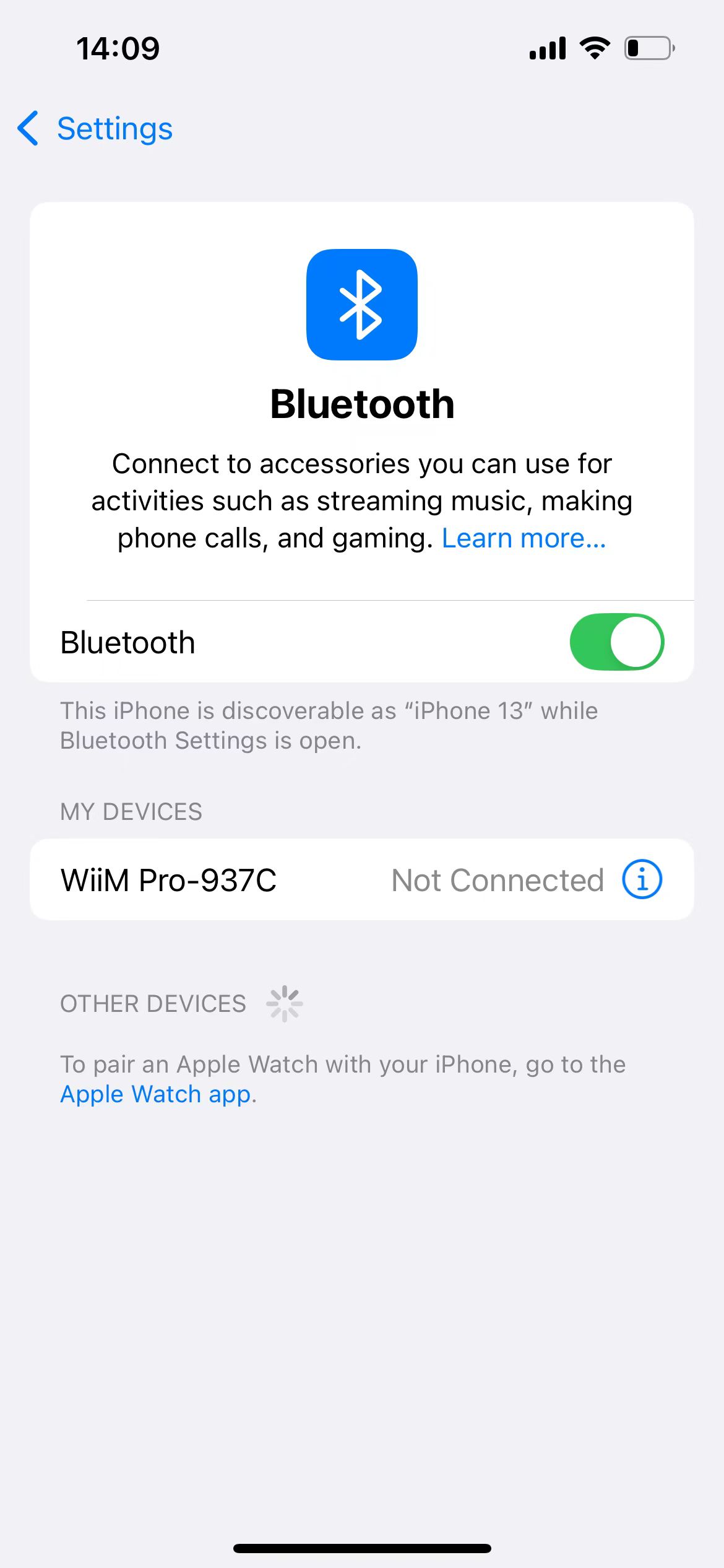

Option 2: Disconnect from Mobile Device
- Go to the Bluetooth setting on your mobile device.
- Tap the
icon next to the connected WiiM Pro/WiiM Pro Plus.
- Tap Disconnect to close the Bluetooth connection with your WiiM Pro/WiiM Pro Plus. Your WiiM device will appear as Not Connected on the mobile device.
