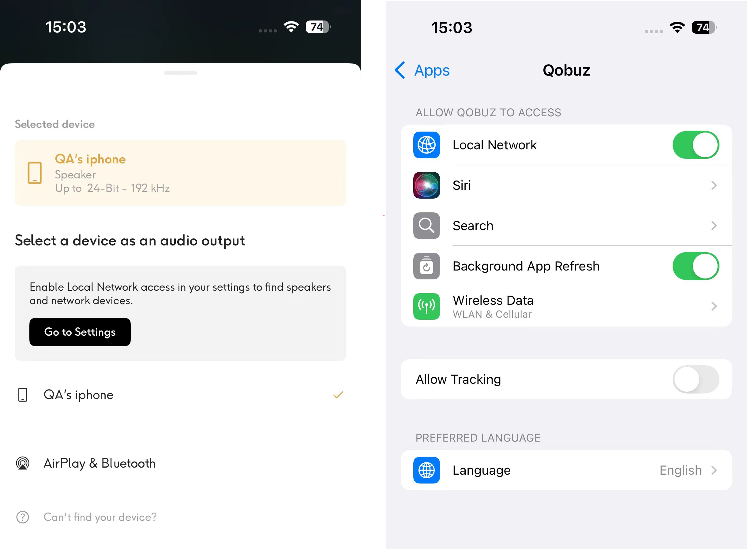

Troubleshooting: Device Not Found
When you try to select a WiiM device, the following prompt appears. Tap Go to Settings, and enable Local Network access for the Qobuz app.
