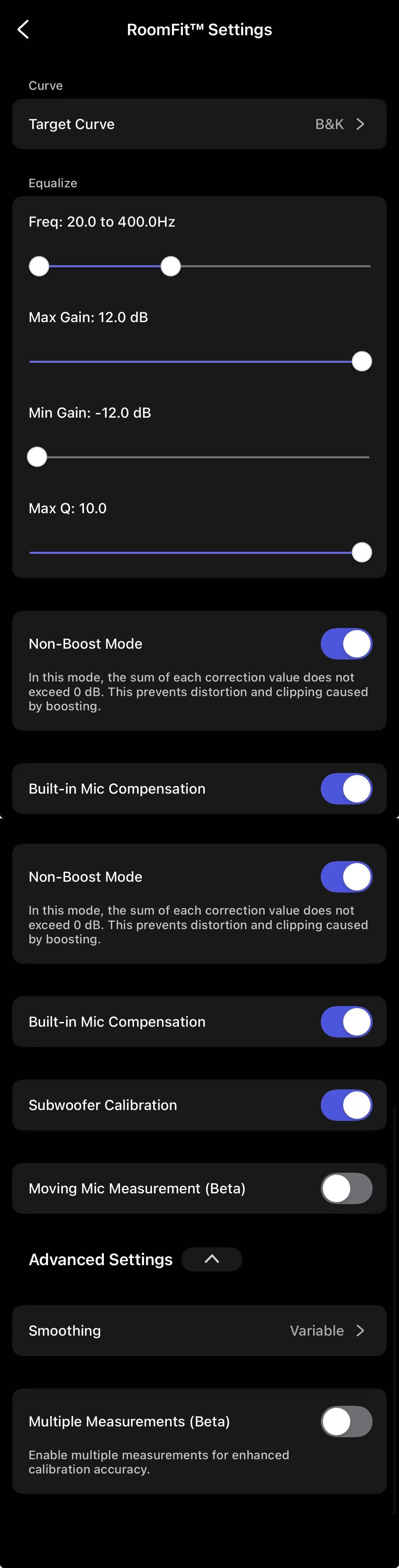

Refer to the screenshot or table below for the recommended RoomFit™ settings:
Recommended RoomFit™ Settings
Recommended RoomFit Settings screenshot
Target Curve: B&K
Freq: 20 Hz to 400 Hz
Note: If your subwoofer does not reach 20 Hz, use the lower frequency limit specified in the subwoofer's specification sheet instead.
Max Gain: 12 dB
Min Gain: -12 dB
Max Q: 10 (if no EQ boosts or positive filters are applied)
Max Q: 5 (if you want to be more conservative)
Note: Using 5 will make the adjustments less precise in reducing resonance peaks.
Non-Boost Mode: Enabled
Subwoofer Calibration: Enabled (if using a subwoofer)
Smoothing: Variable
Multiple Measurements (Beta): Disabled
Other Settings:
  • Moving Mic Measurement (Beta): Enabled (if spatial averaging is required)
    Note: This measurement method is more sensitive to environmental noise.
  • Room Correction Type: Individual Channel RoomFit™ (Select this type during the room correction process)
  • Import a calibration file if you have an externally calibrated measurement microphone. For details, see Tutorial: Microphone Calibration File Import in WiiM Home.
