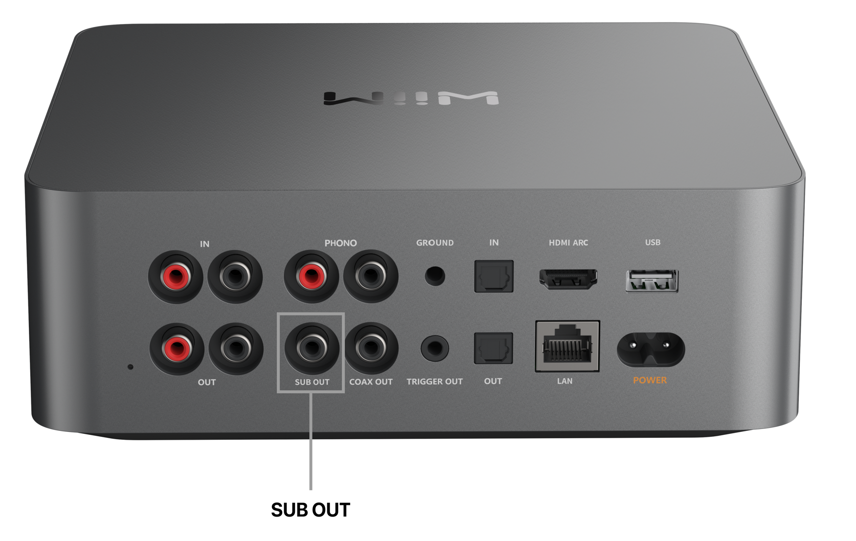

Step 1: Identify the Subwoofer Output
Locate the SUB OUT port on your WiiM Ultra, which is clearly labeled on the back panel.

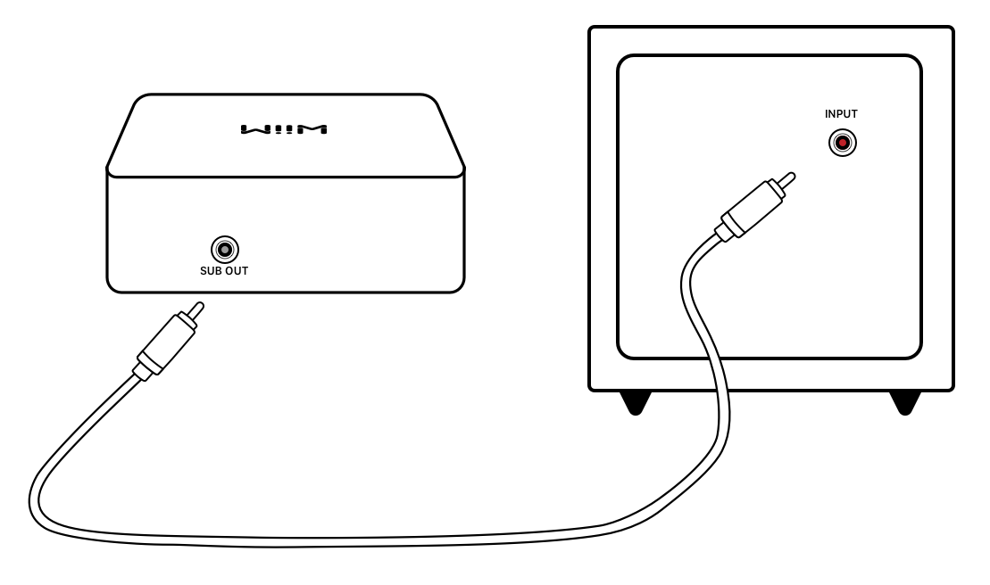

Step 2: Connect the Subwoofer
Follow these instructions to connect the subwoofer:
- Connect one end of an RCA cable to the SUB OUT port on your WiiM Ultra.
- Attach the other end of the RCA cable to the input on your powered subwoofer. If your subwoofer has two RCA inputs, opt for the one marked LFE or Mono.
Step 3: Power Up
Turn on your subwoofer first, then power up your WiiM Ultra.
