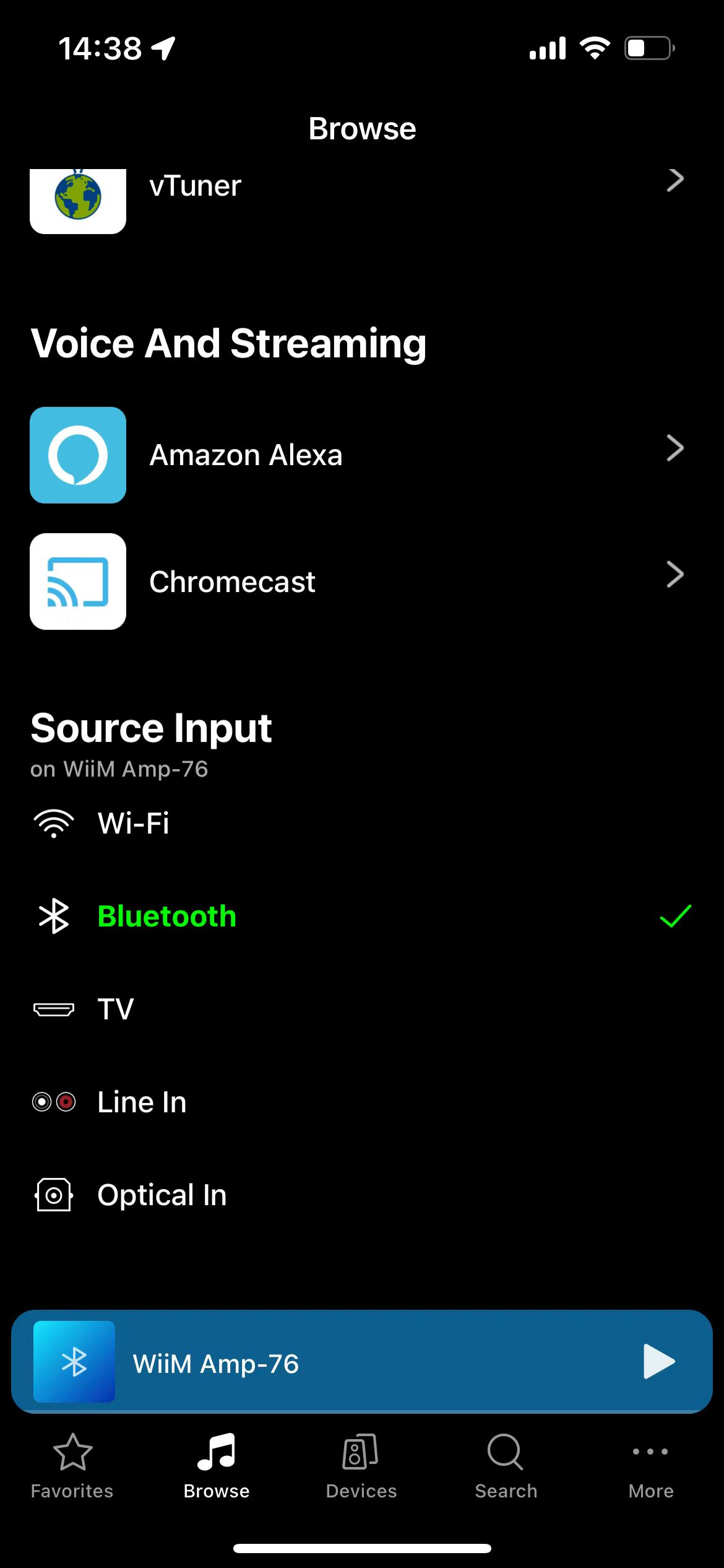

  • Option 1: Switch to Bluetooth input via these ways:
    • WiiM Home app
    • WiiM Voice Remote
  • Option 2: Simply press and hold the Play button on your WiiM Voice Remote for 3 seconds.
Tip: When entering Bluetooth pairing mode, the WiiM Amp's LED indicator will start flashing slowly in green while the WiiM Amp Pro's LED indicator will start flashing slowly in blue.

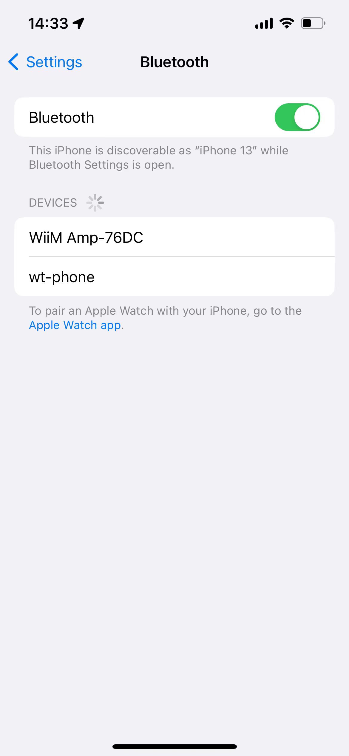

Step 2: Complete Pairing on Your Mobile Device
  1. Go to Settings > Bluetooth on your mobile device and turn it on.
  2. Tap the WiiM Amp or WiiM Amp Pro from the device list to pair.
  3. Once paired, the WiiM Amp's LED indicator will turn solid green while the WiiM Amp Pro's LED indicator will turn solid blue.

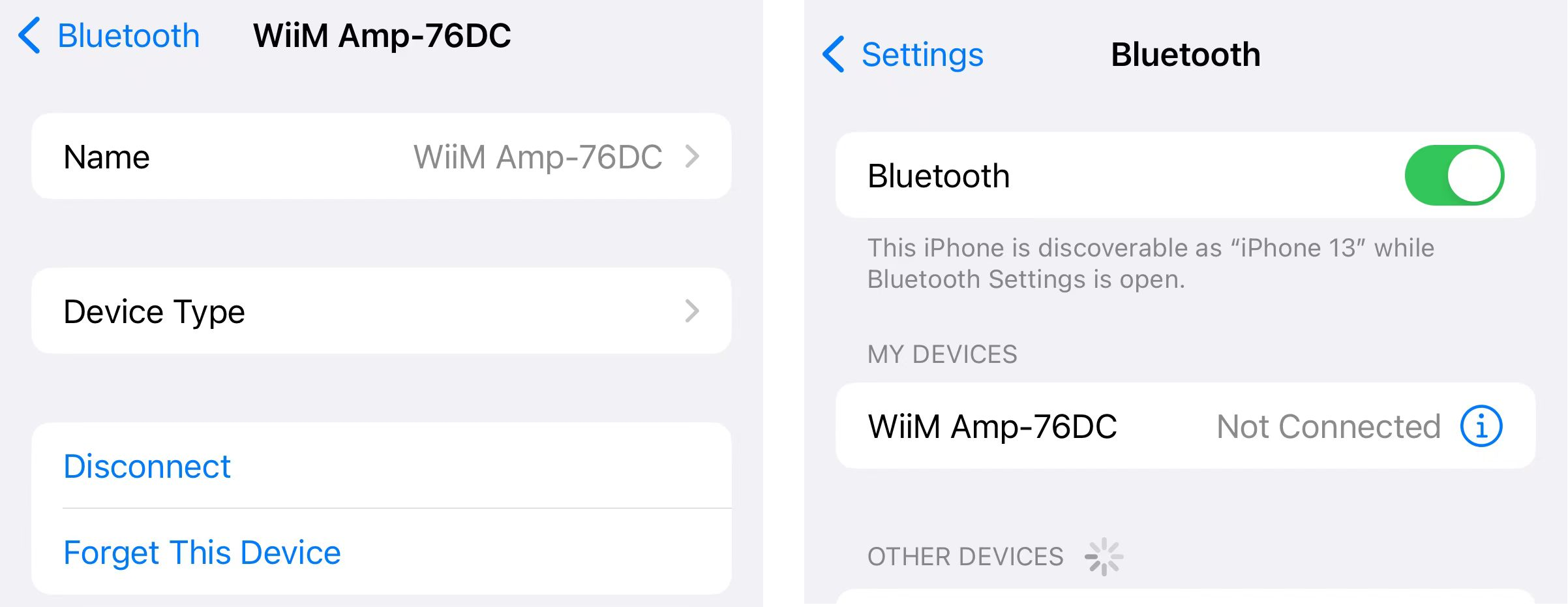

Bluetooth Re-pairing with a New Mobile Device
If you want to pair your WiiM Amp or WiiM Amp Pro with a new mobile device, follow these steps:
  1. Put the WiiM Amp or WiiM Amp Pro into pairing mode using one of the options below:
    • Option 1: Use the Enter Pairing Mode option in the WiiM Home app.
      For details, see Use "Enter Pairing Mode" to Quickly Pair a New Bluetooth Device.
    • Option 3: Turn off Bluetooth on the old mobile device first, then switch the WiiM Amp or WiiM Amp Pro to the Bluetooth input via the WiiM Home app or WiiM Voice Remote.
      Note: Since it cannot find the previously paired device, it will automatically enter Bluetooth pairing mode.
  2. Complete pairing on your new mobile device.

  • Option 3: Disconnect or reconnect from the mobile device's Bluetooth Settings.
