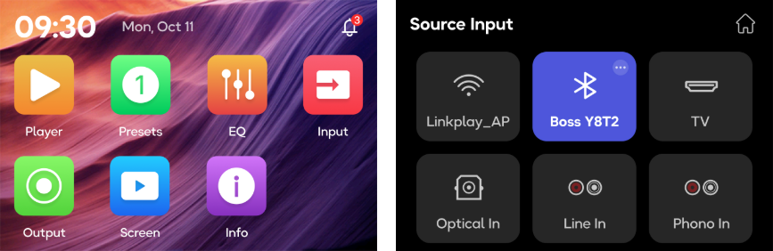

  • Method 1Open the WiiM Home app and select Bluetooth input in Browse tab.
  • Method 2Tap Input in your WiiM Ultra's screen and select Bluetooth input.
  • Method 3: Press the Input Selection buttonon the WiiM Voice Remote.

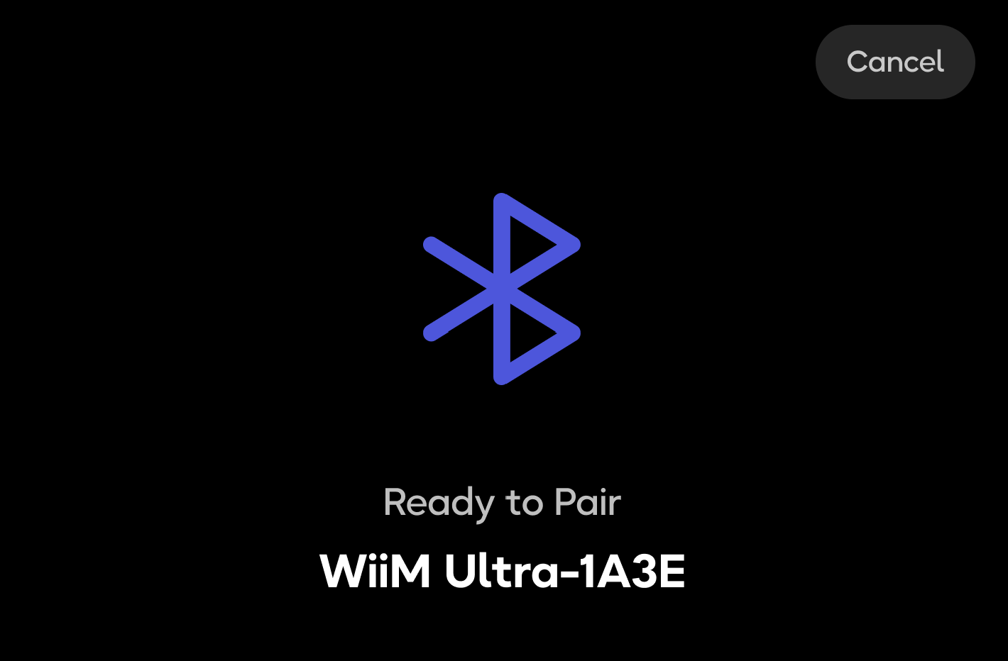

When using this option to initiate the Bluetooth pairing mode, the WiiM Ultra's LED indicator will start flashing slowly in green, and a prompt, similar to the one below, will appear on the WiiM Ultra's screen.
Option 2: Press and Hold the Play Buttonon the WiiM Voice Remote for 3 Seconds.
When using this option to initiate the Bluetooth pairing mode, you will see the WiiM Ultra's LED indicator flashing slowly in green.

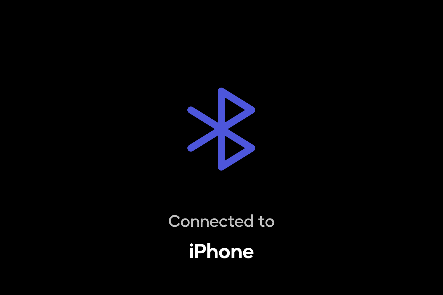

    Once paired successfully, the WiiM Ultra's LED indicator will turn solid green, and a prompt, similar to the one below, will appear on its screen, depending on the way to initiate Bluetooth pairing mode on the WiiM Ultra.
The LED indicator turns solid green only if Bluetooth pairing mode is initiated using Option 1.
The prompt on the WiiM Ultra's screen will appear only if Bluetooth pairing mode is initiated using Option 1 or Option 3.
