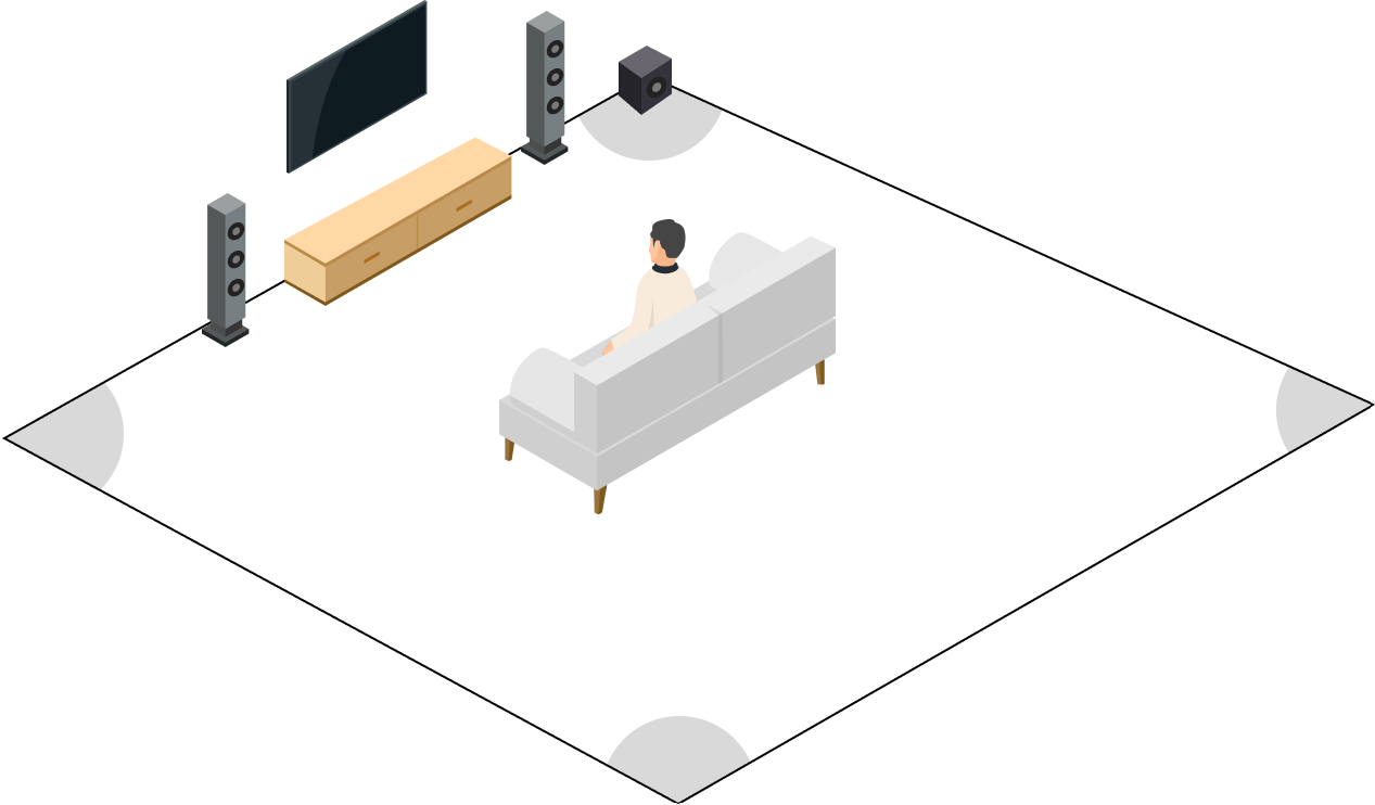

Step 1: Place Your Subwoofer Properly
You’ll typically get the best results by placing your subwoofer either at the front of the room or in a corner:
- Start by placing the subwoofer at the front of the room, close to your main speakers. This often provides the most natural and seamless blend with your overall sound.
- Alternatively, try placing the subwoofer in a corner. This can increase bass output by reinforcing low frequencies through room reflections. It often delivers fuller bass and helps reduce “dead spots” in the room.
If front placement or corner placement does not result in optimal bass response, move the subwoofer around the room to determine the best placement locations.
