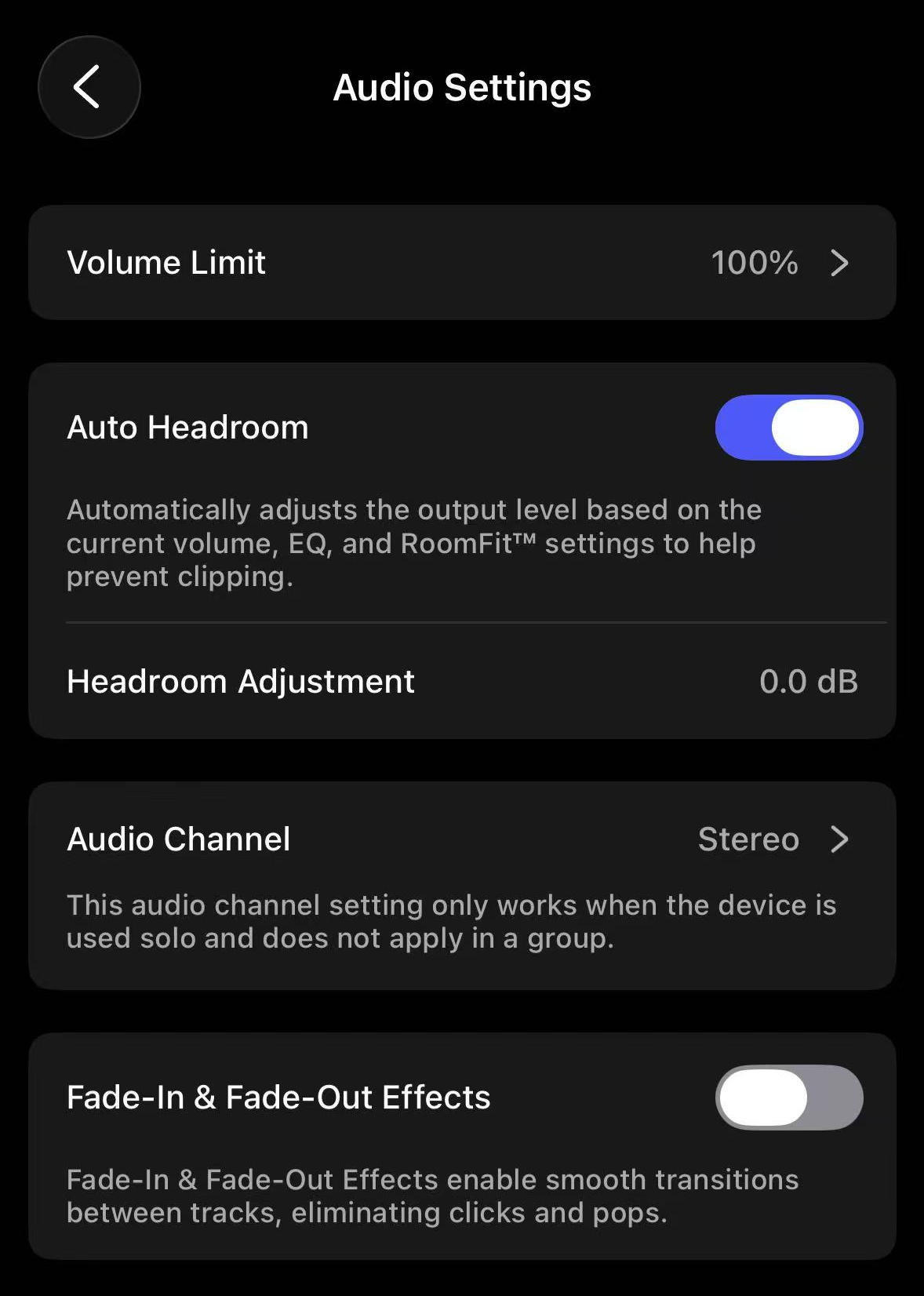

1. Disable Fade-In & Fade-Out Effects
Steps:

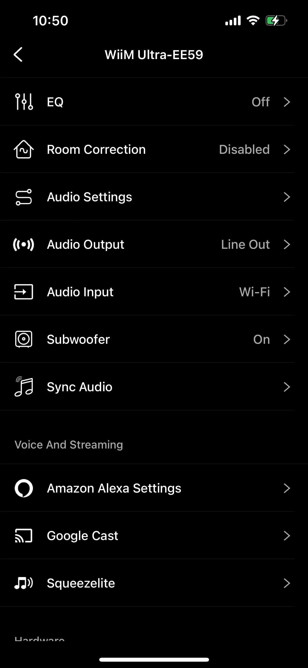

  1. Open the WiiM Home app on your mobile device.
  2. Go to the Devices tab, and tap the Device Settings Device Settings icon of your WiiM device.
  3. Select Audio Settings, then disable Fade-In & Fade-Out Effects at the bottom of the screen. Fade-In & Fade-Out Effects settings

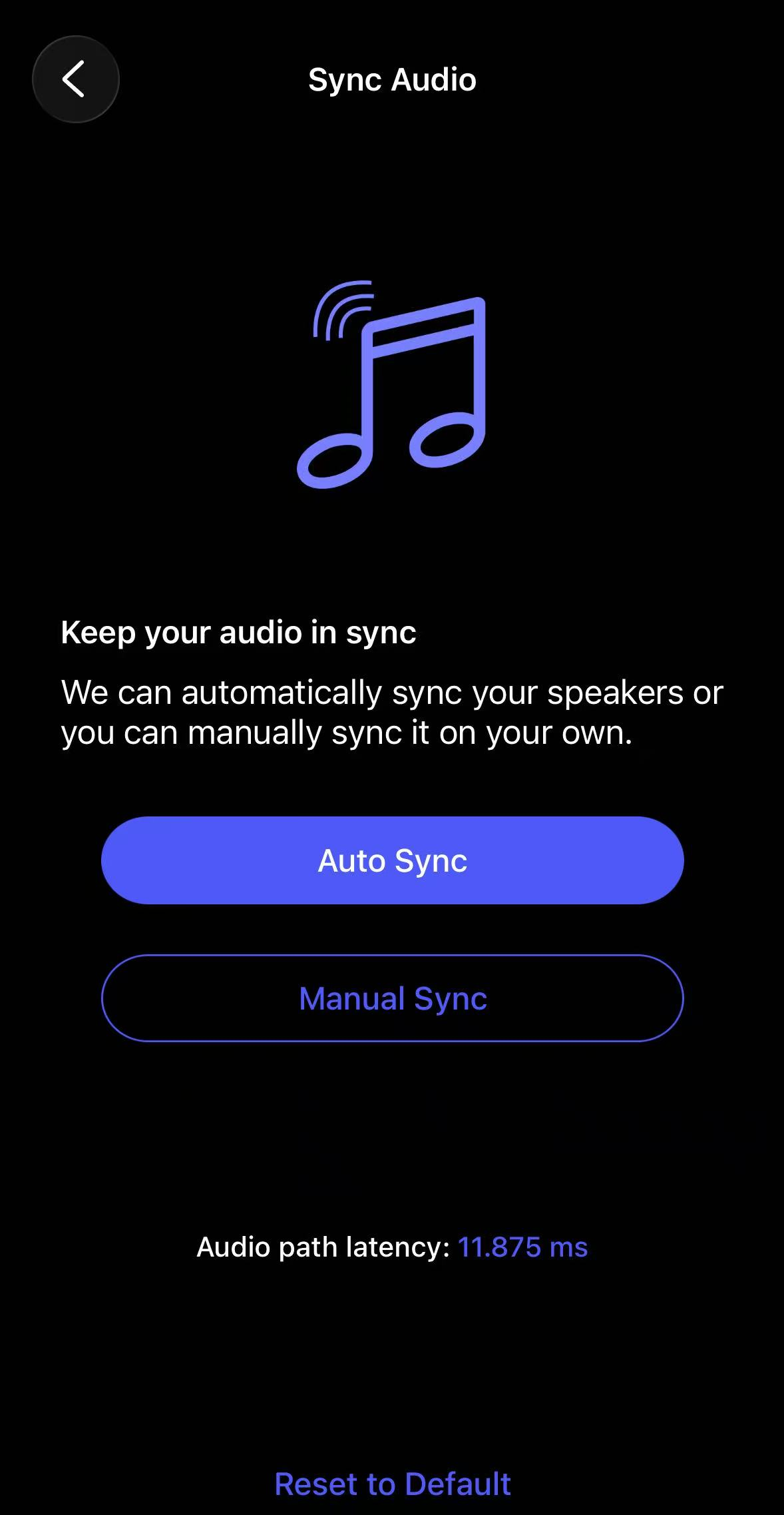

2. Sync Audio
Steps:
  1. Go to Device Settings of your WiiM device in the WiiM Home app.
  2. Select Sync Audio in the Sound section.
  3. Select Auto Sync or Manual Sync to adjust the best latency setting for your setup. Sync Audio settings
For more details about Auto Sync and Manual Sync, see Adjust Delay under the multi-room mode.
