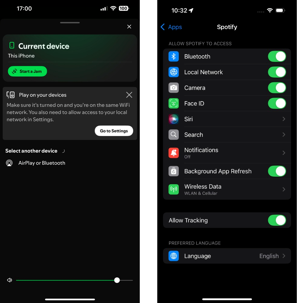

1. Enable Local Network Access
If you see the following message on the Spotify screen, tap Go to Settings, and then enable the Local Network permission for the Spotify app.

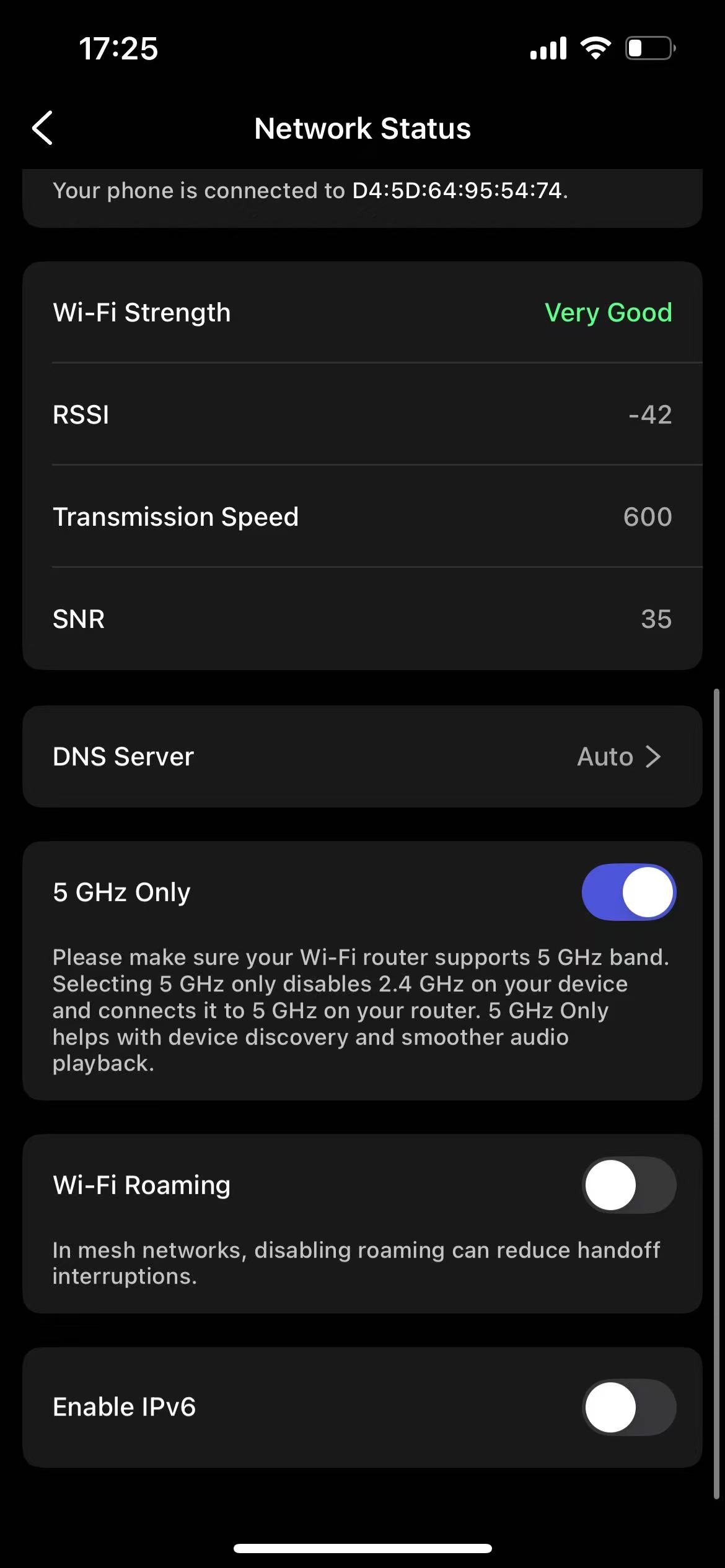

3. Modify IPv6 and DNS Settings in the WiiM Home App
  1. Open the WiiM Home app.
  2. Go to the Devices tab > Device Settings > Network Status.
  3. Toggle off the Enable IPv6 setting, then have a try.
  4. If the issue remains, try changing the DNS Server setting.
    For detailed instructions, see How to Configure the DNS Server in WiiM Home App for Faster Streaming.

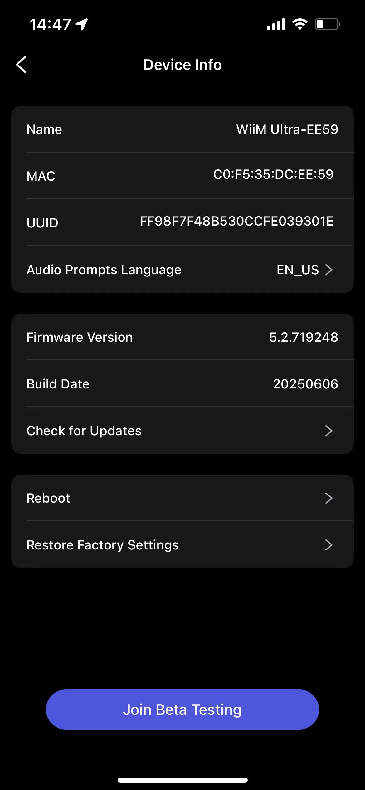

5. Update WiiM Firmware
Open the WiiM Home app and check for firmware updates.
