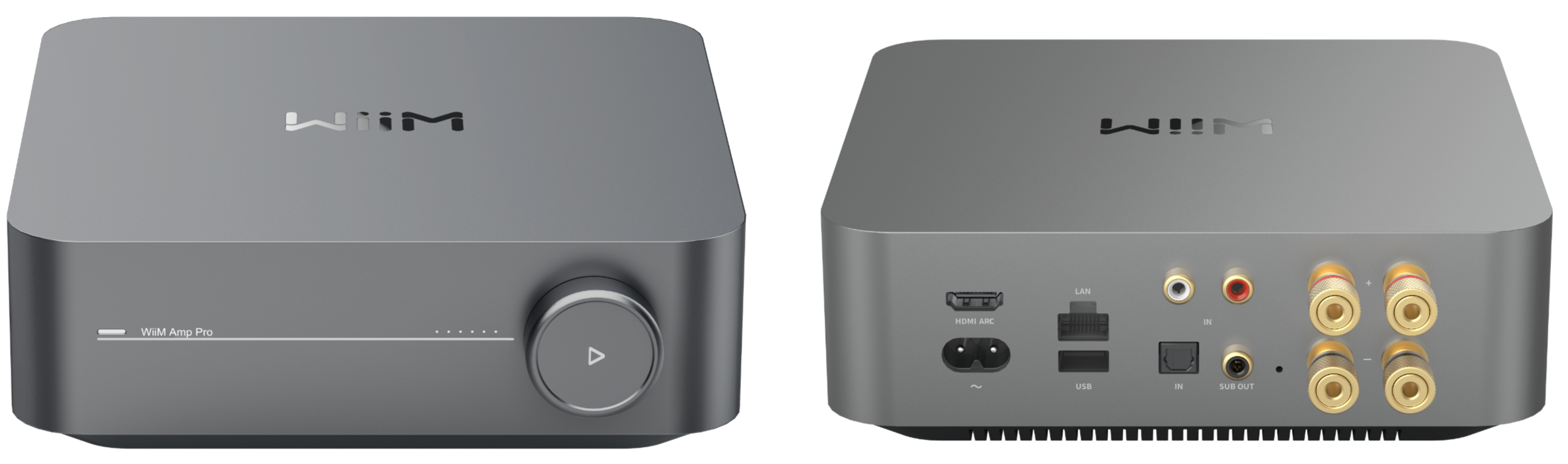

2. Connect the Audio Output of the WiiM Amp or WiiM Amp Pro

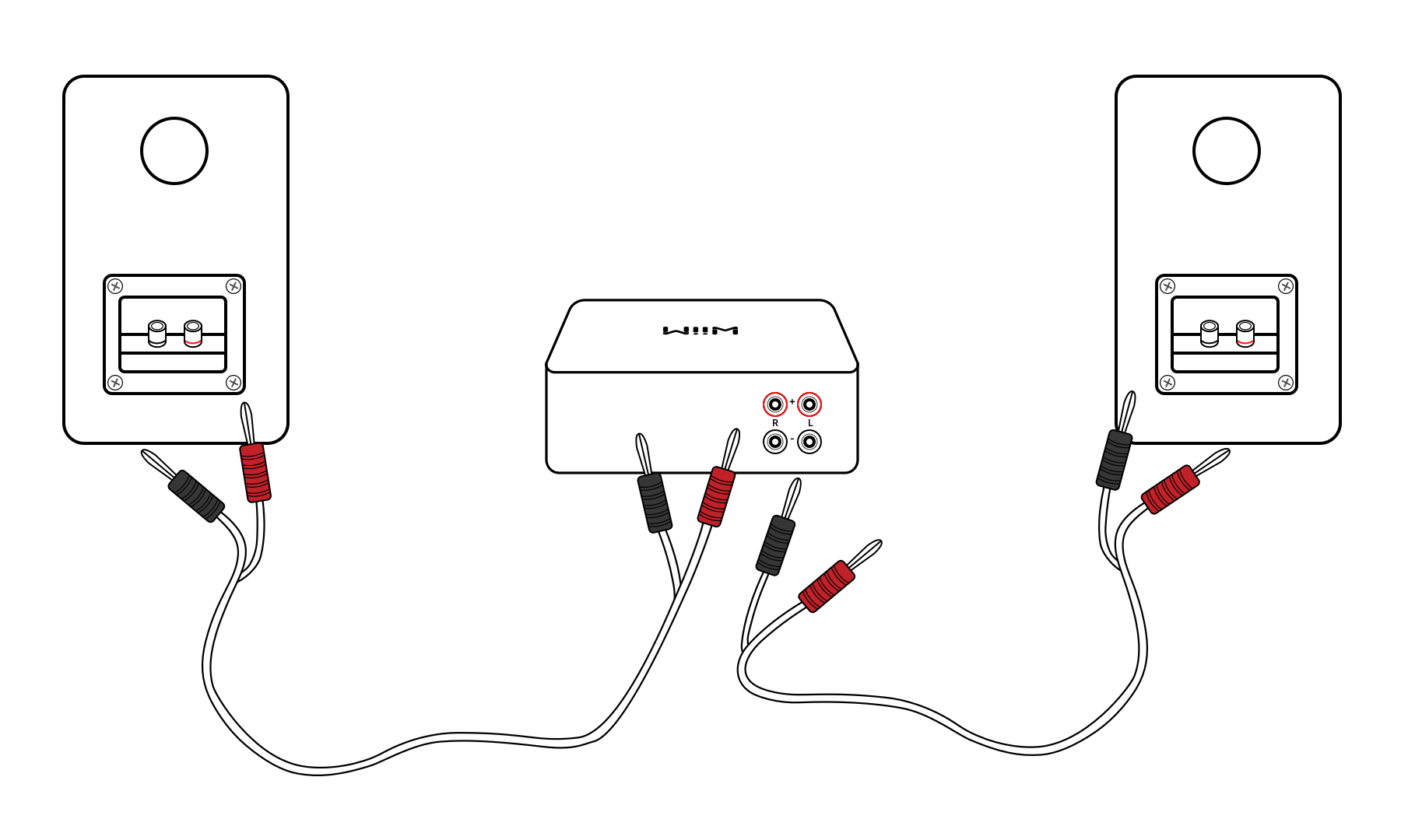

- Connect the WiiM Amp or WiiM Amp Pro to passive speakers (Left and Right) using the speaker cables (banana plugs or wired).

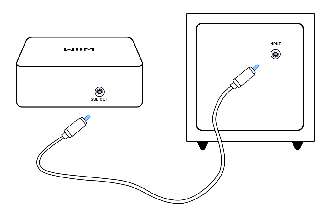

- Optionally, connect the WiiM Amp or WiiM Amp Pro to a powered subwoofer using an RCA cable. For details, see How to Connect Your Subwoofer with the WiiM Amp or WiiM Amp Pro.

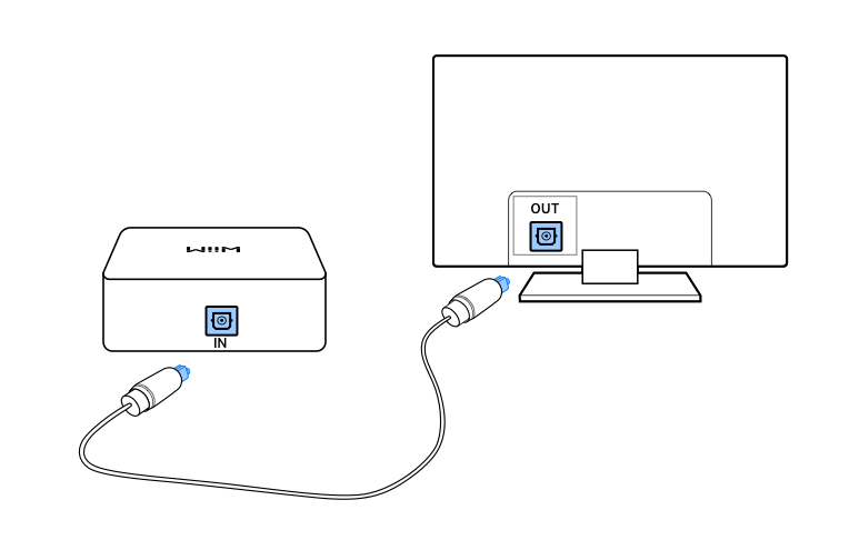

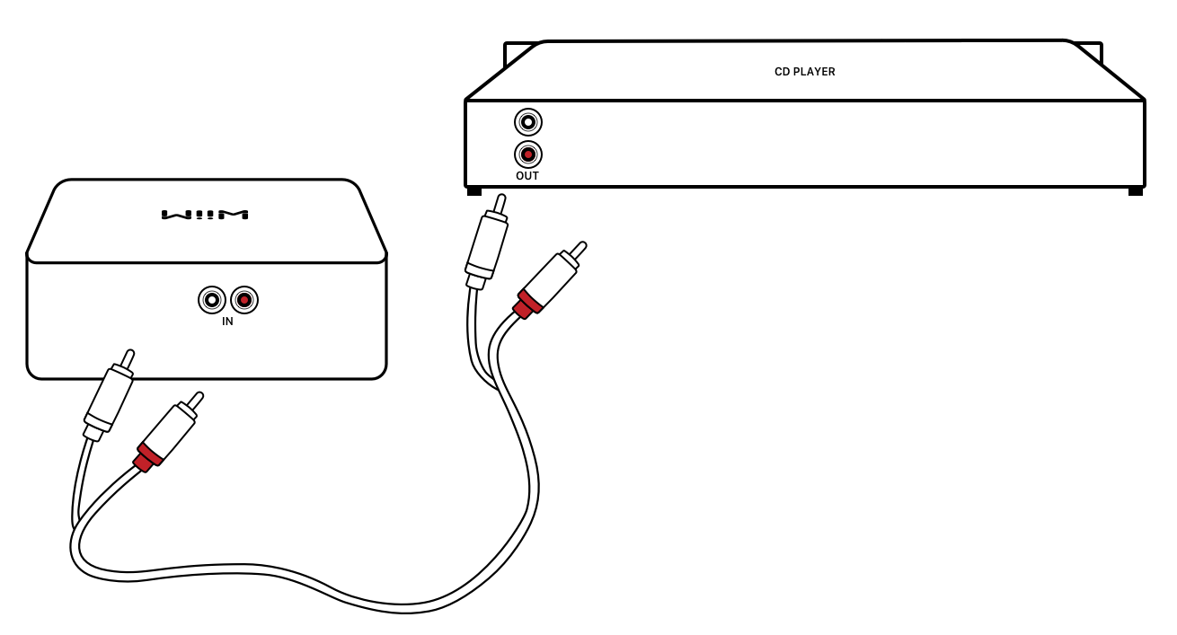

3. Connect the Audio Input of the WiiM Amp or WiiM Amp Pro (Optional)

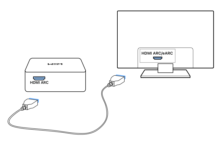

Optionally, connect the WiiM Amp or WiiM Amp Pro to an audio input source (e.g., CD player, PC or TV) via Line In, Optical In, or HDMI ARC.
- Via Line In
- Via Optical In:
- Via HDMI ARC:
For detailed instructions, see How To Use Audio Input Ports of the WiiM Amp or WiiM Amp Pro.

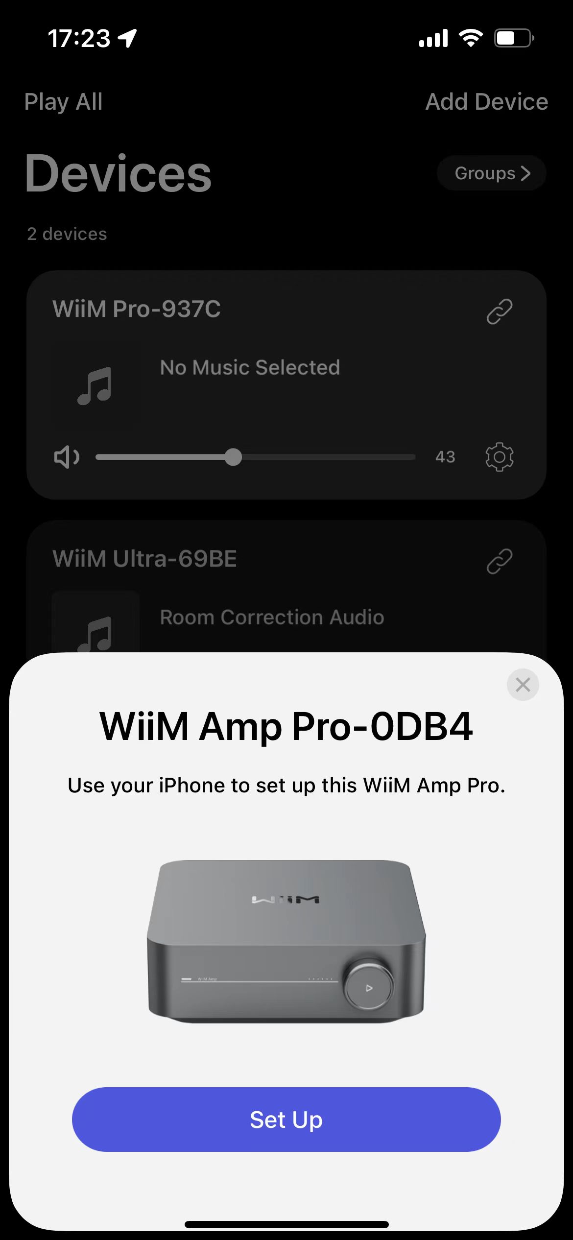

6. Set Up the WiiM Amp or WiiM Amp Pro through the WiiM Home App
- Open the WiiM Home app on your smartphone or tablet.
- When your device appears in the app, tap Set Up to start the process.
Note: If your WiiM device doesn’t appear automatically, go to the Devices tab and tap Add Device in the top-right corner to trigger the setup page. - Follow the on-screen instructions to complete the setup process. During setup, you'll connect the WiiM Amp or WiiM Amp Pro to the Wi-Fi network, check for firmware updates, and pair the WiiM Voice Remote.
