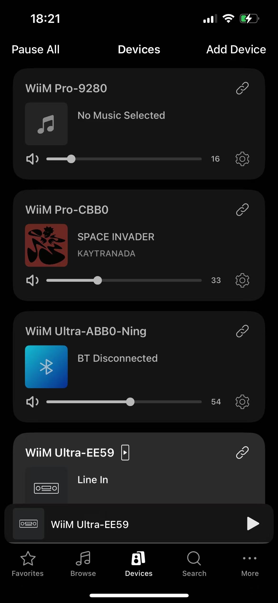

6. Set Up the WiiM Amp or WiiM Amp Pro through the WiiM Home App
- Open the WiiM Home app on your smartphone or tablet.
- When your device appears in the app, tap Set Up to start the process.
Note: If your WiiM device doesn’t appear automatically, go to the Devices tab and tap Add Device in the top-right corner to trigger the setup page. - Follow the on-screen instructions to complete the setup process. During setup, you'll connect the WiiM Amp or WiiM Amp Pro to the Wi-Fi network, check for firmware updates, and pair the WiiM Voice Remote.
For detailed setup instructions, refer to this video.
