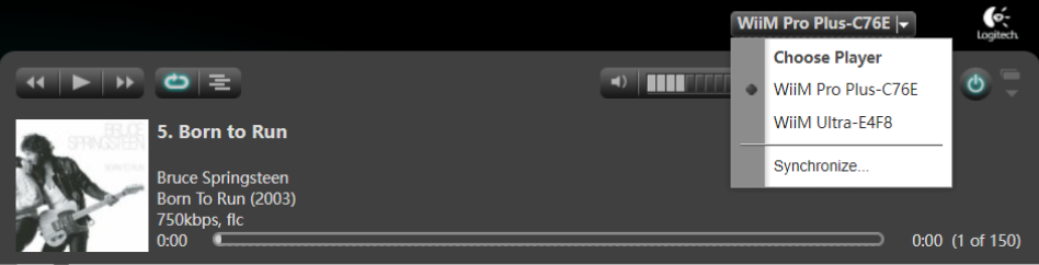

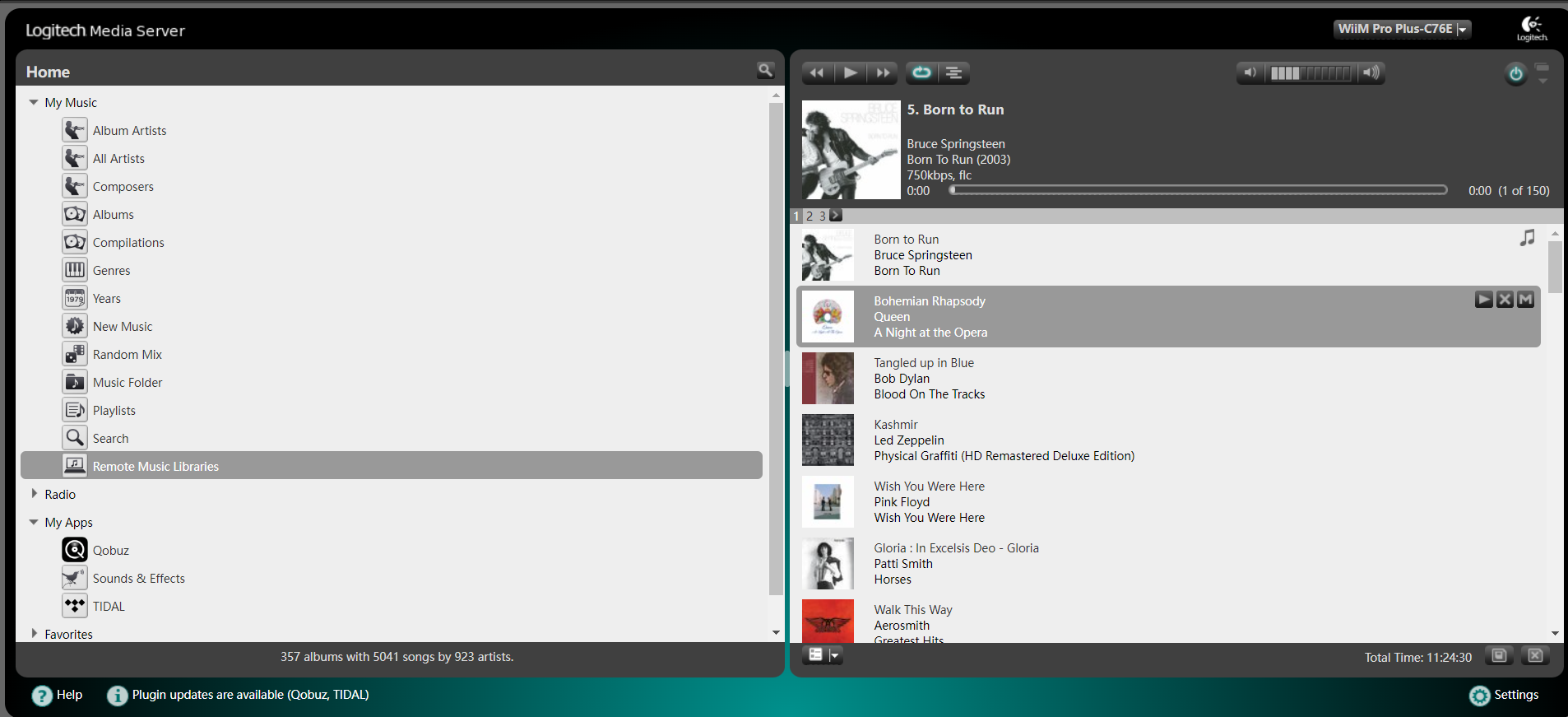

  1. Open an LMS-compatible controller, such as the LMS web interface, iPeng, Squeezer, or other LMS-compatible apps.

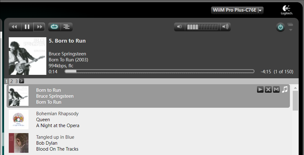

  2. Choose your WiiM device and start playback.
  3. From LMS, you can directly control playback (e.g., play, pause, adjust volume, or skip tracks).
