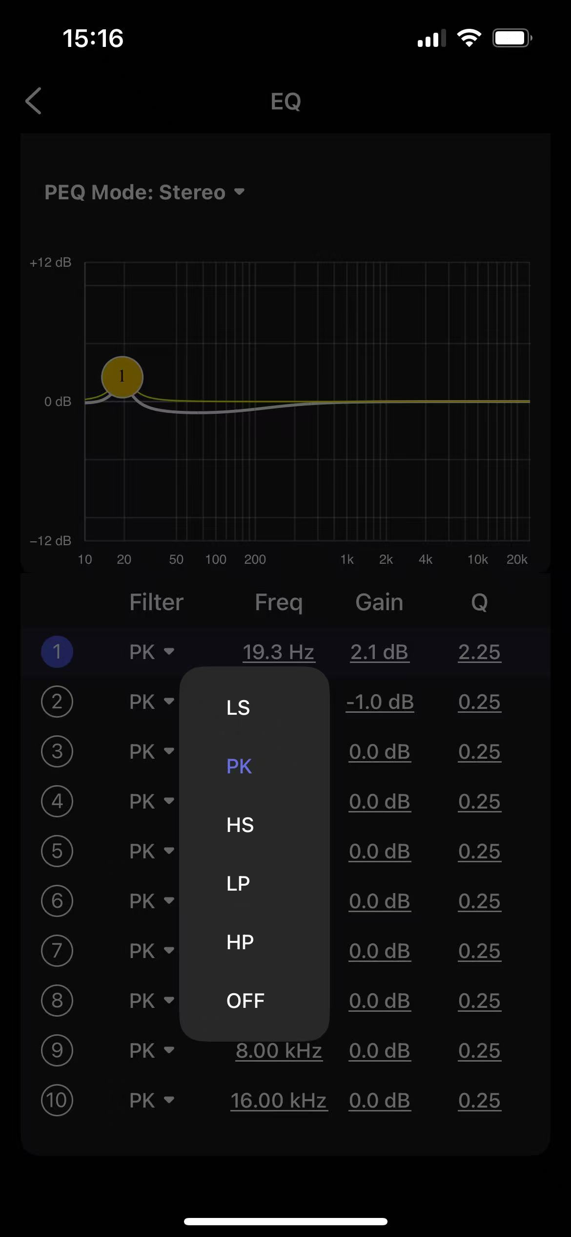

  1. Open the WiiM Home app on your mobile device.
  2. Go to the Devices tab > Device Settings > EQ. For other ways to access EQ, see How to Access EQ.
  3. Select an audio source you want to customize, switch to the Parametric EQ tab, and select your preferred PEQ mode (Stereo or L/R).
    Tip: Choose Stereo to apply the same EQ to both channels, or L/R to adjust the left and right channels independently.

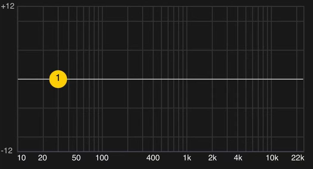

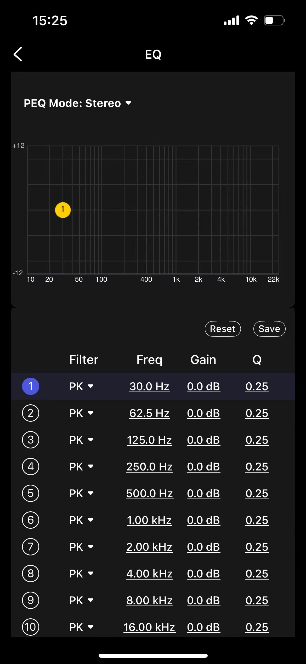

  4. Tune your EQ bands: Tap any band (1-10) to activate it, then tap any parameter field (Filter, Freq, Gain, or Q) to select or enter values manually.
    Tips:
    • Select a PEQ preset to use as is, or use it as a starting point and fine-tune the settings to your preferences.
    • When a band is selected, the corresponding numeric indicator will appear in the graph. You can drag the numeric indicator directly on the graph to visually adjust both Frequency and Gain in real-time.
    Note: We've integrated an advanced algorithm to prevent clipping issues, so high gain adjustments in the Graphic EQ or Parametric EQ won't cause clipping.
  5. When finished, tap Save to store your custom profile for future use or for other functions, such as Presets.
