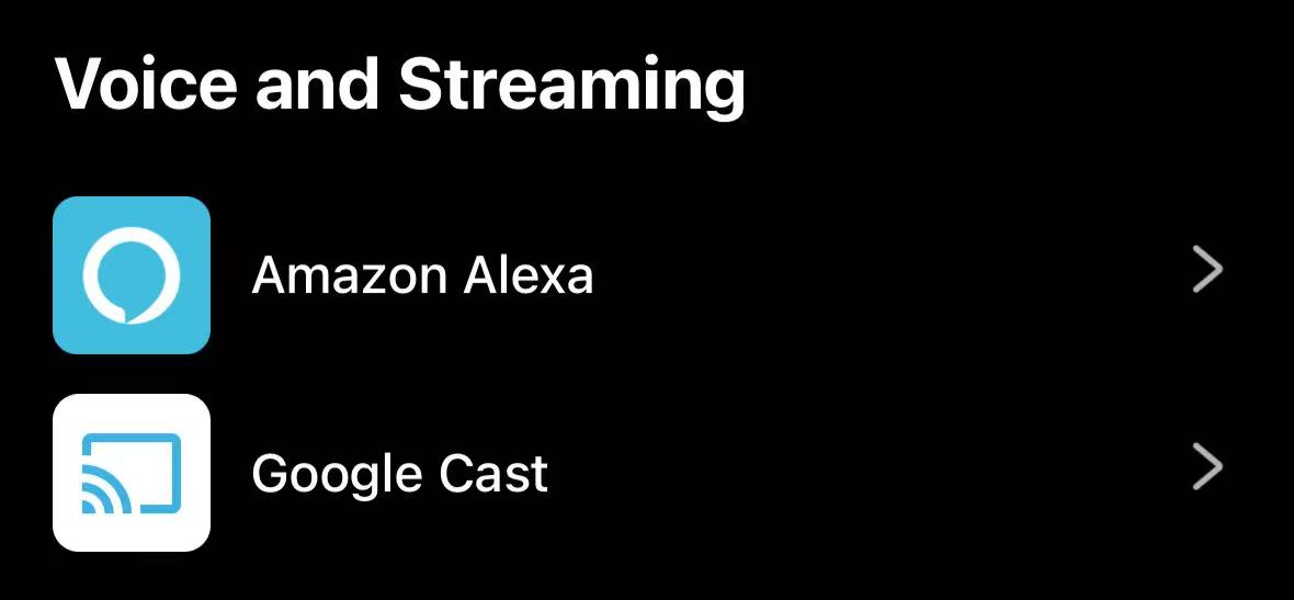

To use the Chromecast audio on the WiiM Pro, please help enable the Chromecast audio with the WiiM Home App. I've included the detailed steps below.
  1. Enable it when you set up the device with the WiiM Home App.
2. Enable it when you already connect the device to the network. Go to the WiiM Home App > Device tab > Tap the device setting gear icon > Chromecast audio.
