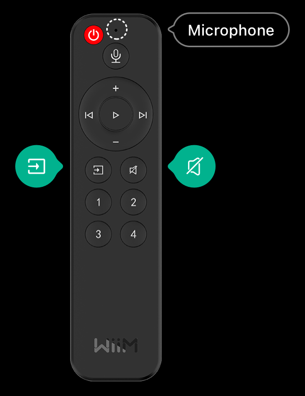

  1. Put the remote into the pairing mode by pressing and holding the Source and Mute buttons for two or more seconds simultaneously.
    The remote doesn't have an LED indicator. The opening above the MIC button serves as a microphone port, not as an LED feature.
