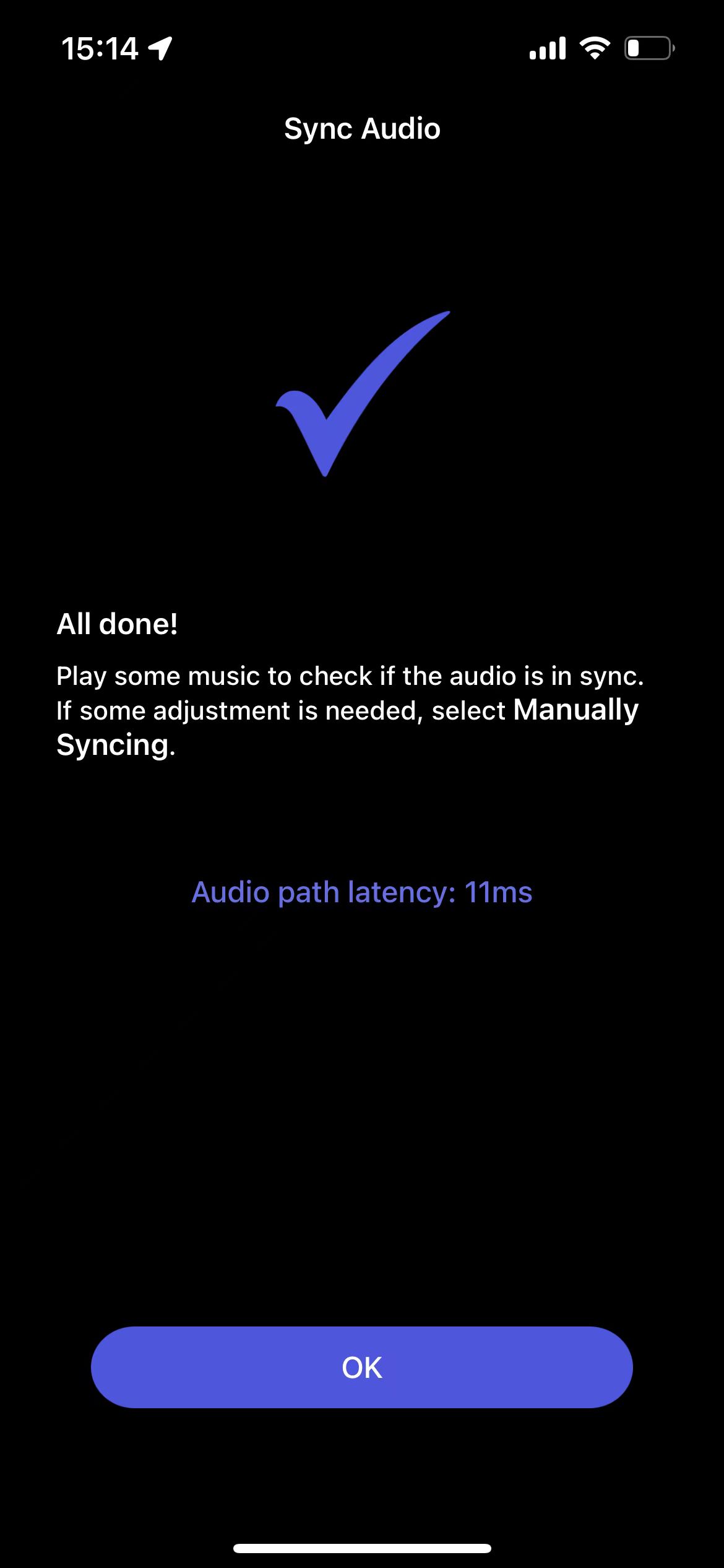

How to Use Auto Sync
  1. Turn up the volume of your speaker.
  2. Open the WiiM Home app on your mobile device.
  3. Go to the Devices tab, then tap the Device Settings icon of the WiiM device.
  4. Select Sync Audio in the Sound section.
  5. Tap Auto Sync.
  6. Wait for the process to complete. Itmay take 30 seconds.
