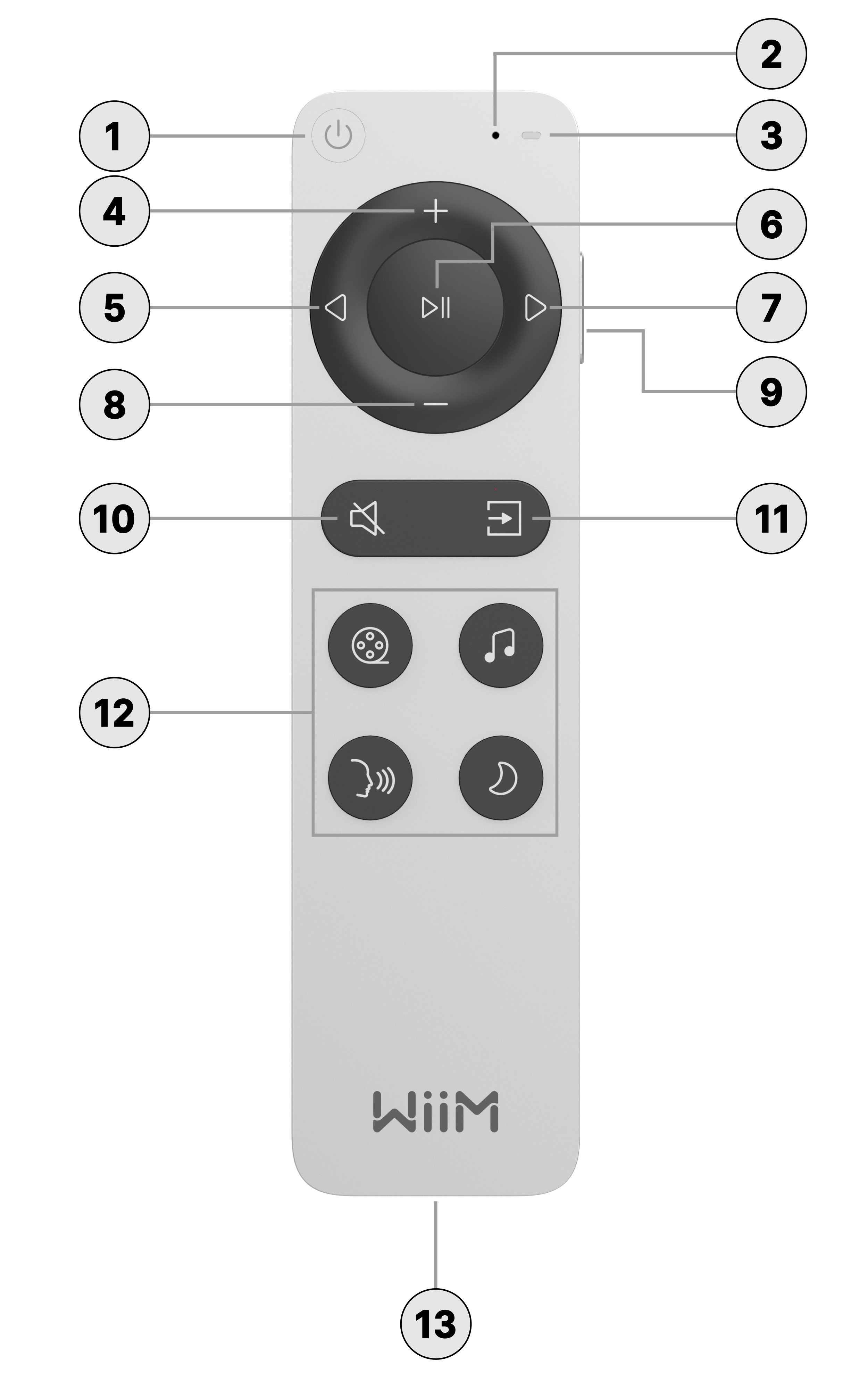

Each control on the WiiM Bar Remote is explained below:
Standby Press to put the WiiM Bar into standby mode.
Microphone Captures voice commands.
LED Indicator Displays the operational status of the WiiM Bar Remote. See LED Status Lights for details.
Volume Up Press to increase the volume.
Previous Press to go to the previous track or restart the current track.
Play/Pause Press to start or pause the current playback.
Next Press to go to the next track.
Volume Down Press to decrease the volume.
Alexa Voice Control Located on the right-hand side of the remote; press and hold to give Alexa voice commands.
Mute/Unmute Press to mute or unmute the speakers.
Source Switch Press to change the input source.
Sound Modes Switch between four preset sound modes: Movie, Music, Voice, and Night.
WiiM Bar Remote sound mode buttons: Movie, Music, Voice, and Night See Understanding Dolby and DTS Sound Modes on Your WiiM Bar for details.
USB-C Port Connect a USB-C cable to this port to charge the remote.

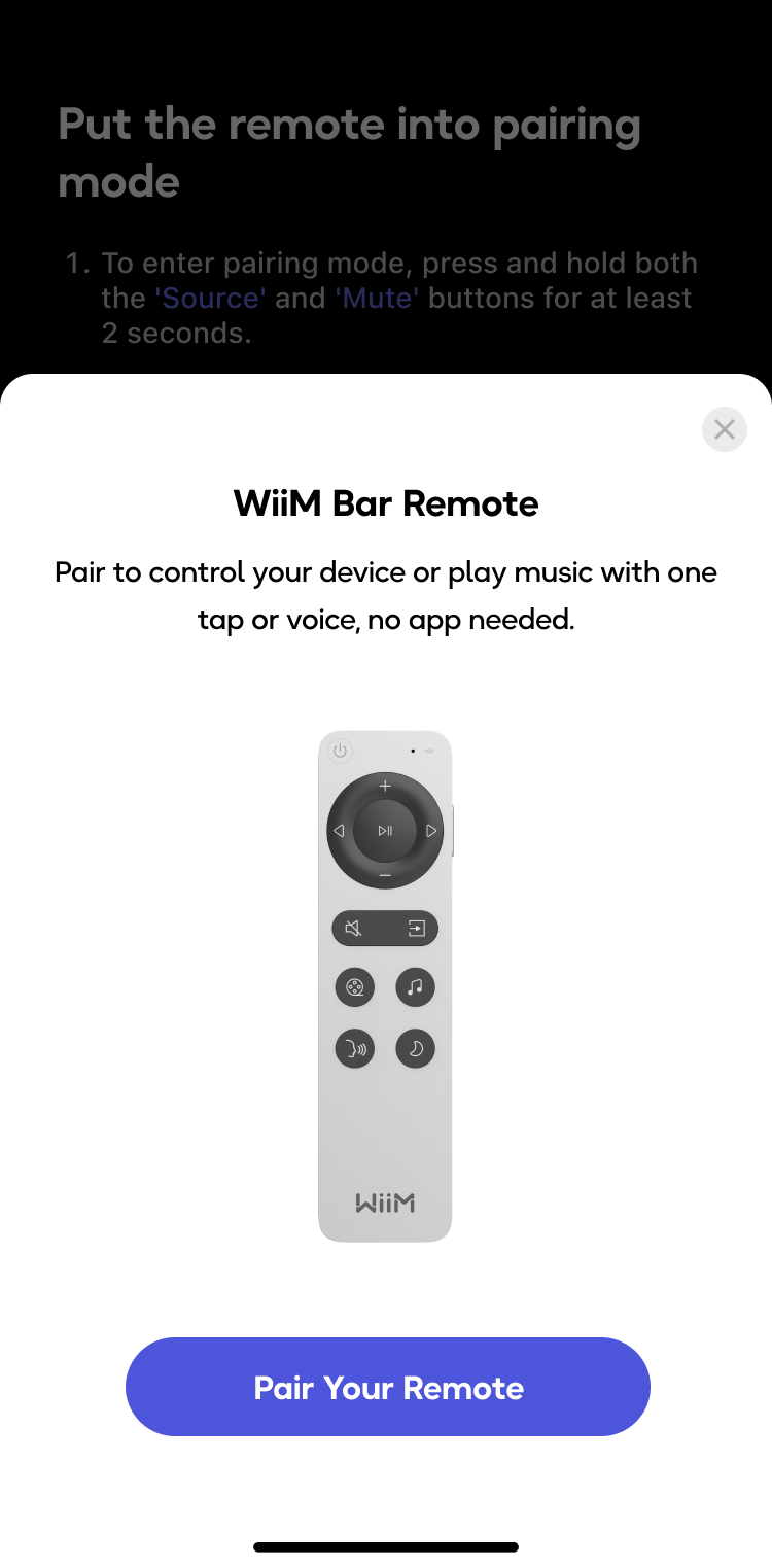

  1. Press and hold the Source Switch and Mute buttons simultaneously for 2 seconds to put the WiiM Bar Remote into pairing mode. When the LED indicator on the remote starts to flash white slowly, release the buttons.
  2. Open the WiiM Home app on your smartphone or tablet.
  3. Navigate to the Devices tab > WiiM Bar's Device Settings > Remote.
  4. When the corresponding pop-up appears, tap Pair Your Remote to start pairing. Follow the on-screen instructions to finish the pairing process.
    Pair Your Remote screen in the WiiM Home app
Tip: Once Bluetooth pairing is successful, the white LED will light up for 10 seconds and then turn off. You are now ready to use the WiiM Bar Remote to control your WiiM Bar.

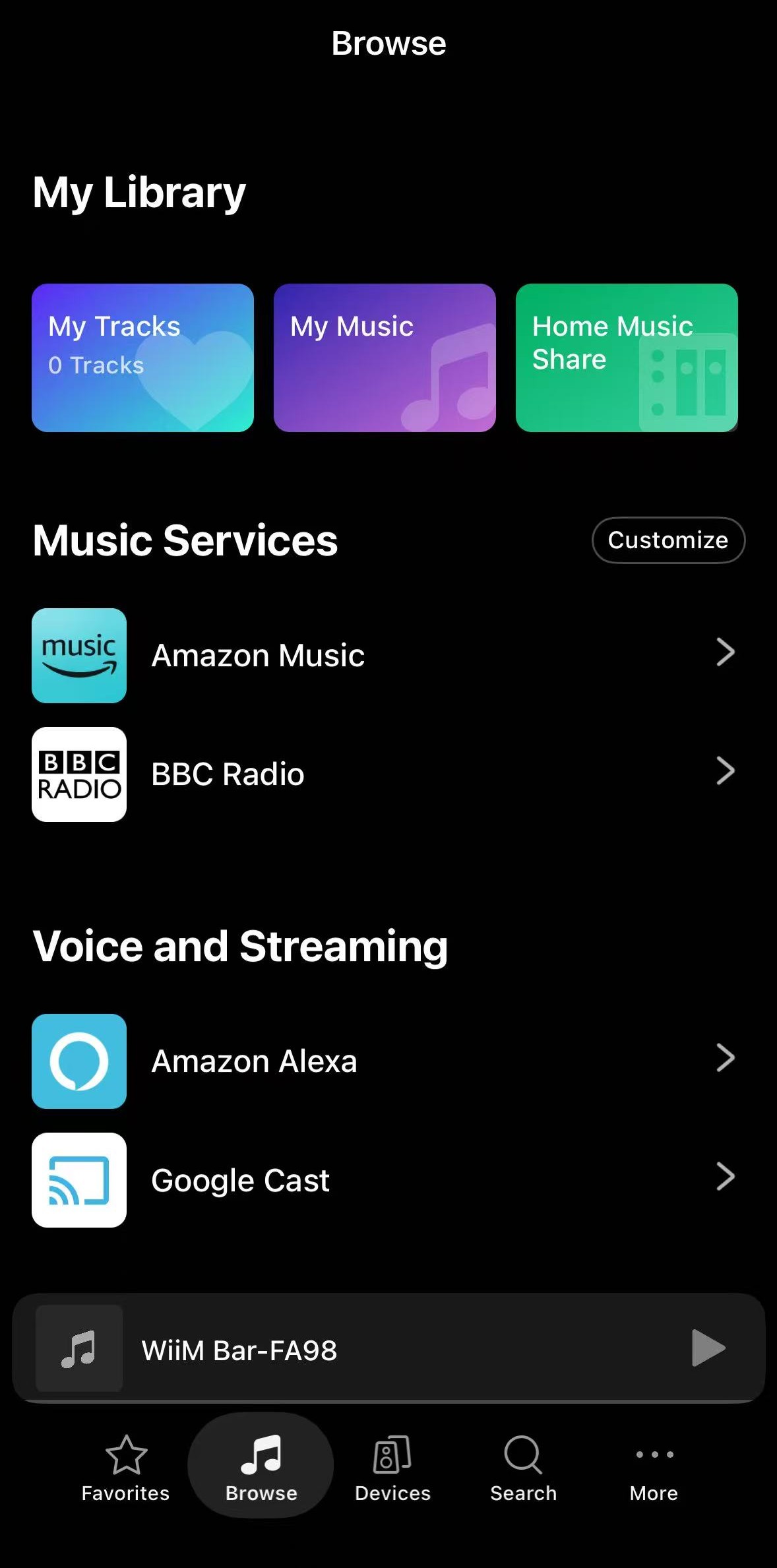

  1. Sign in to Amazon Alexa from the WiiM Home app. For details, see How to Use Alexa with Your WiiM Device.
    Amazon Alexa sign-in screen in the WiiM Home app
