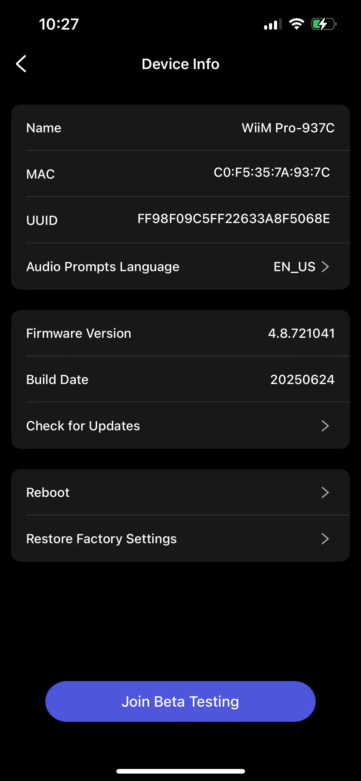

  • Find and record your WiiM device’s MAC address in the WiiM Home app under Device Settings > Device Info. You’ll need it for the integration steps below.

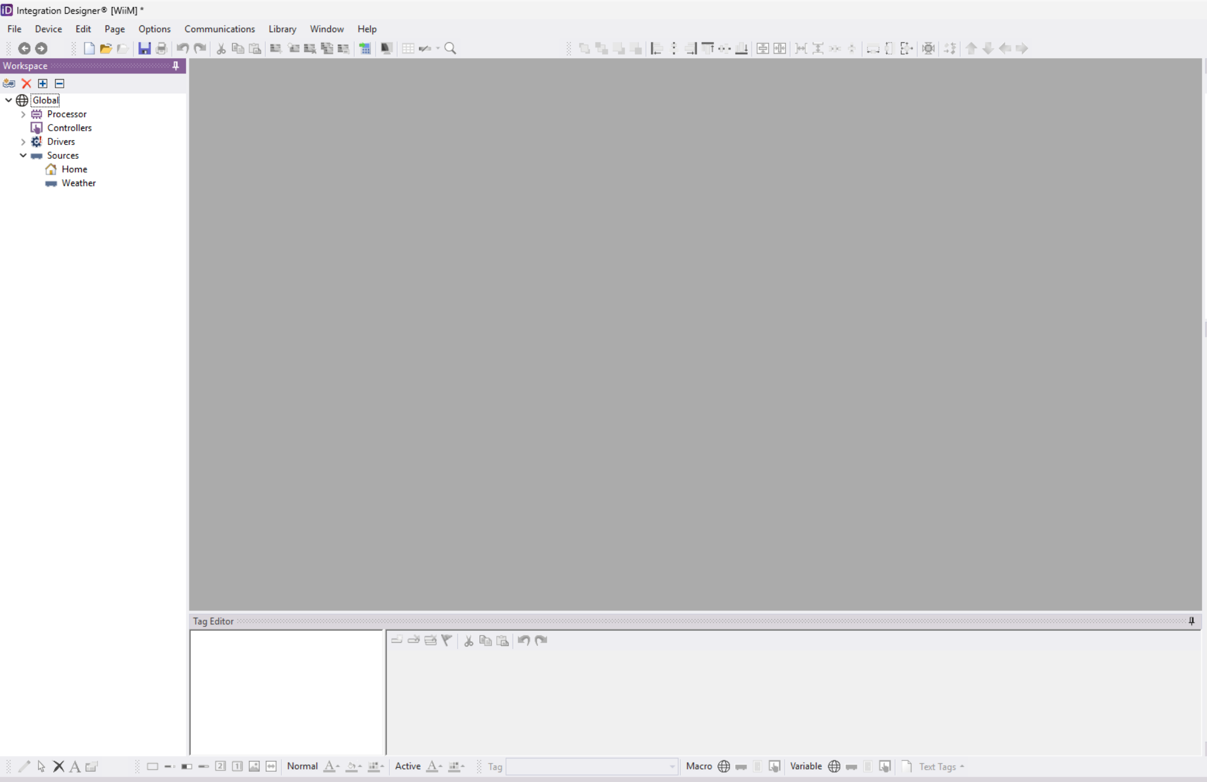

  1. Launch Integration Designer on your computer.

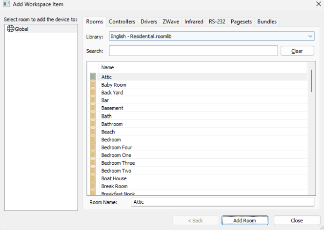

  2. In the left sidebar, right-click the blank area, and select Add New.

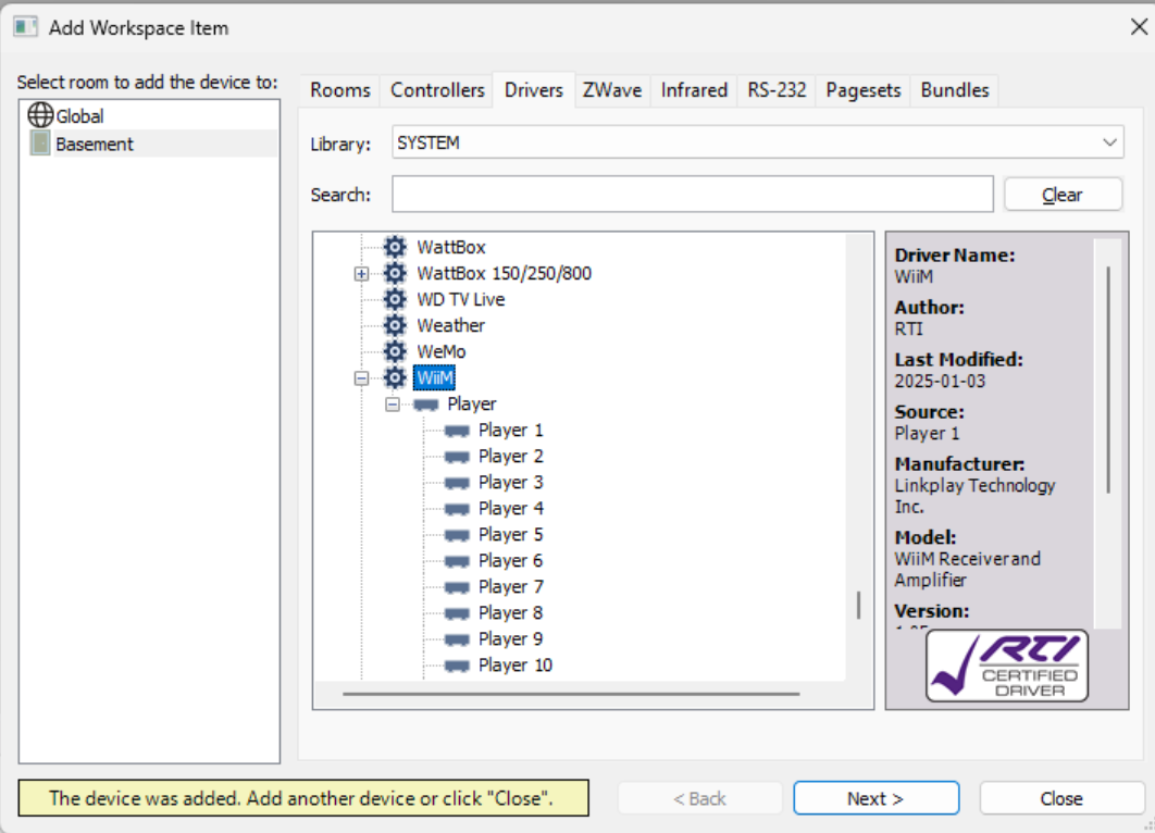

  3. In the pop-up dialog box, complete the following actions:
    - Click the Rooms tab and create a room.
    - Click the Controllers tab and select the correct model of your RTI controller.
    - Click the Drivers tab and install the WiiM driver.

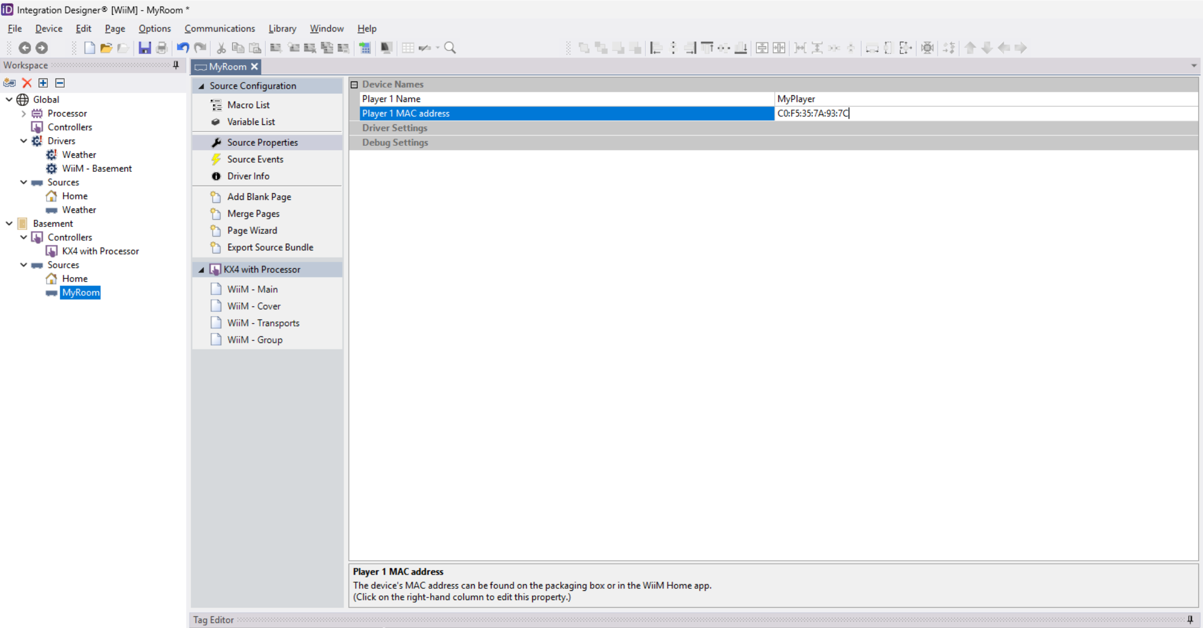

  4. Enter your WiiM device‘s MAC address. You can find it in the WiiM Home app under Device Settings > Device Info.
    Note: Make sure to input the MAC address in uppercase format.

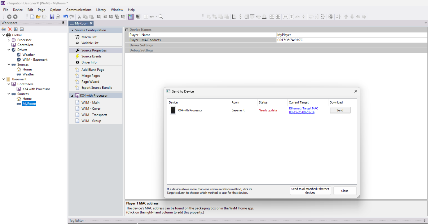

  5. Click the Send System option on the menu bar to send the configuration to the RTI system.
  6. Once completed, your WiiM device is added to the RTI system.

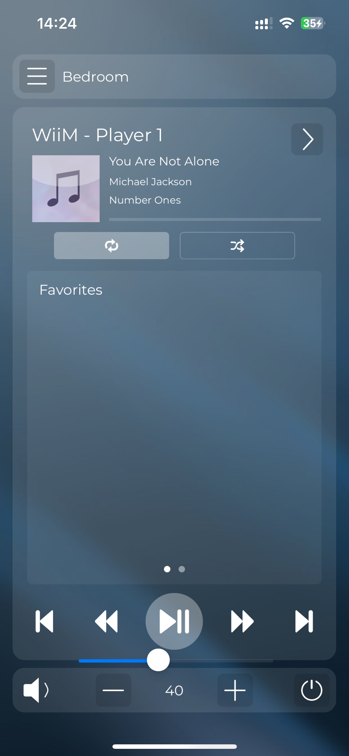

Once your WiiM device is successfully added to the RTI system, start playing music on it. Then, open the RTI app on your mobile device and go to Now Playing.
Here, you can control playback, including:
  • Play/Pause, skip to the next or previous track.
  • Adjust the volume.
  • Change shuffle and repeat modes.
  • Access your favorites and playlists

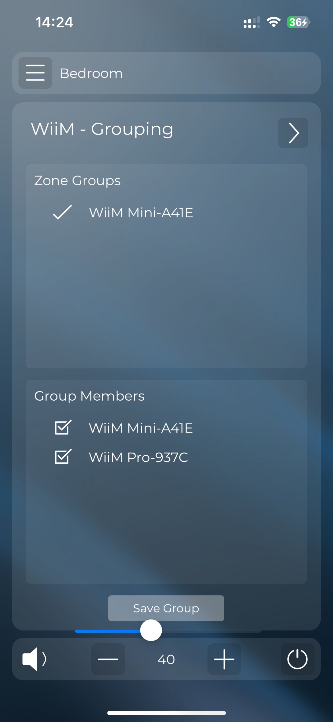

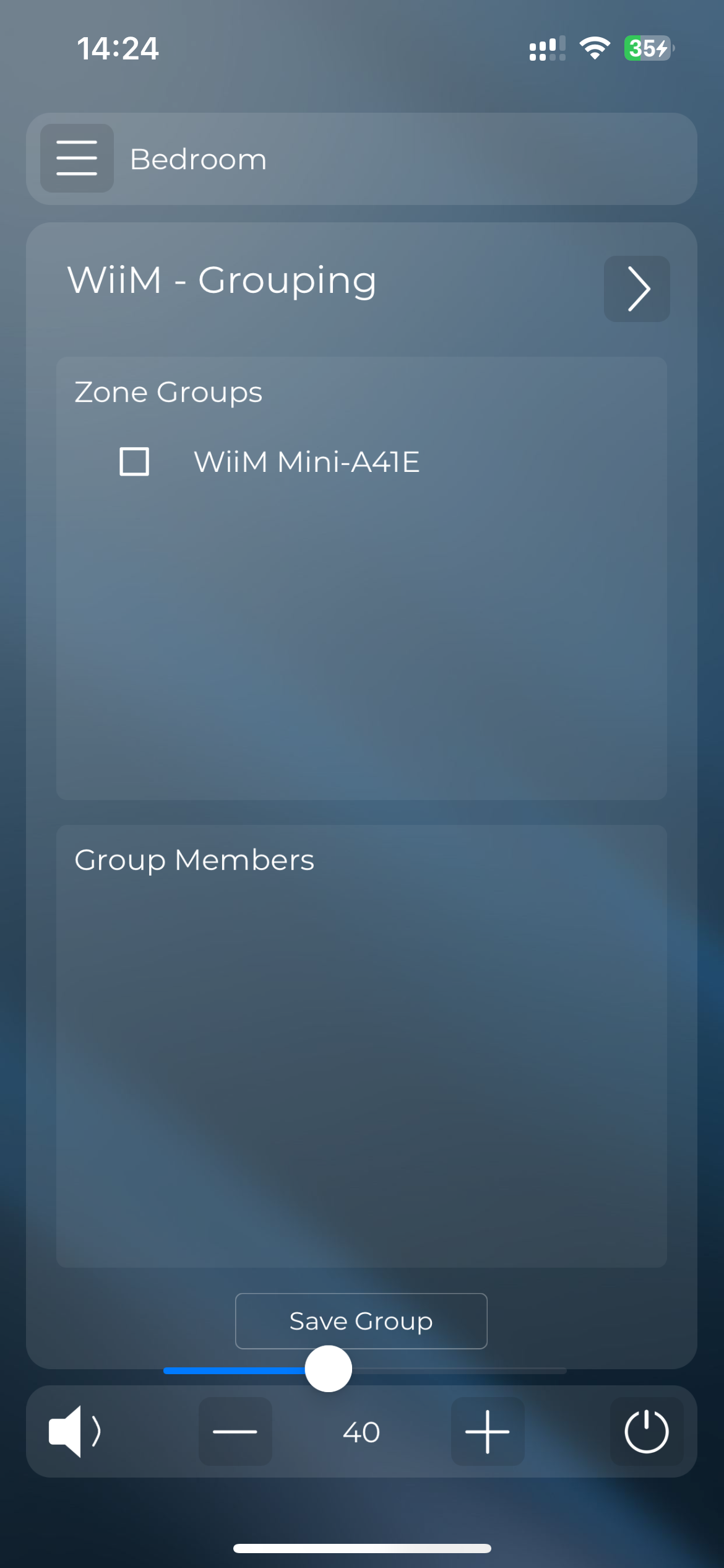

  1. Tap the icon on the Now Playing screen and switch to the WiiM - Grouping screen.
  2. Select a zone group and group members.
  3. Tap Save Group to complete.

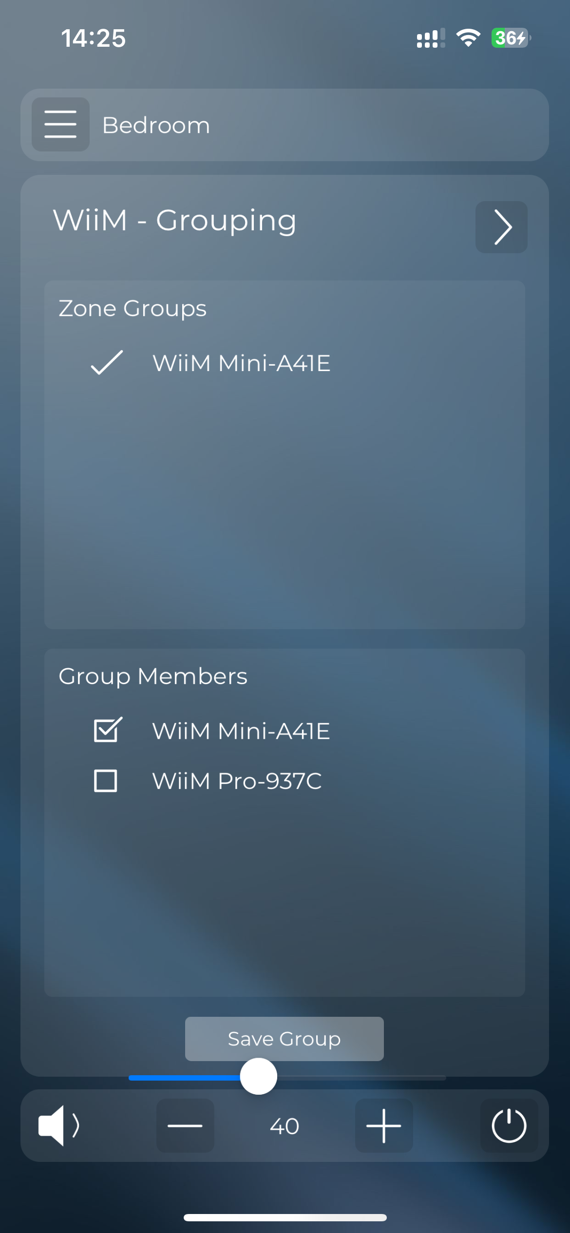

  1. Uncheck the devices you want to remove from the group.
  2. Tap Save Group to complete.
