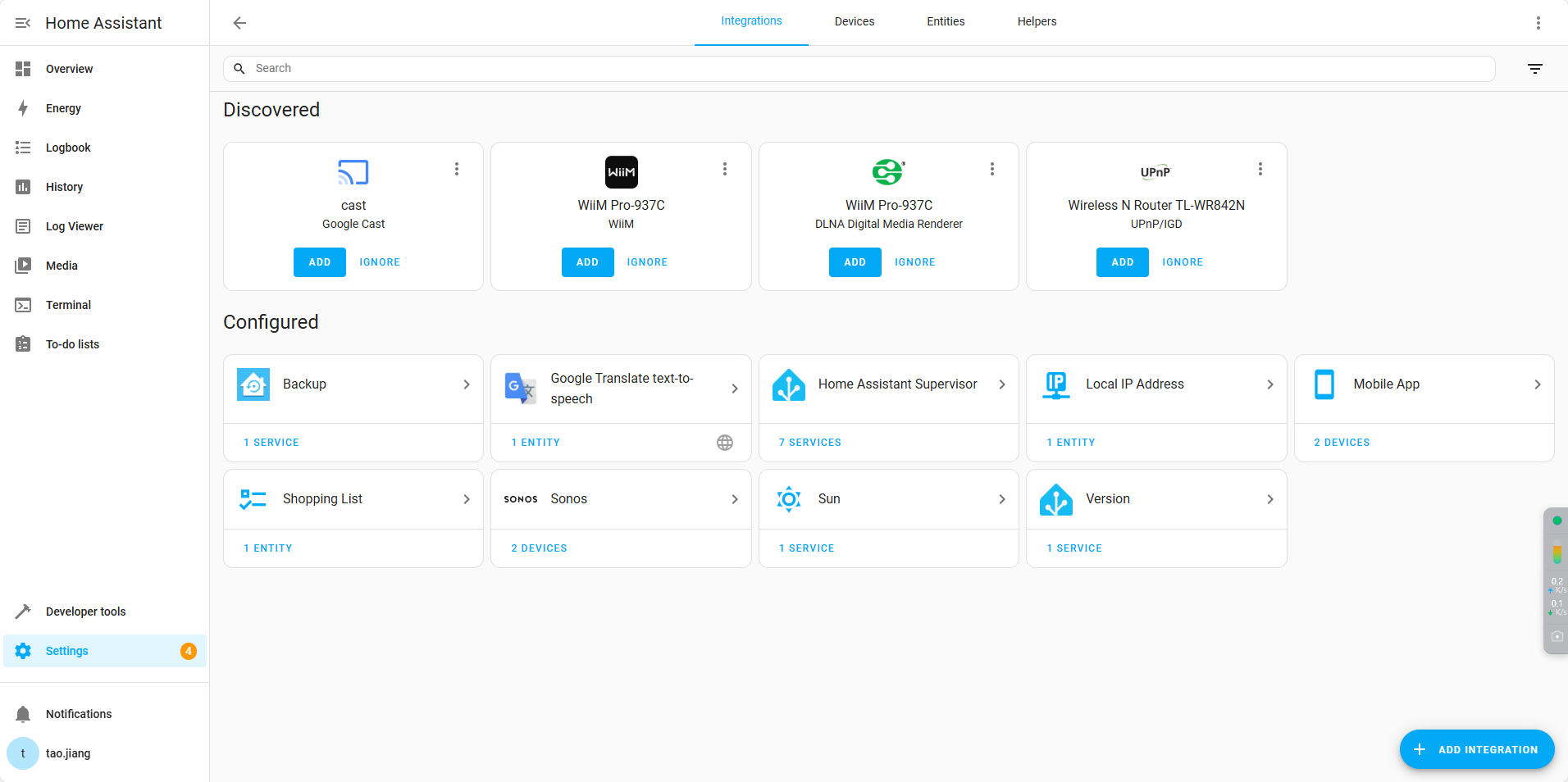

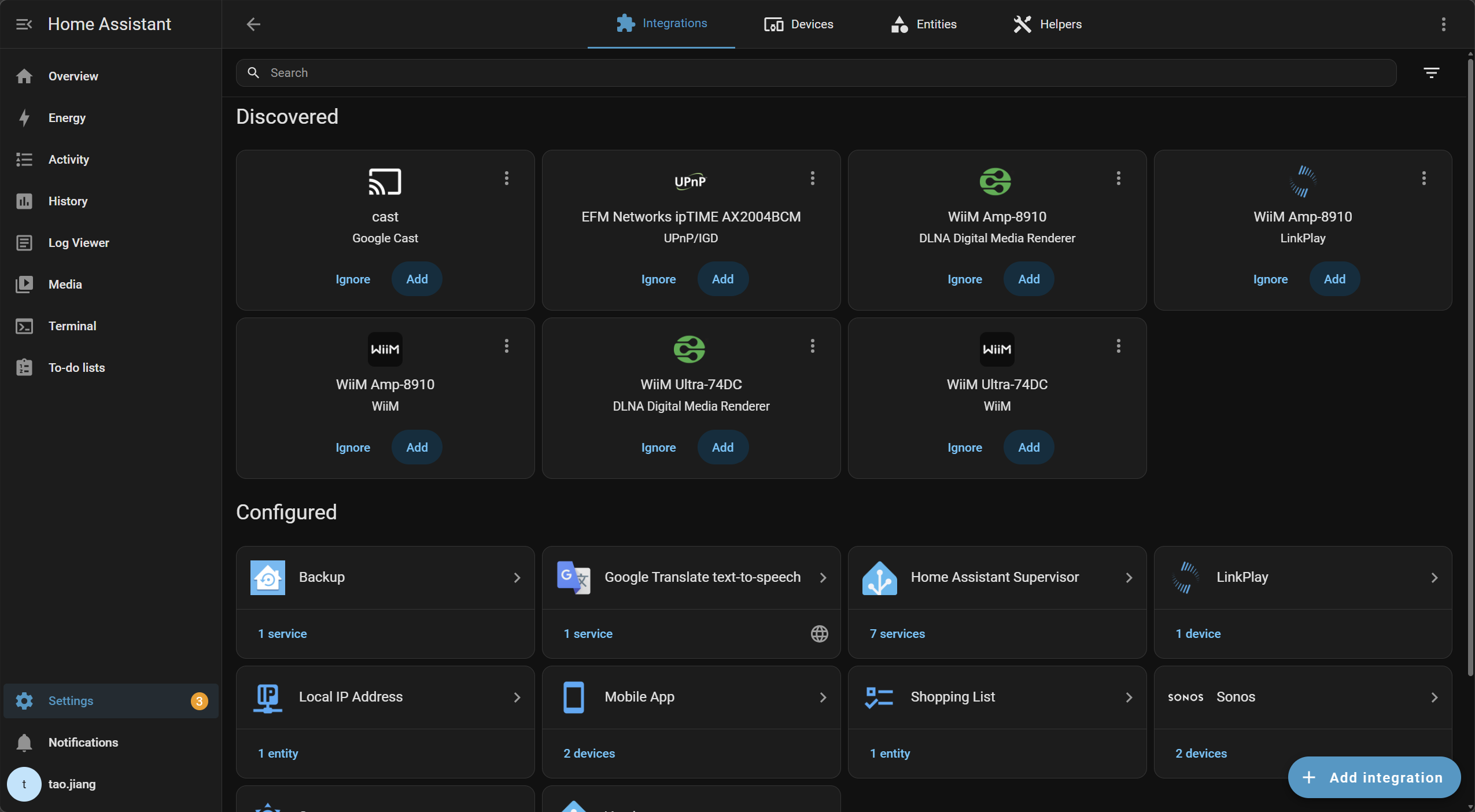

  3. WiiM devices will be automatically discovered and appear as Discovered in Home Assistant.

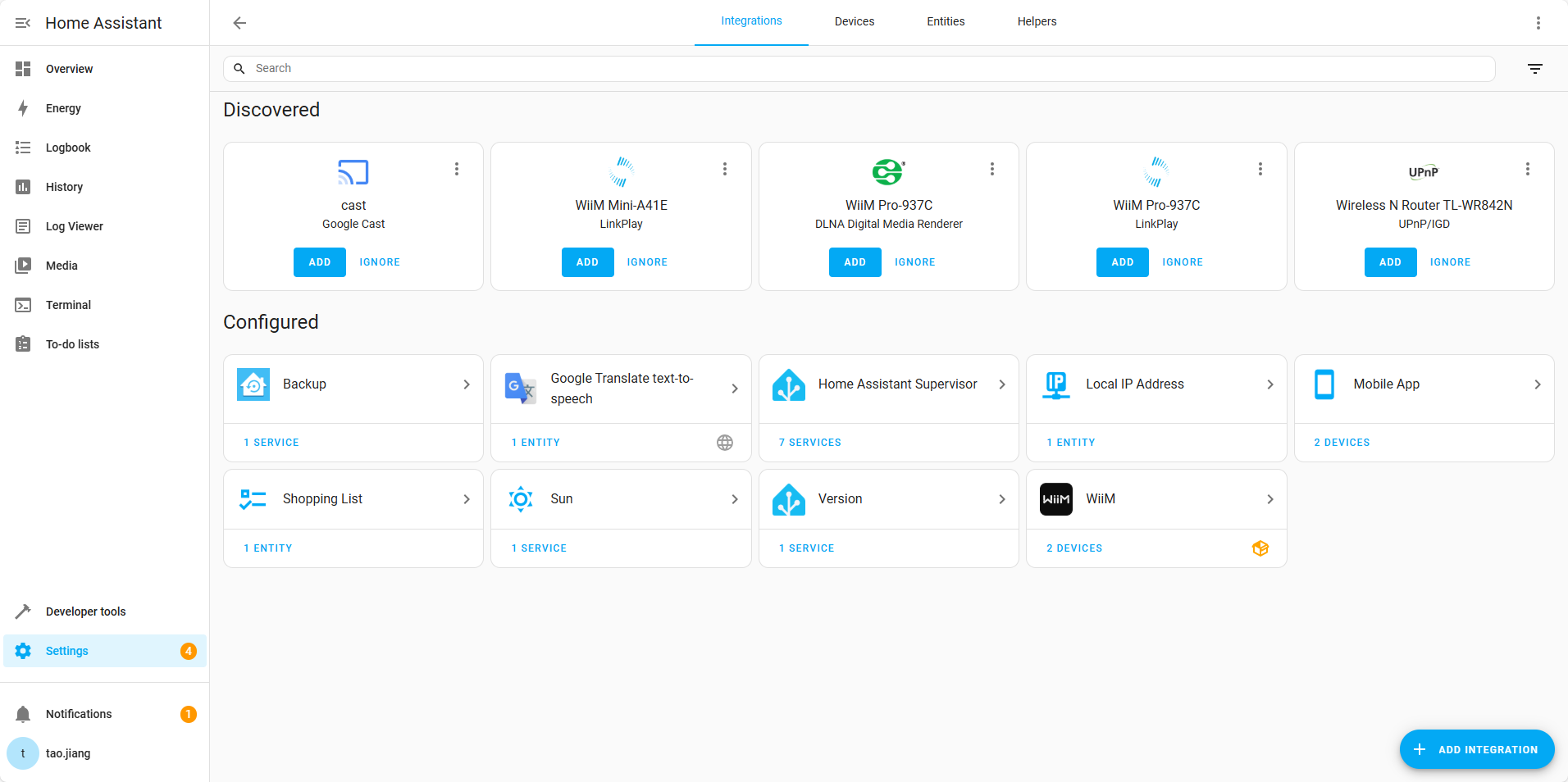

  1. Open a web browser on your PC to access Home Assistant at http://homeassistant.local:8123/.
    Alternatively, you can use the Home Assistant app on your mobile device to perform the following operations.
  2. Go to the Settings tab on the left sidebar. Your WiiM device will be automatically discovered.

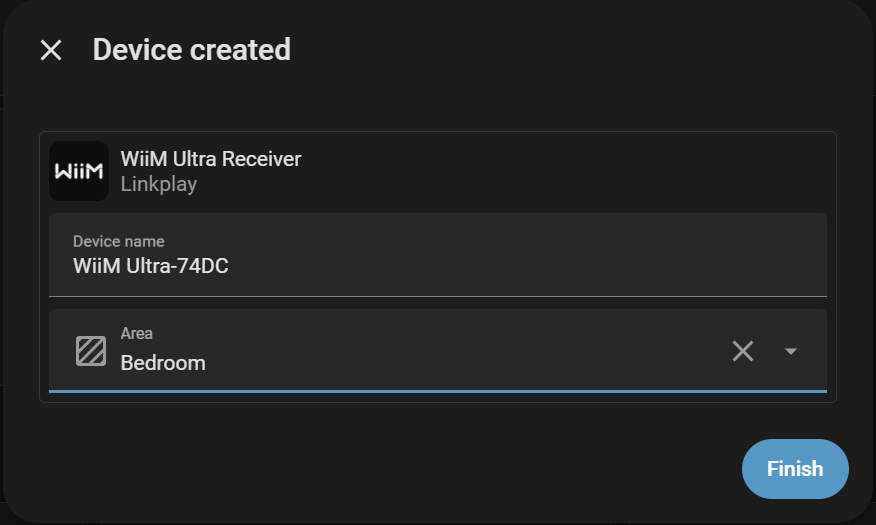

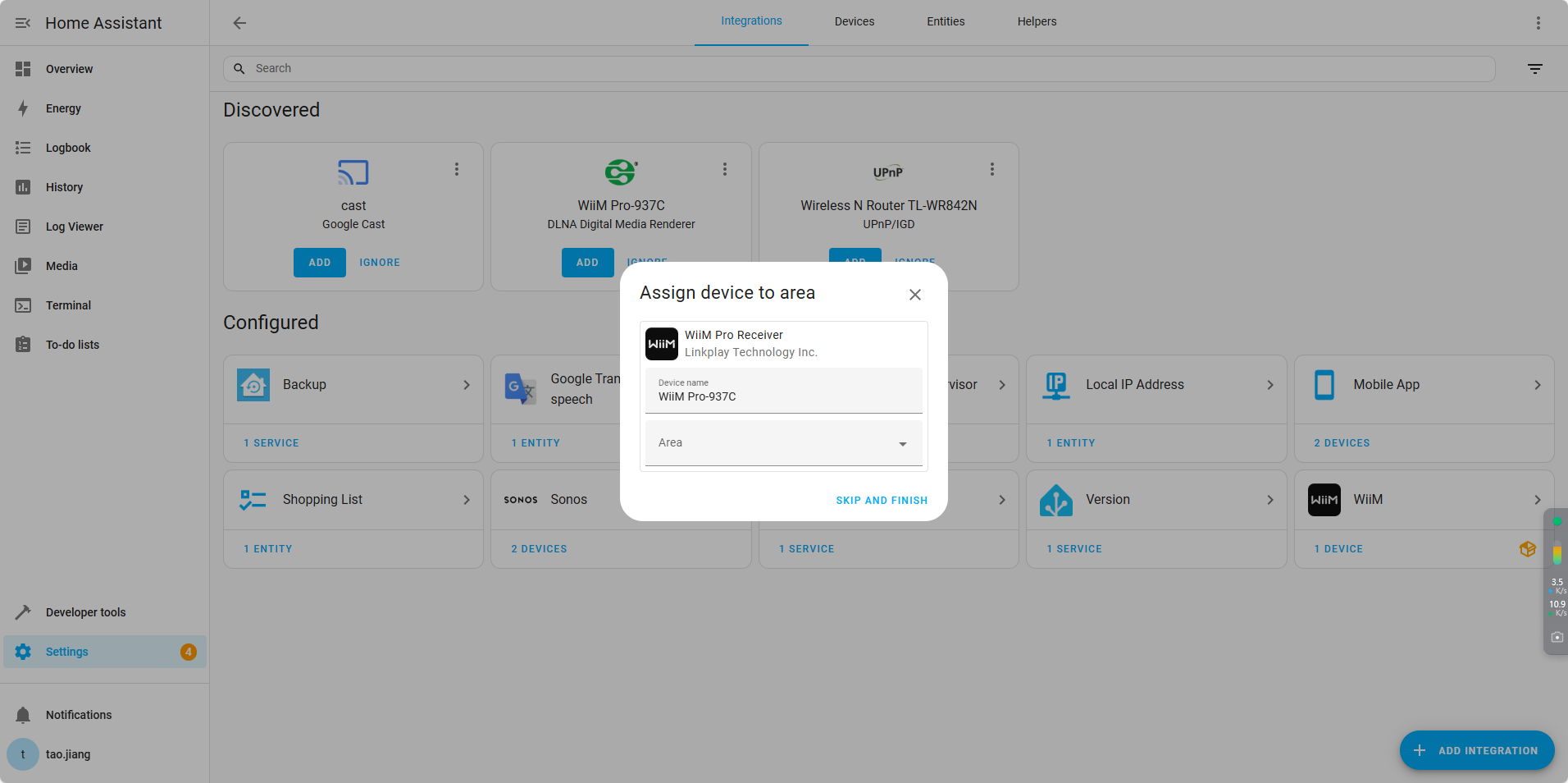

  3. Click the Add button under your WiiM device to add it to Home Assistant.
  4. Optionally, assign your WiiM device to an area.

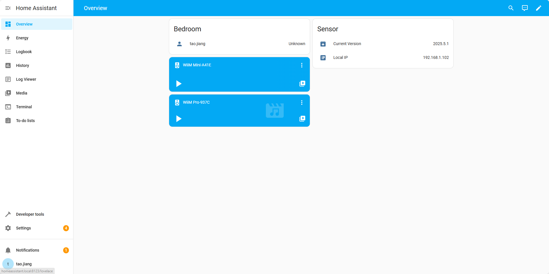

  5. Once added, your WiiM device will appear in the Overview tab.

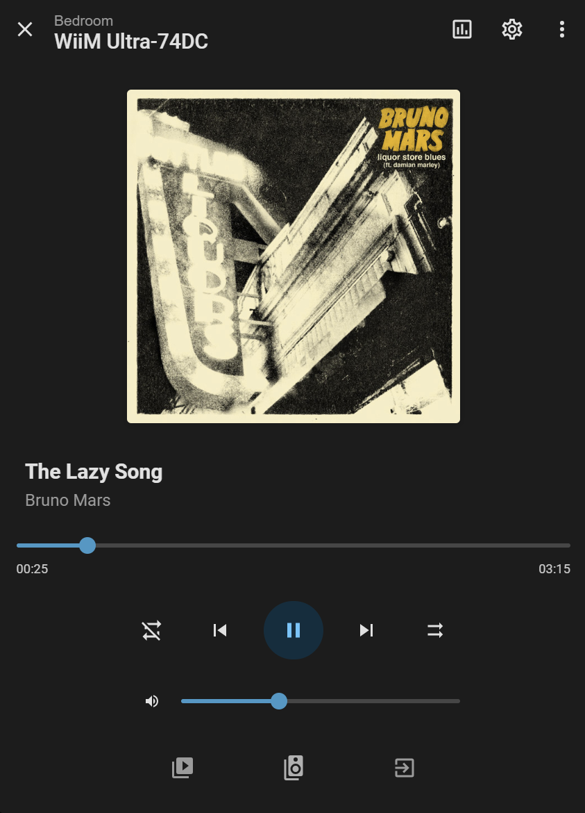

Playback Control

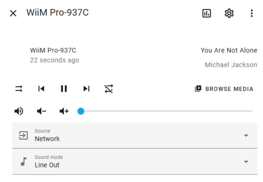

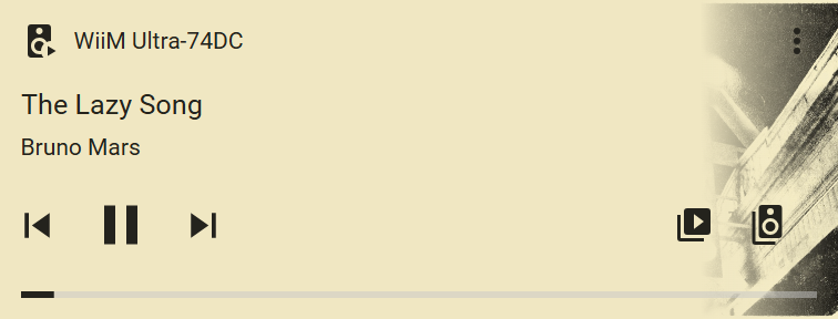

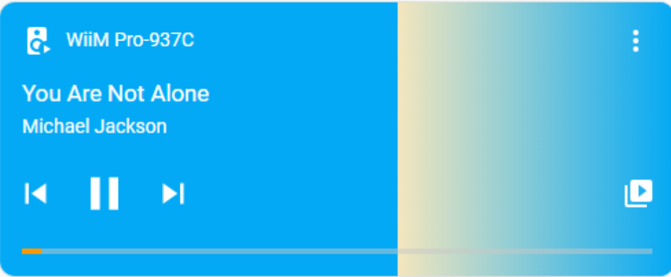

After your WiiM device is successfully added to Home Assistant, start playing music on your WiiM device. Once playback begins, the Now Playing bar will appear in the Overview tab, allowing you to control playback.

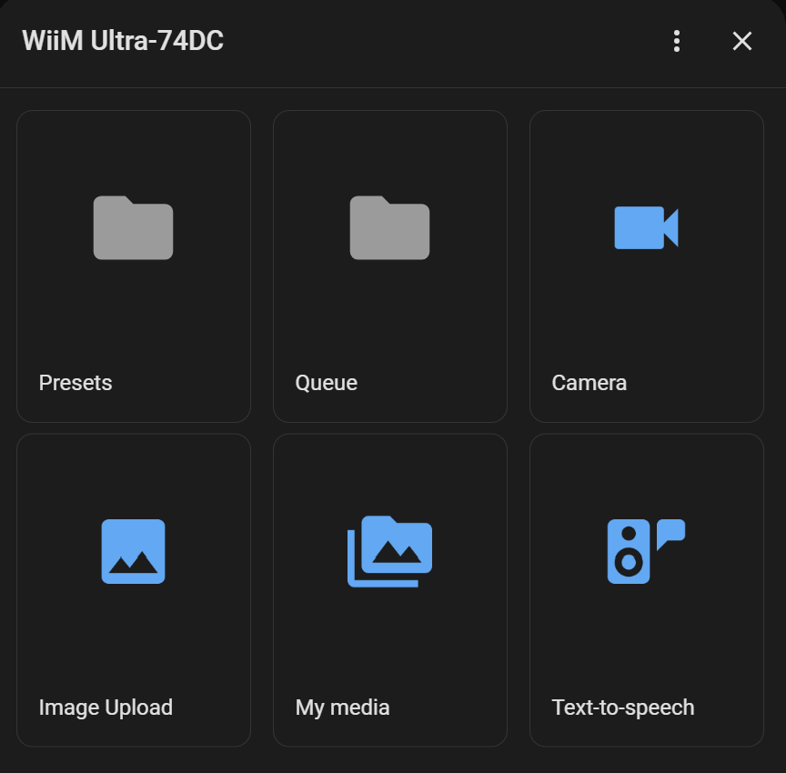

In addition, click the three-dot icon (⋮) in the top-right corner of the Now Playing bar to open the full playback controls, as shown below:
Here, you can:
  • Play/Pause
  • Skip to the next or previous track.
  • Adjust the volume.
  • Enable shuffle mode or repeat mode.
  • Click to select the input source.

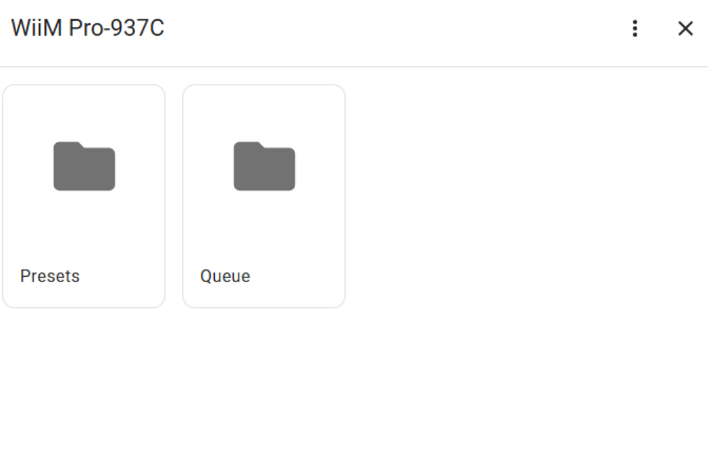

  • Click  to access presets and browse the playback queue.
