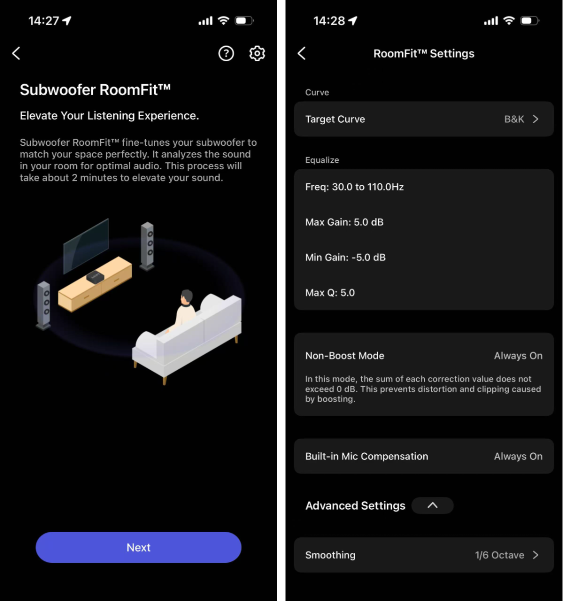

Go to the RoomFitTM Settings page in the WiiM Home app and configure these parameters based on your preference:
- Target Curve: Defines the target frequency response that your WiiM Sub Pro tries to match after Room Correction. Choose the desired frequency response curve from B&K, Harman, Flat before Room Correction.
- Smoothing: Reduces minor fluctuations in the frequency response to help focus on overall trends and prevent overcompensation. You can choose a value from the following ones:
- 1/3 Octave: Strong smoothing. Shows overall trends, hides fine details.
- 1/6 Octave: Balanced smoothing. Good mix of clarity and detail.
- 1/12 Octave: Light smoothing. Reveals more detail but may look uneven.
- Variable: Automatically adjusts smoothing depending on frequency. Light smoothing on bass for detail, heavier on treble for readability.
- Psychoacoustic: Smoothing according to how humans hear. Hides the tiny acoustic bumps that microphones measure but your ears can't actually hear.
- ERB: Smoothing based on advanced"human hearing" mode. It provides more detail than Psychoacoustic while still considering human perception.
For a configuration guide, refer to
- Introducing RoomFit™ Settings
- A Practical Guide to RoomFit™Room Correction for Enhanced Sound Quality
Other parameter settings as below are fixed and cannot be changed:
- Freq: 30.0 to 110.0HZ
- Max Gain: 5.0 dB
- Min Gain: -5.0 dB
- Max Q: 5.0
- Non-Boost Mode: Always On (Let you lower frequencies, reducing room resonances and unwanted responses for a more balanced sound.)
- Built-in Mic Compensation: Always OnStep-by-Step Guide to RoomFitTM Room Correction
- Open the WiiM Home app.
- Go to the Devices tab and locate the WiiM streamer paired with your WiiM Sub Pro.
- Tap the
icon to directly open your WiiM Sub Pro settings.
- Select Subwoofer RoomFitTM, then tap Run RoomFitTM .
- Tap Next to start the Room Correction process.
- Tap Play Sound to start an audio check.
- Tap Start Tuning to begin the acoustic measurement, then evaluate the results.
