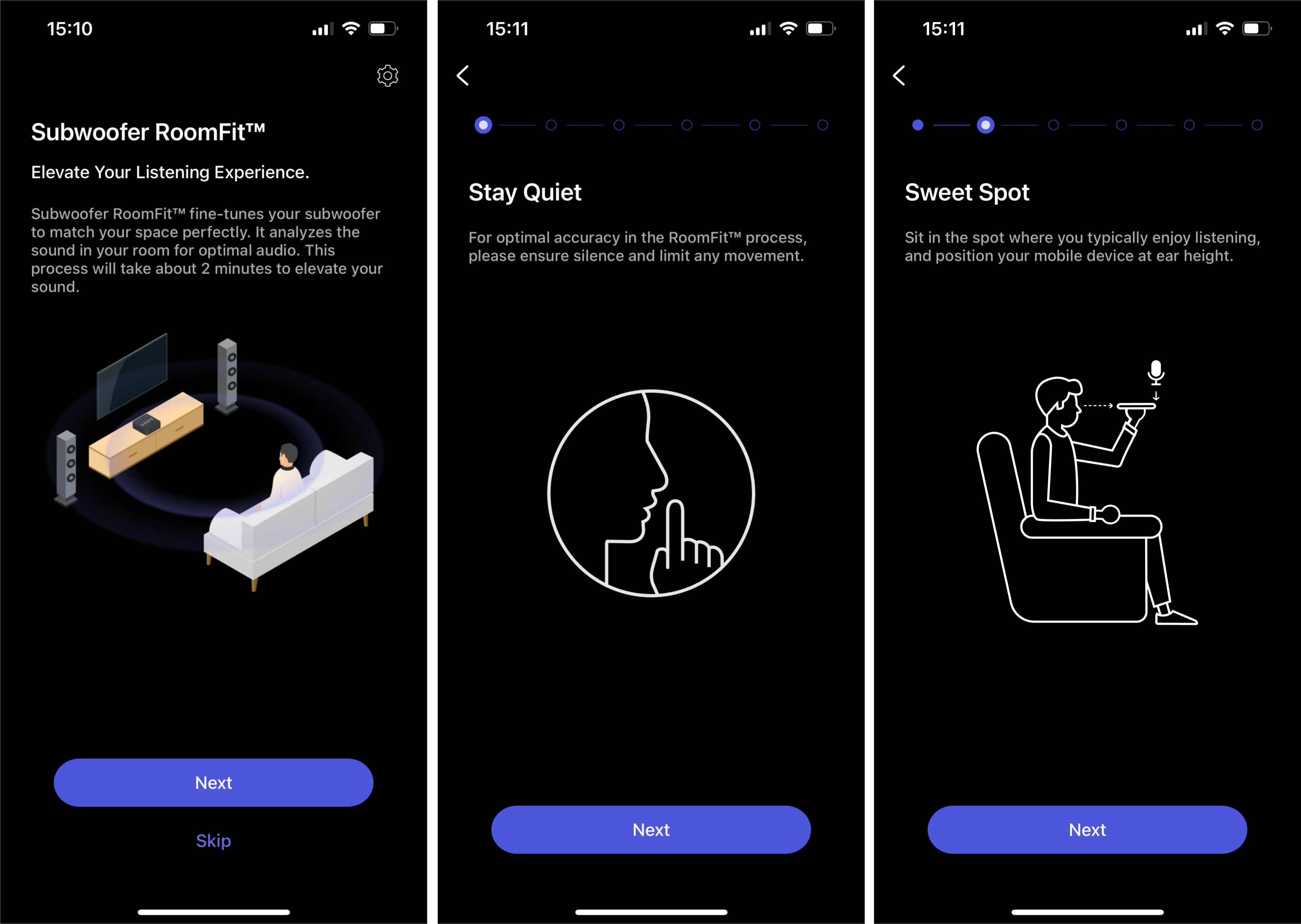

1. Room and Device Preparations
- Ensure your WiiM Sub Pro is properly placed and set up. For details, refer to How to Set Up Your WiiM Sub Pro and A Practical Guide to Room Correction for Enhanced Sound Quality.
- Avoid obstructions around the WiiM Sub Pro.
- Set your WiiM Sub Pro's volume to a moderate level.
- Close doors and windows.
- Keep the room as quiet as possible.

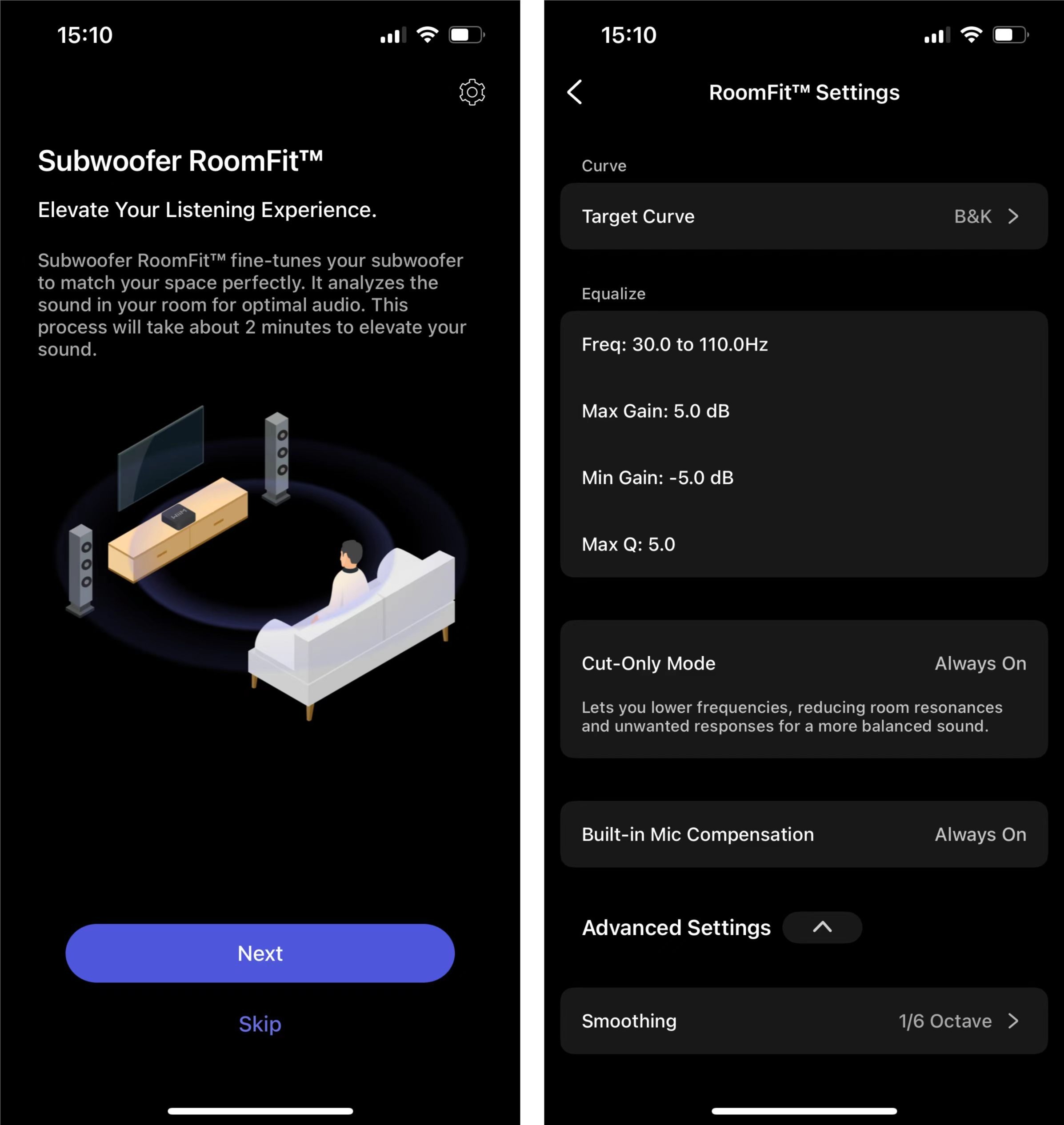

Go to the RoomFitTM Settings page in the WiiM Home app and configure these parameters based on your preference:
- Target Curve: Defines the target frequency response that your WiiM Sub Pro tries to match after Room Correction. Choose the desired frequency response curve from B&K, Harman, Flat before Room Correction.
- Smoothing: Reduces minor fluctuations in the frequency response to help focus on overall trends and prevent overcompensation. You can choose a value from the following ones:
- 1/3 Octave Smoothing: Balances detail with overall trends.
- 1/6 Octave Smoothing: Retains more detail while maintaining readability.
- 1/12 Octave Smoothing: Provides highly detailed adjustments for fine-tuning specific areas.
For a configuration guide, refer to A Practical Guide to Room Correction for Enhanced Sound Quality.
Other parameter settings as below are fixed and cannot be changed:
- Freq: 30.0 to 110.0HZ
- Max Gain: 5.0 dB
- Min Gain: -5.0 dB
- Max Q: 5.0
- Cut-Only Mode: On (Lets you lower frequencies, reducing room resonances and unwanted responses for
a more balanced sound.)
- Built-in Mic Compensation: On

- Open the WiiM Home app.

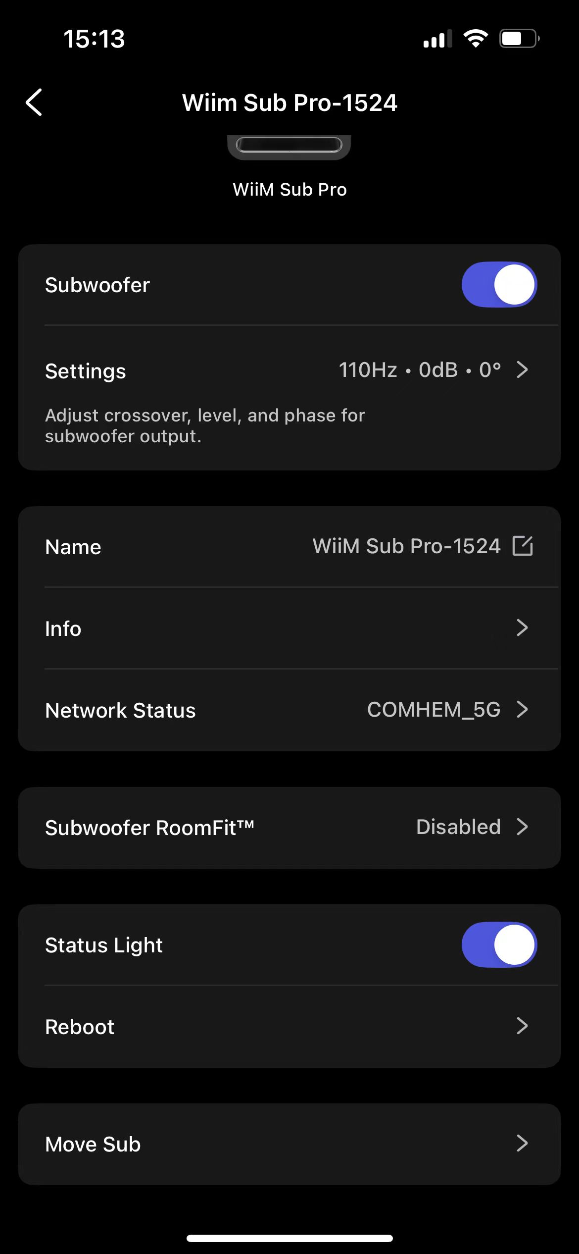

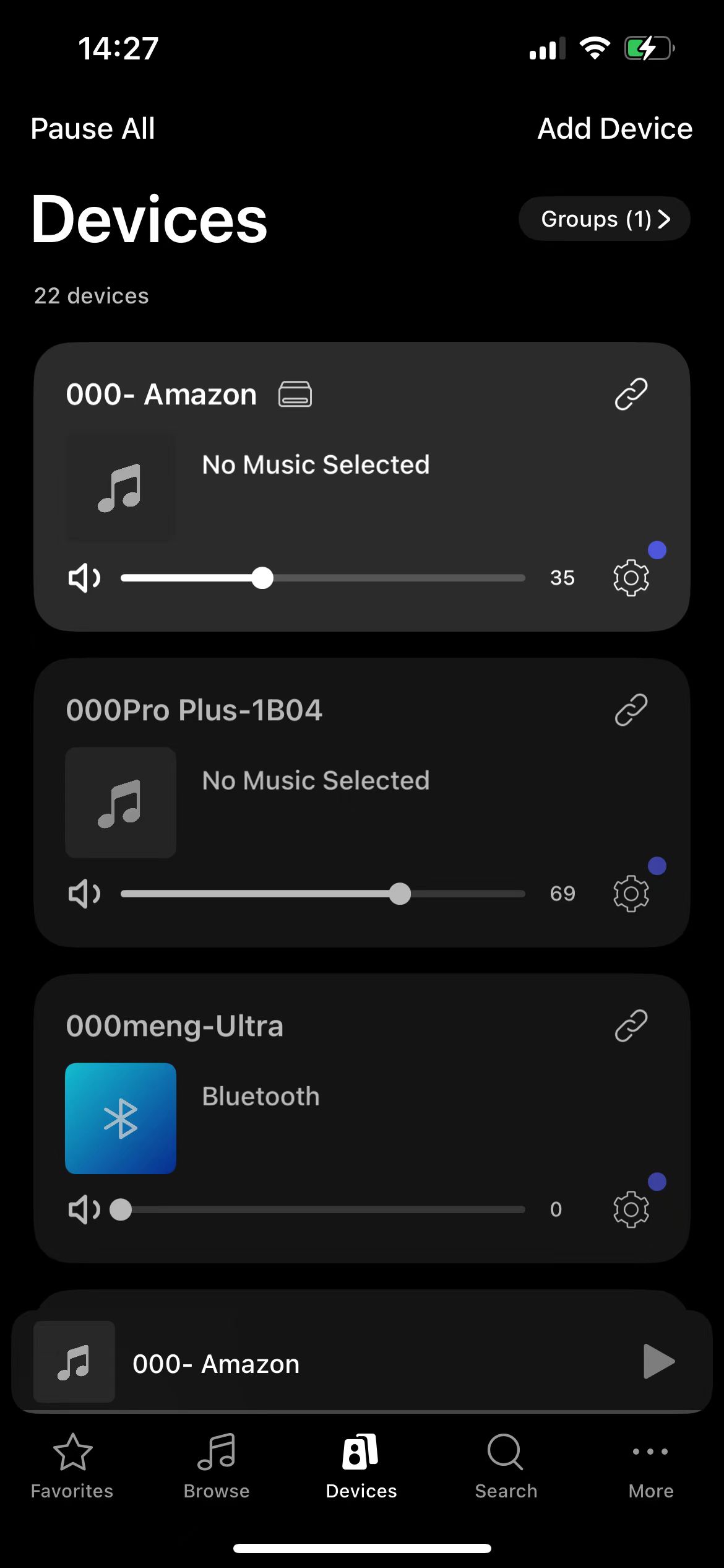

- Go to the Devices tab and locate the WiiM streamer paired with your WiiM Sub Pro.
- Tap the
icon to directly open your WiiM Sub Pro settings.
- Select Subwoofer RoomFitTM, then tap Run RoomFitTM .
- Tap Next to start the Room Correction process.

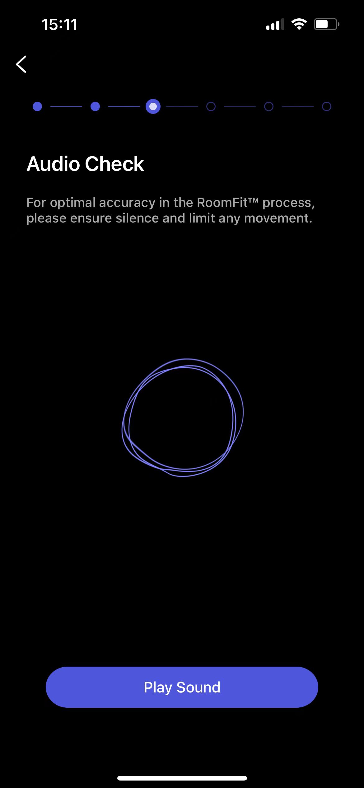

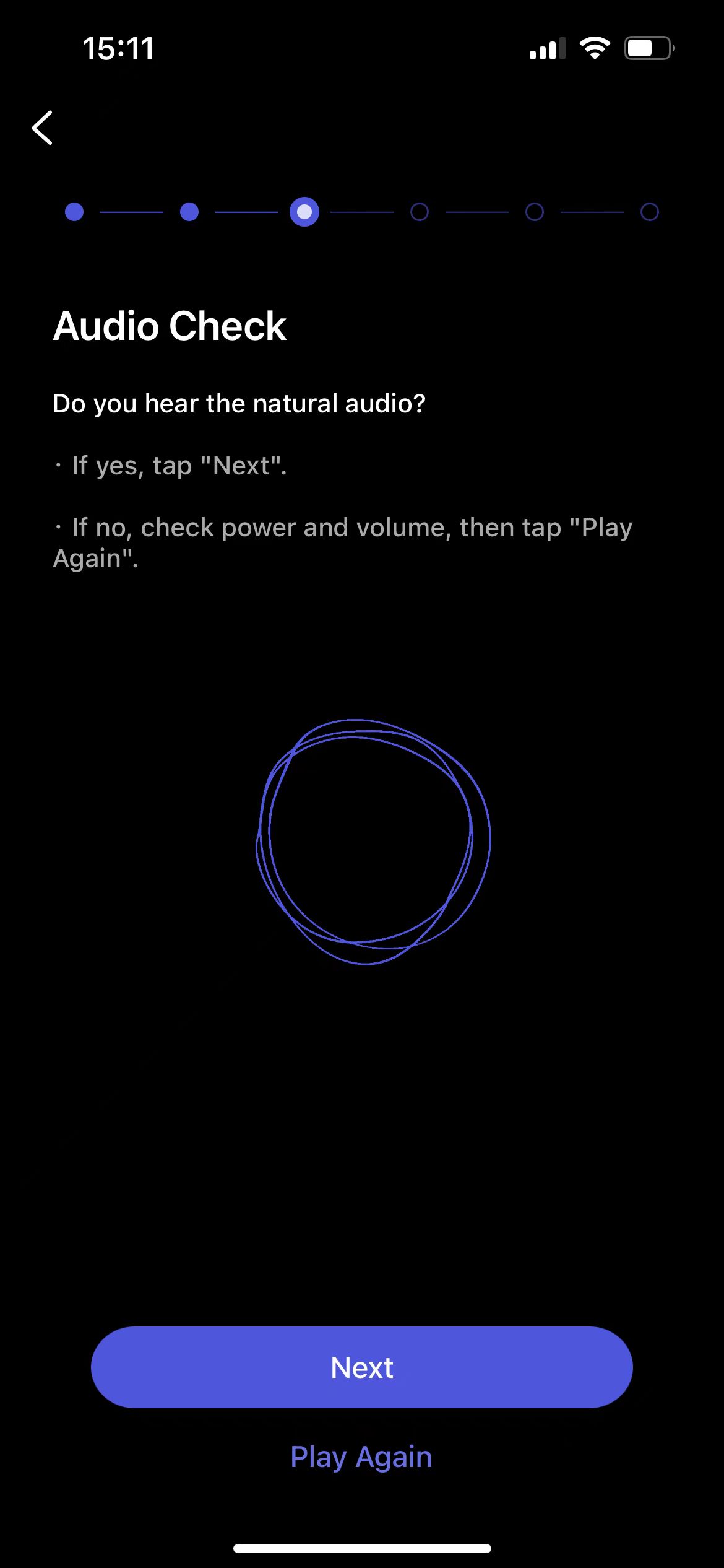

- Tap Play Sound to start an audio check.If you can hear the sound, tap Next to continue. Otherwise, tap Play Again to check audio again.

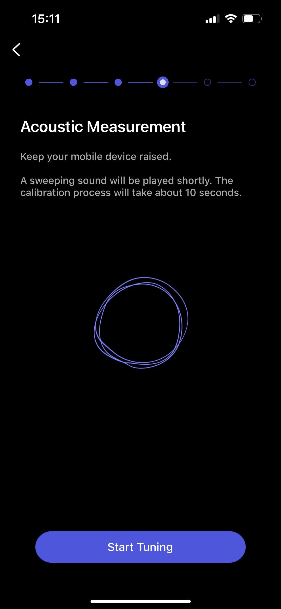

- Tap Start Tuning to begin the acoustic measurement.

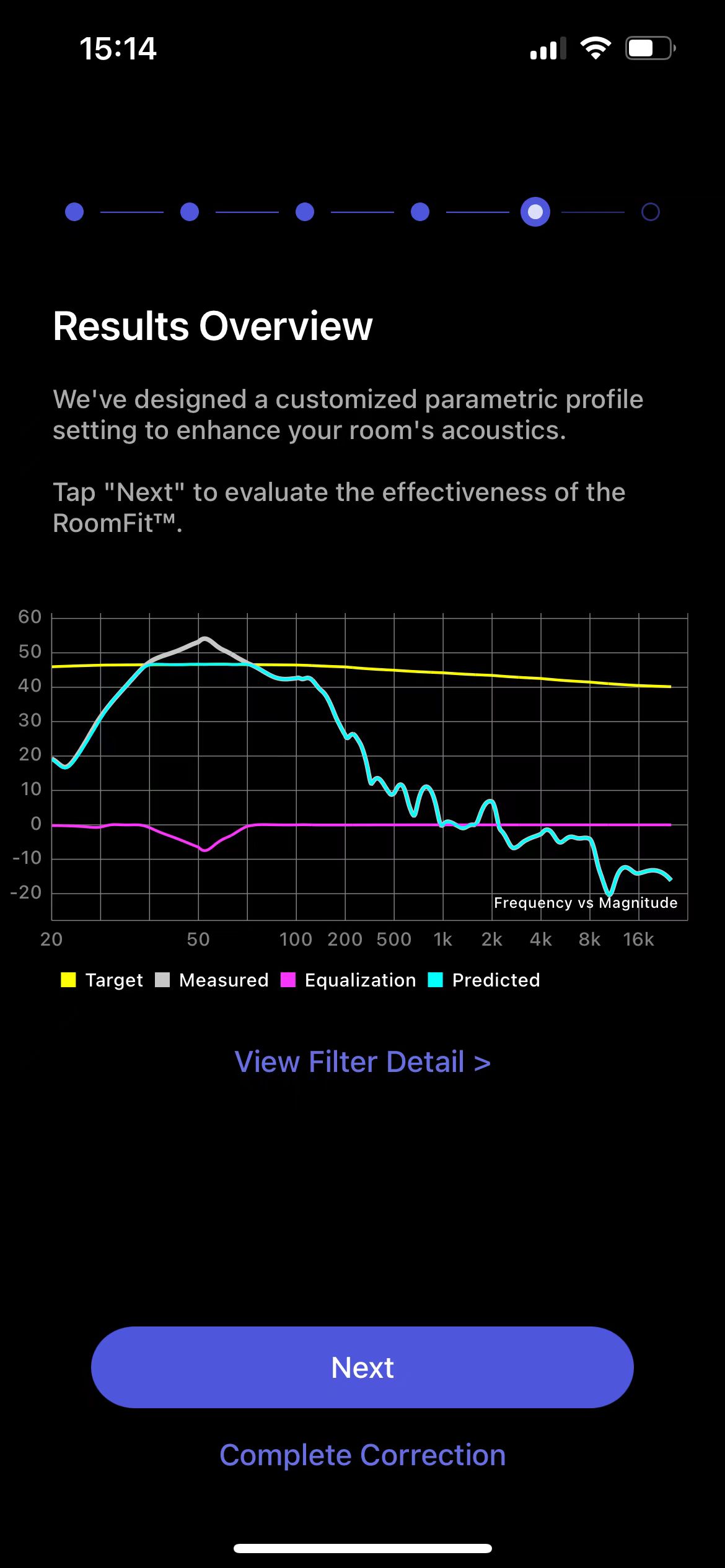

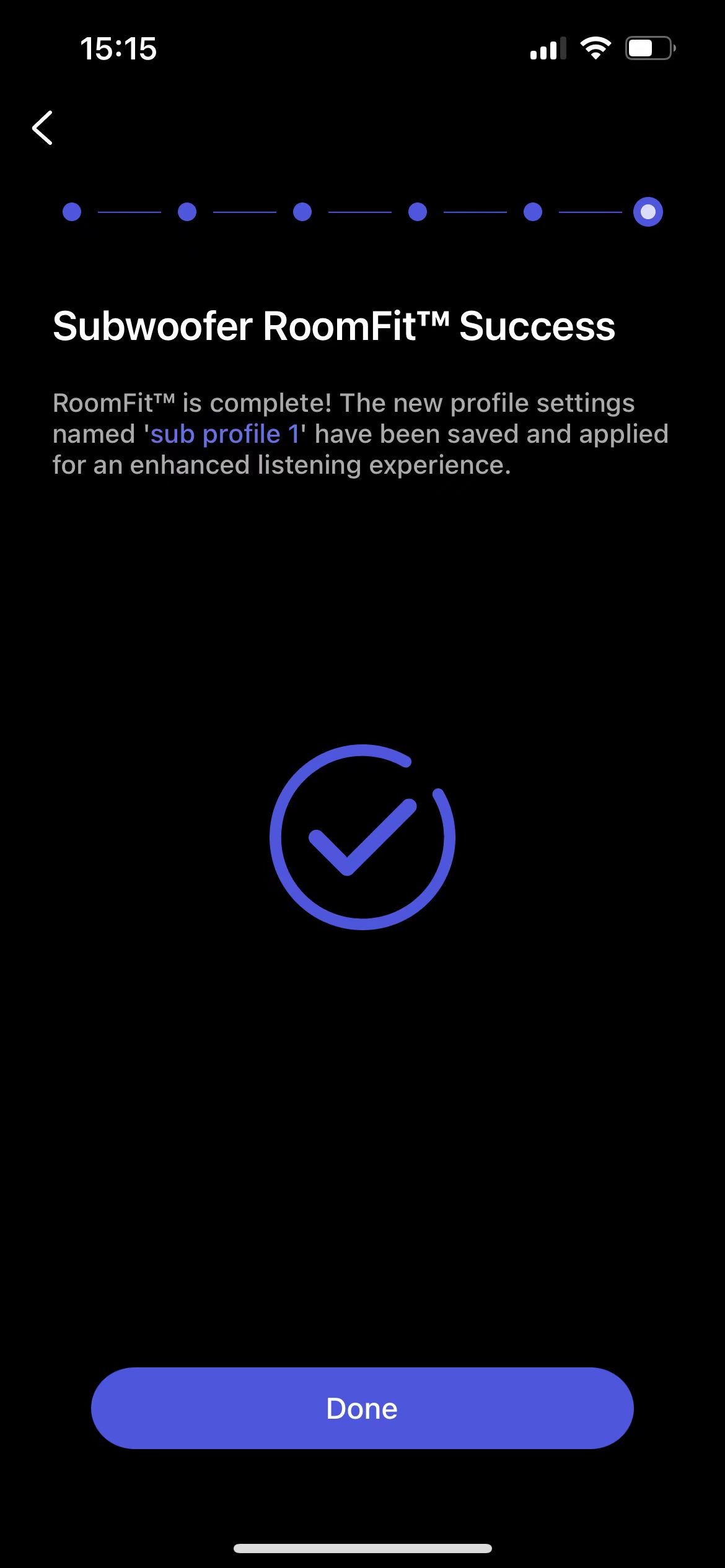

- When the Results Overview page appears, view the results, and then tap Next to proceed to the evaluation step. Alternatively, tap Complete Correction to save the settings and finish without evaluation.

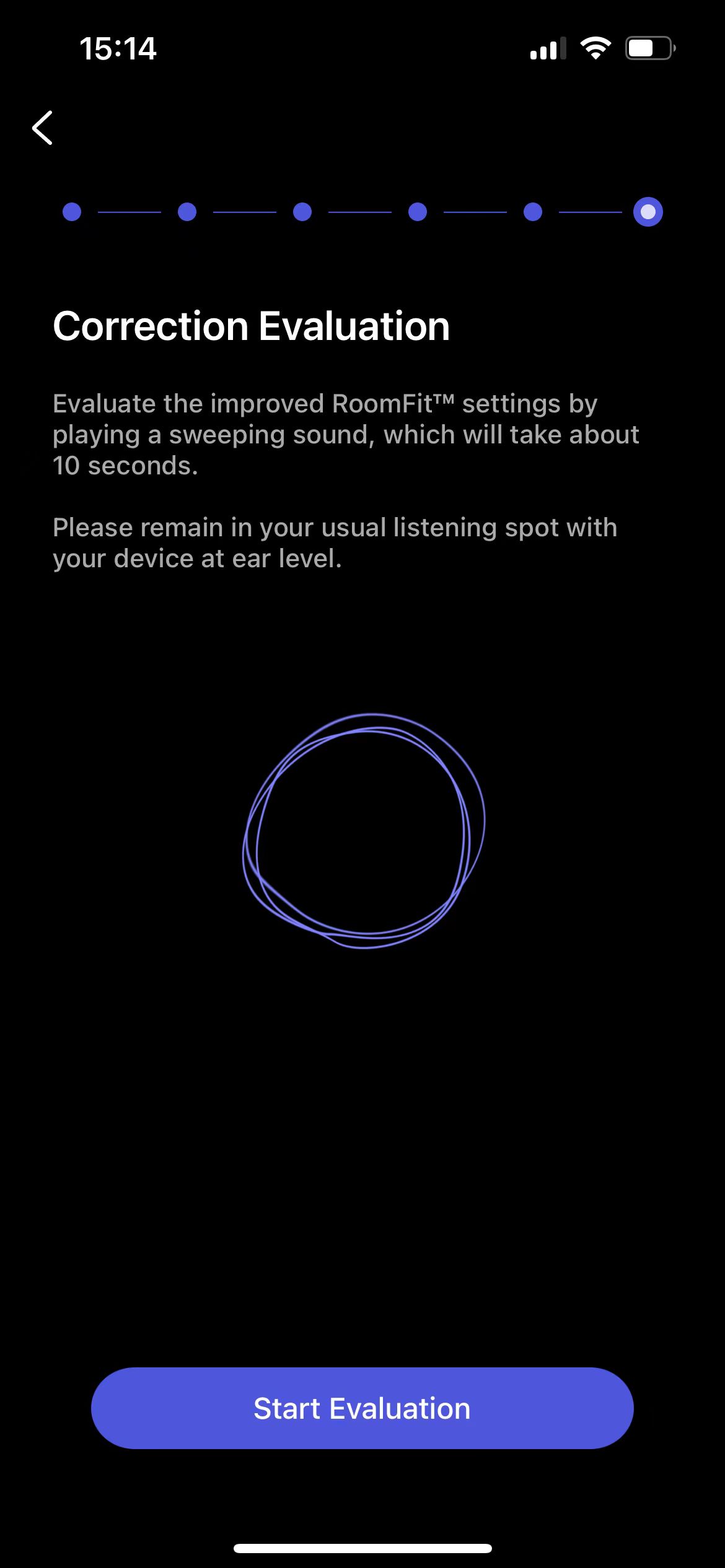

- Tap Start Evaluation to evaluate the Room Correction results.

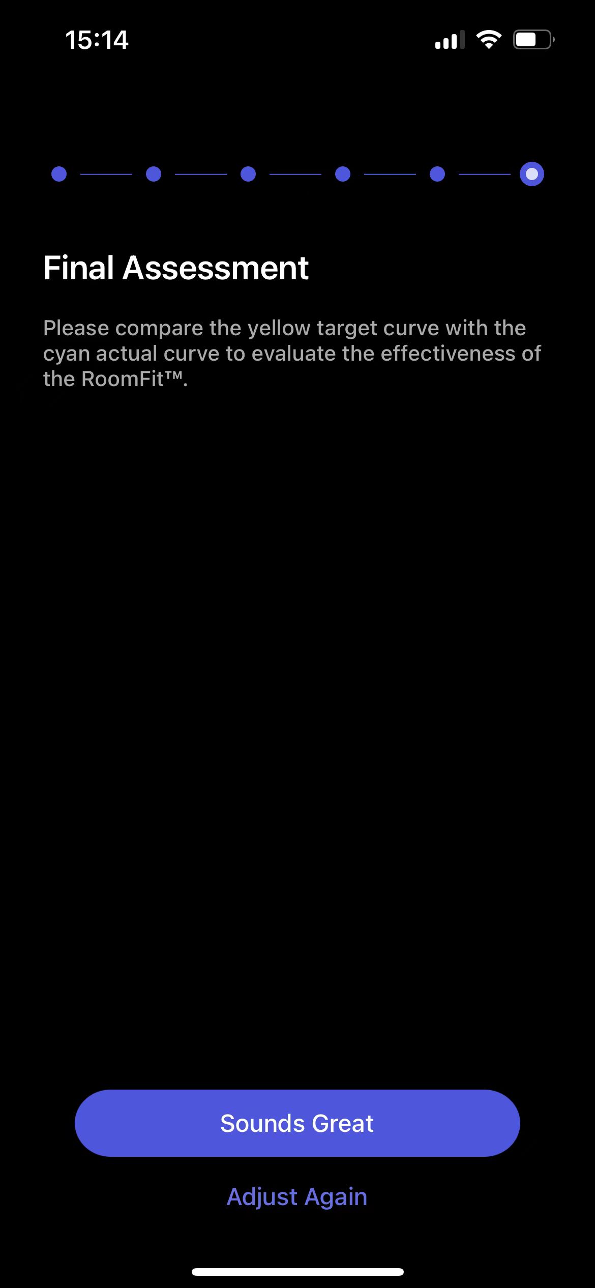

- When the Final Assessment page appears, tap Sounds Great to continue.

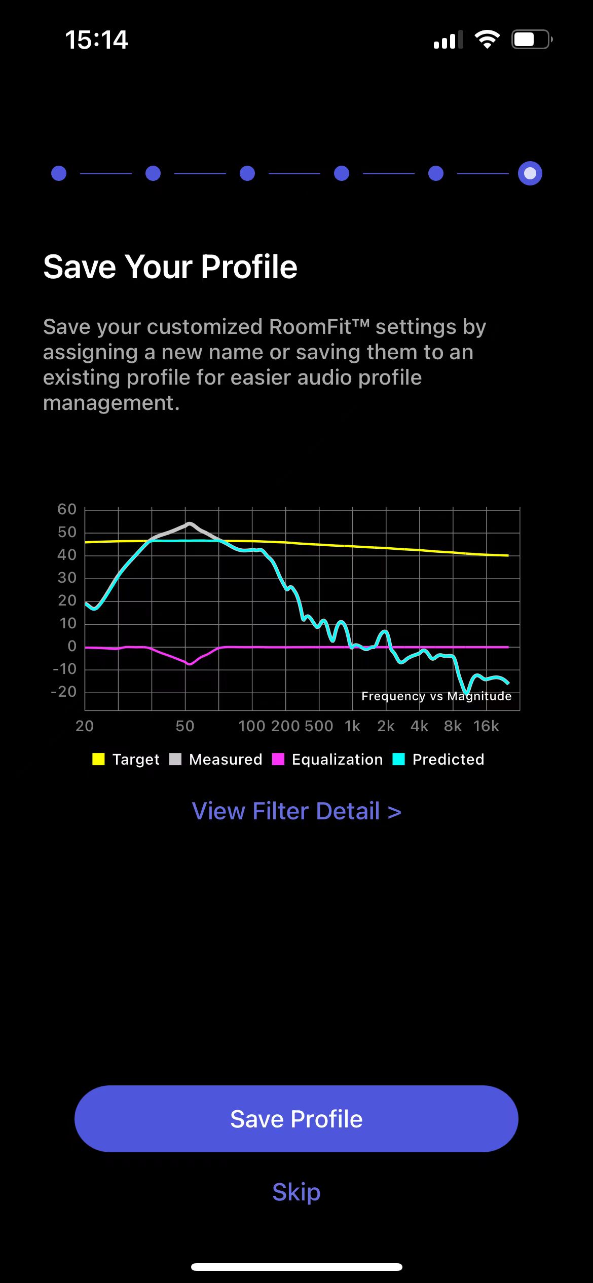

Alternatively, if you are not satisfied with the results, tap Adjust Again to run Room Correction again. - Tap Save Profile to save the Room Correction results. Alternatively, tapping Skip will save the results to a profile named "auto".
- Once the profile is saved, tap Done to complete.
Now, the Room Correction profile will be applied automatically.

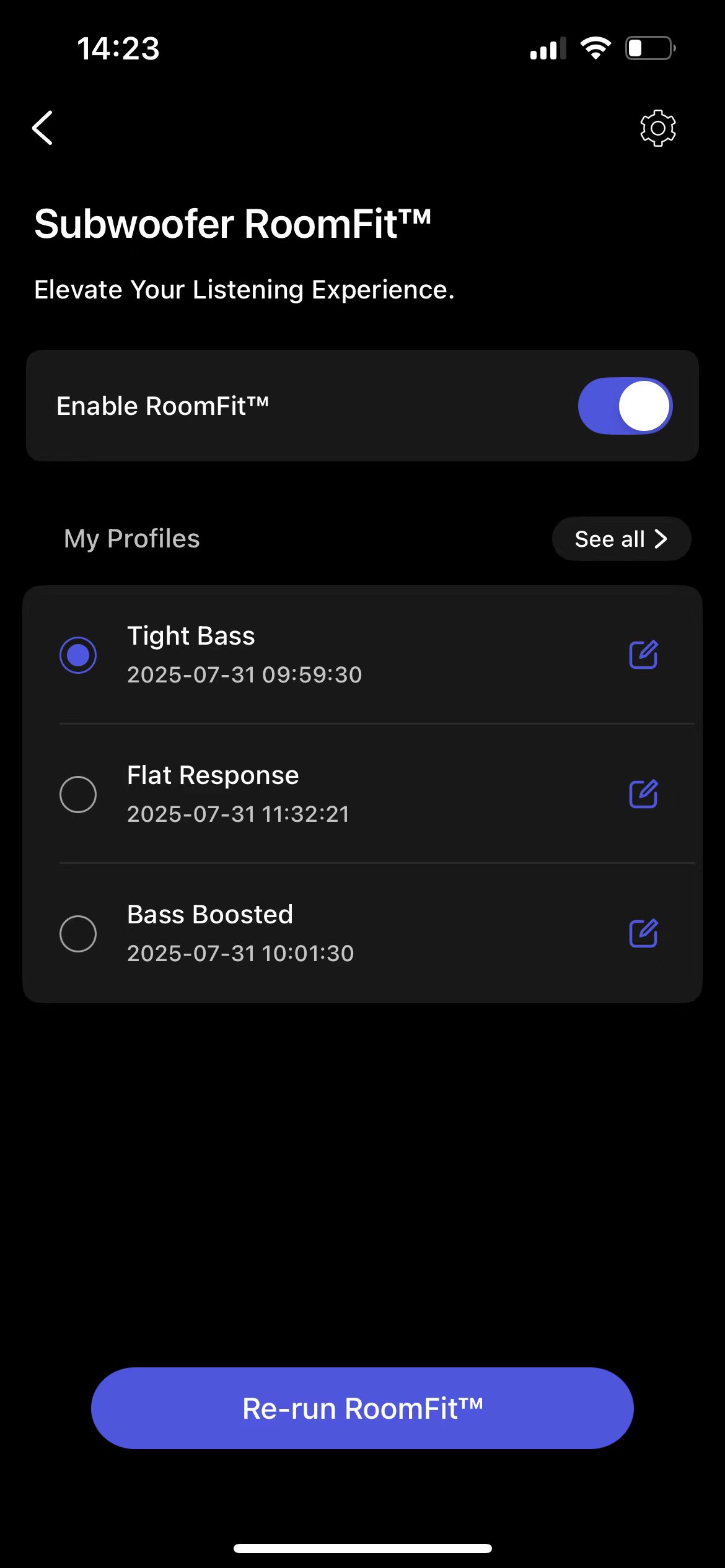

Manage and Adjust Room Correction Profiles
You can run Room Correction multiple times and save different profiles for various setups or preferences.
You can always go to Subwoofer RoomFit™ in the WiiM Home app to manage these profiles:
- Select and apply any saved profile based on your needs.

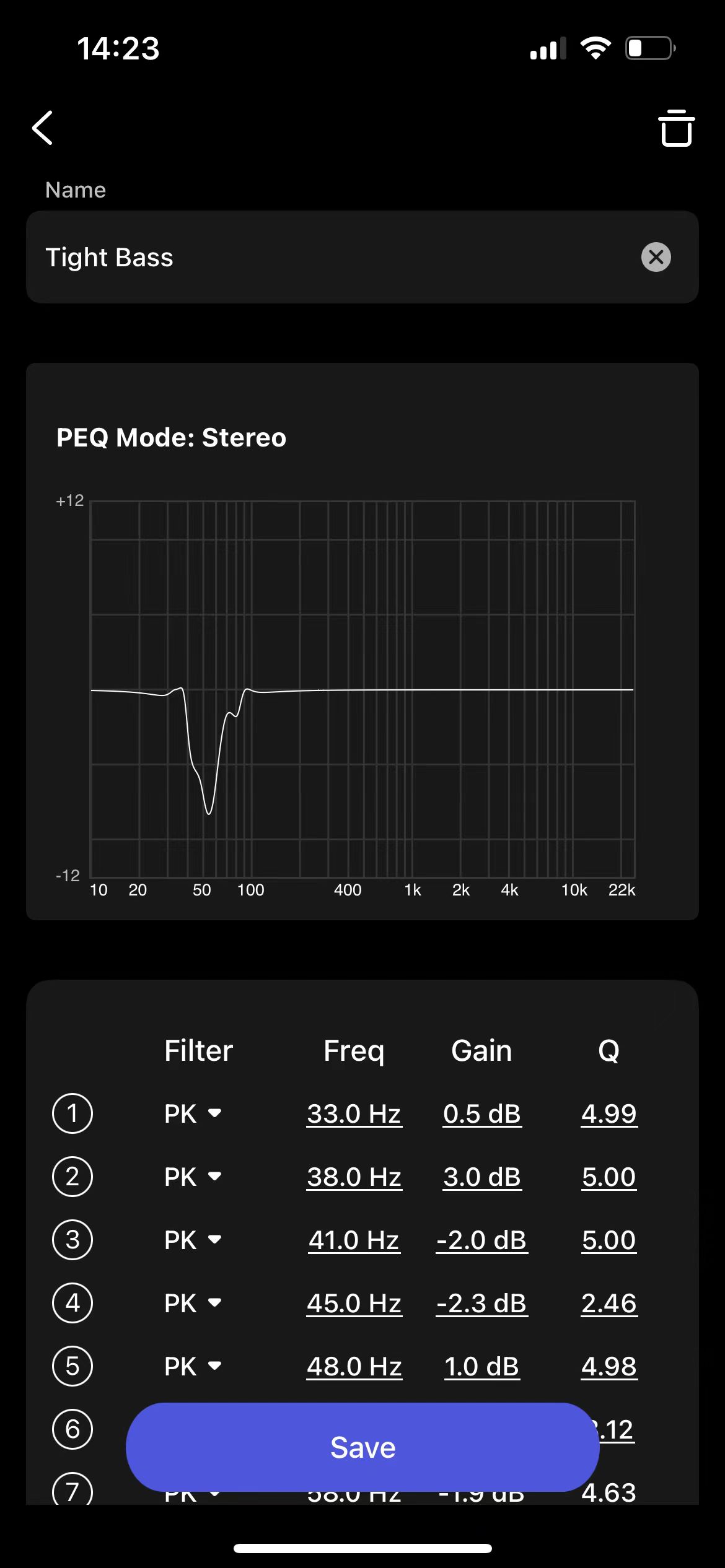

- Open a profile to view and manually adjust its parameter settings.
