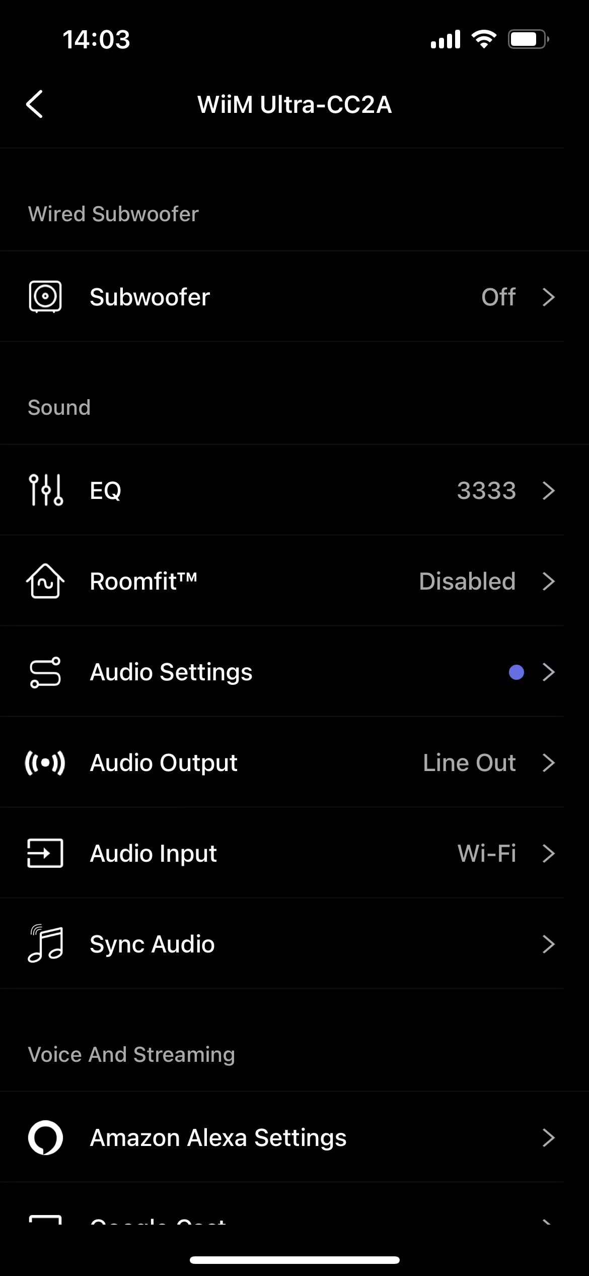

- Open the WiiM Home app.
- Go to the Devices tab and tap the Device Settings icon
of your WiiM device.

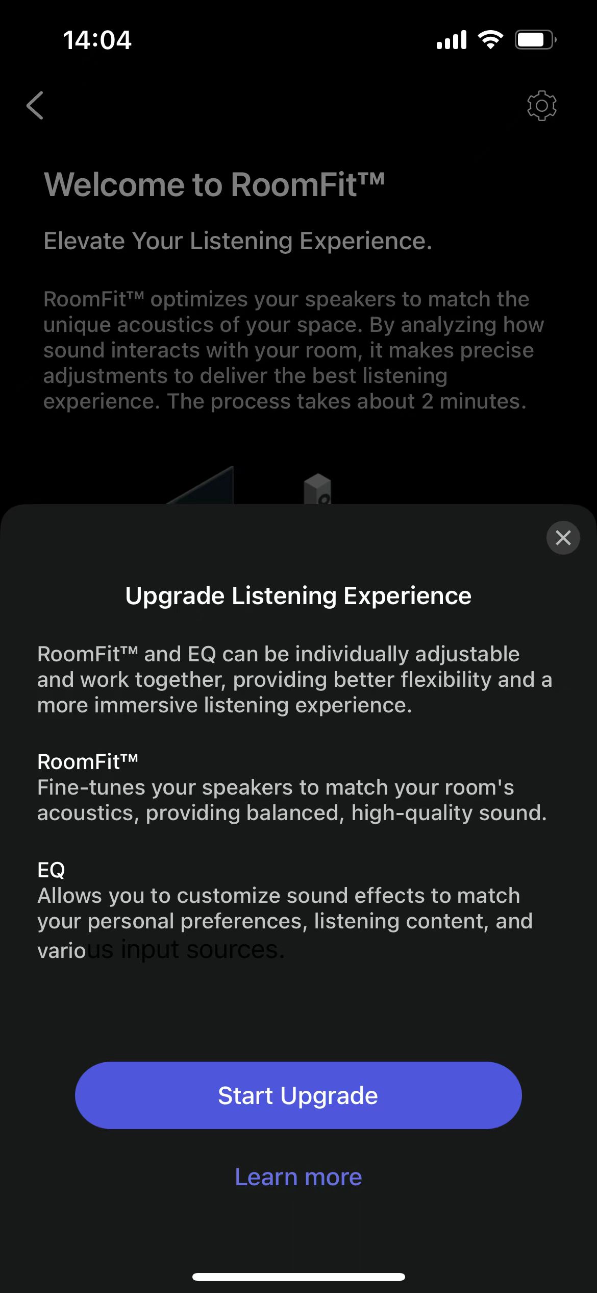

- Select EQ or RoomFit™. You will be prompted to upgrade your listening experience.
- Tap Start Upgrade to begin transferring your Room Correction profiles.

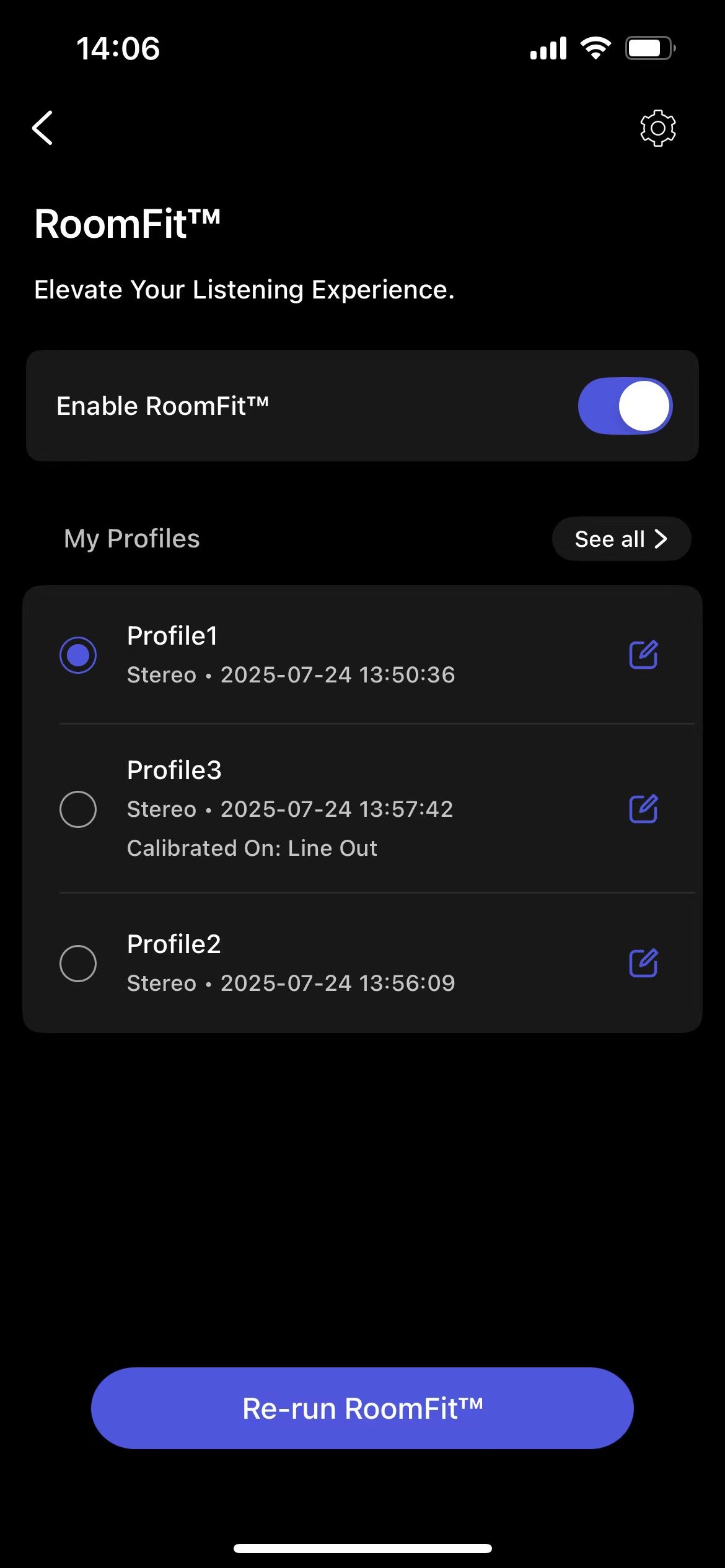

- Once the profiles are transferred, proceed with one of the following options:
- Option 1: Select an existing profile and complete the process.
- Option 2: Tap Re-Run RoomFit™ to perform Room Correction again. For detailed instructions, see Optimizing Your Audio Experience: A Comprehensive Guide to Room Correction.
Later, you can go to the Room Correction settings to manage your profiles.
